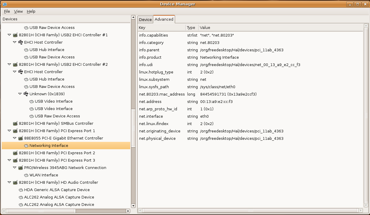

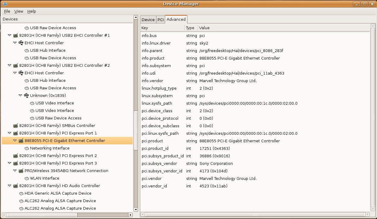

uk_rules_ok Posted January 31, 2008 Share Posted January 31, 2008 i tryed what you said but my device id is already listed in /System/Library/Extensions/IONetworkingFamily.kext/Contents/PlugIns/AppleYukon2.kext/Contents/Info.plist and my network adapter isnt detected, does anyone know how to fix this. Ive attached the 2 pictures of the info from linux device manager if it helps. Regards, uk_rules_ok Link to comment Share on other sites More sharing options...
uk_rules_ok Posted February 1, 2008 Share Posted February 1, 2008 anyone any idea, would like to get this working. Link to comment Share on other sites More sharing options...
