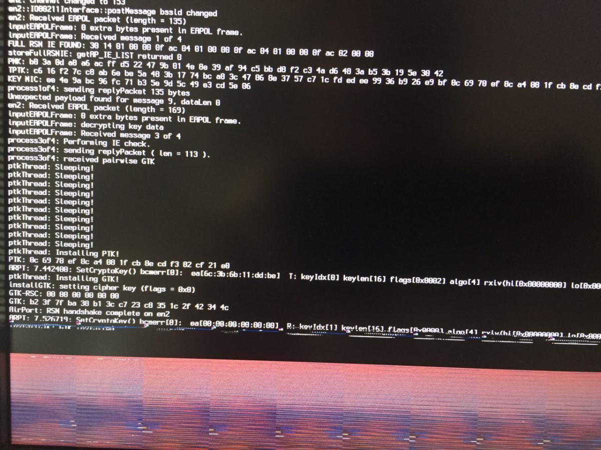

deseven Posted June 16, 2017 Share Posted June 16, 2017 Hello. I can't make HD 530 (AsRock Fatal1ty Z170 Gaming-ITX/ac + i7-6700) work with Lilu and IntelGraphicsFixup. I tried to put kexts in EFI and in /L/E, location doesn't really matter and i always see them in kextstat: 15 1 0xffffff7f80b93000 0x32000 0x32000 as.vit9696.Lilu (1.1.4) 8706F51C-8552-3987-A50C-721EE1DF34DA <7 5 4 3 2 1> 16 0 0xffffff7f80c1b000 0x4000 0x4000 as.lvs1974.IntelGraphicsFixup (1.1.4) 6C65812A-E4AF-308C-81A8-38913DE13318 <15 7 5 4 3 2 1> verbose mode screenshot clover config kextstat Am i missing something? Link to comment Share on other sites More sharing options...

deseven Posted June 16, 2017 Author Share Posted June 16, 2017 check CLOVER.zip Thanks! So i deleted FakeSMC.kext, USBInjectAll.kext, Lilu.kext and IntelGraphicsFixup.kext from /L/E since you've added them to EFI. And it sorta booted! Check it out: It's not just a static glitch, i was able to actually log in into system and send it to reboot. Looks like IntelGraphicsDVMTFixup.kext did its job. What's next? Link to comment Share on other sites More sharing options...
deseven Posted June 16, 2017 Author Share Posted June 16, 2017 Did some more experiments. Found out 2 things: 1. That IntelGraphicsDVMTFixup.kext actually does something, distorted and damaged picture appears in a lower part of the screen. 2. "Failed to initialize graphics firmware" is still here, it just isn't visible (i had to record a video to catch it, but it's here). Link to comment Share on other sites More sharing options...
deseven Posted June 17, 2017 Author Share Posted June 17, 2017 HD 530 is working right now, thanks to people from applelife.Final(?) config for clover is here. TLDR - used manual inject through Arbitrary with 0x193b0000 as platform-id, activated AddIMEI fix. 1 Link to comment Share on other sites More sharing options...
