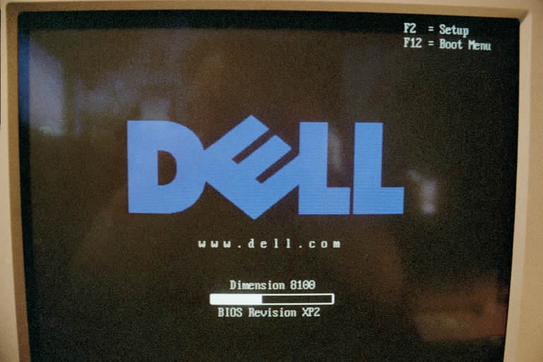

cbmkgd Posted November 2, 2006 Share Posted November 2, 2006 Well, when my computer starts, two commands shows up on the screen for a few seconds: F2= Setup menu F12= Boot menu , like screenshot below: (...) I got the following 3 options (your options may be different.): onboard SATA Hard Drive onboard IDE Hard Drive onboard or USB CD-ROM Drive (...) So now everytime I want to use OSX, I just press F12 on boot, choose "onboard IDE Hard Drive", and OSX happliy boots! the strange thing is, there was no sign of darwin bootloader, it booted right into OSX. But who cares, I have dual boot without using any bootloader! Bootloaders are always needed.In both cases above, bootloaders are used (ntldr for windows, darwin bootloader for osx), but are transparent. For Windows, probably because the "timeout" line is commented in the boot.ini. For osx, silent boot is on; pressing F8 really fast (and often) as you boot on your ide you might catch that darwin boot menu in time to reveal it (or edit the ...boot.plist file with non-nul timeout). This 'method' isn't really new, but is usefull when different os's are installed on separate drives; I think it was described somewhere in the old "official dual-boot thread". Another advantage of this procedure is to test a problematic os install on secondary drives by removing a possible source of conflict, which would be a third party bootmanager; check this link for example. Link to comment https://www.insanelymac.com/forum/topic/31846-how-to-simple-xp-osx-native-dual-boot/#findComment-222965 Share on other sites More sharing options...
