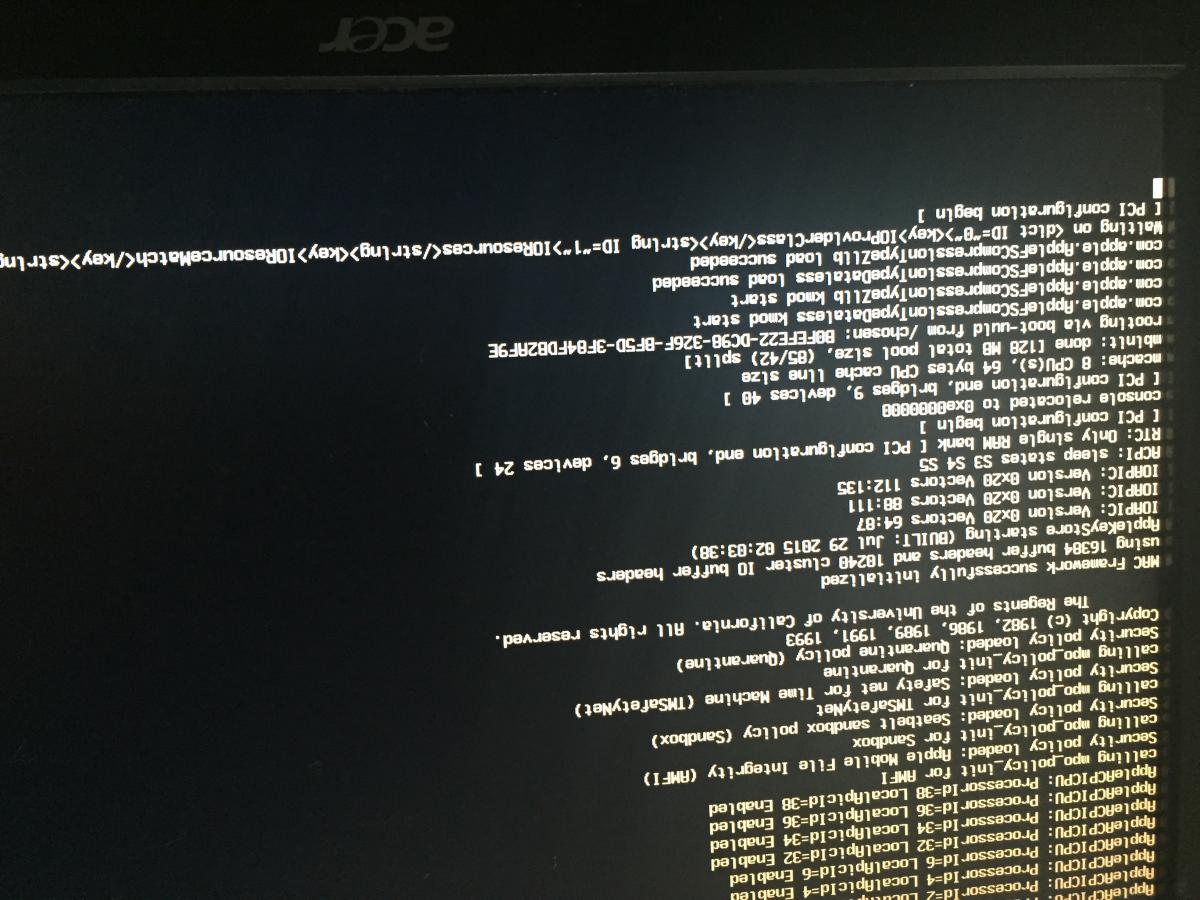

DonDonnelly Posted September 27, 2015 Share Posted September 27, 2015 For some reason with my limited experience I've decided to take on a high performance build. SuperMicro DRG10, dual e5v3 2697, 128GB DDR4 ECC, 1x GTX 960, 3x GTX980ti. With both Clover and [url="http://www.insanelymac.com/forum/topic/279450-why-insanelymac-does-not-support-tonymacx86/"]#####[/url], I'm stalling out at [PCI Configuration Begin] loading 10.10 installer. This flag shows up a few times in the boot process, the last one happens just after recognizing the LAN ports.So far I've tried:-Clover/Chimera-Almost Every Boot Arg ("-v npci=0x2000 cpus=1 kext-dev-mode=1 PCIRootUID=1" has gotten me the farthest yet)-Nvidia GTX960/GTX980Ti/Embedded -Disabled onboard LAN -Disabled unused PCIe slots I'm reasonably sure I have the BIOS configured correctly (hyperthreading/virtualization/CSM off, AHCI on, etc.) however I haven't found a reference for BIOS settings for this board (honestly not too surprising though). I knew going in this would be a challenging one, any assistance is greatly appreciated. Link to comment Share on other sites More sharing options...

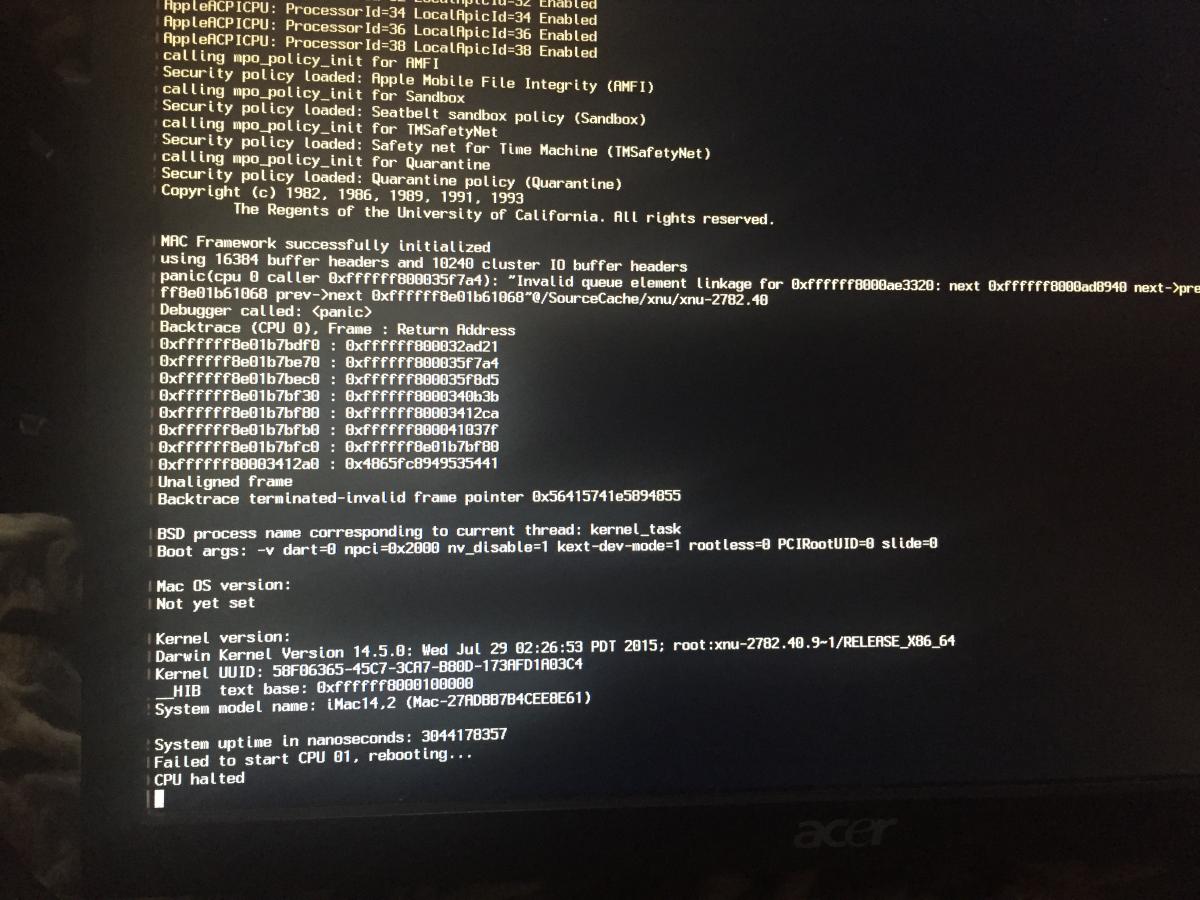

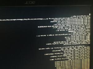

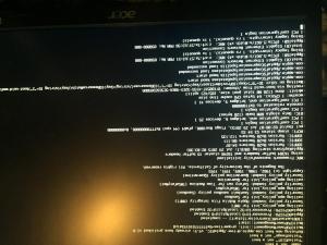

DonDonnelly Posted September 29, 2015 Author Share Posted September 29, 2015 Hey Chris, I've successfully made the installer, and discovered that the black screen was from needing to physically disable the onboard GFX with a jumper to get to the clover bootloader. Currently getting a variety of kernel panics, which seem to be created/resolved by BIOS settings. The latest is "Invalid Queue Element Linkage". Screenshot attached. *Update: I found another option that was enabled incorrectly in the BIOS. After disabling I no longer get Kernel panics, but I do get the dreaded [PCI Configuration Begin]. Screenshot added below. Link to comment Share on other sites More sharing options...

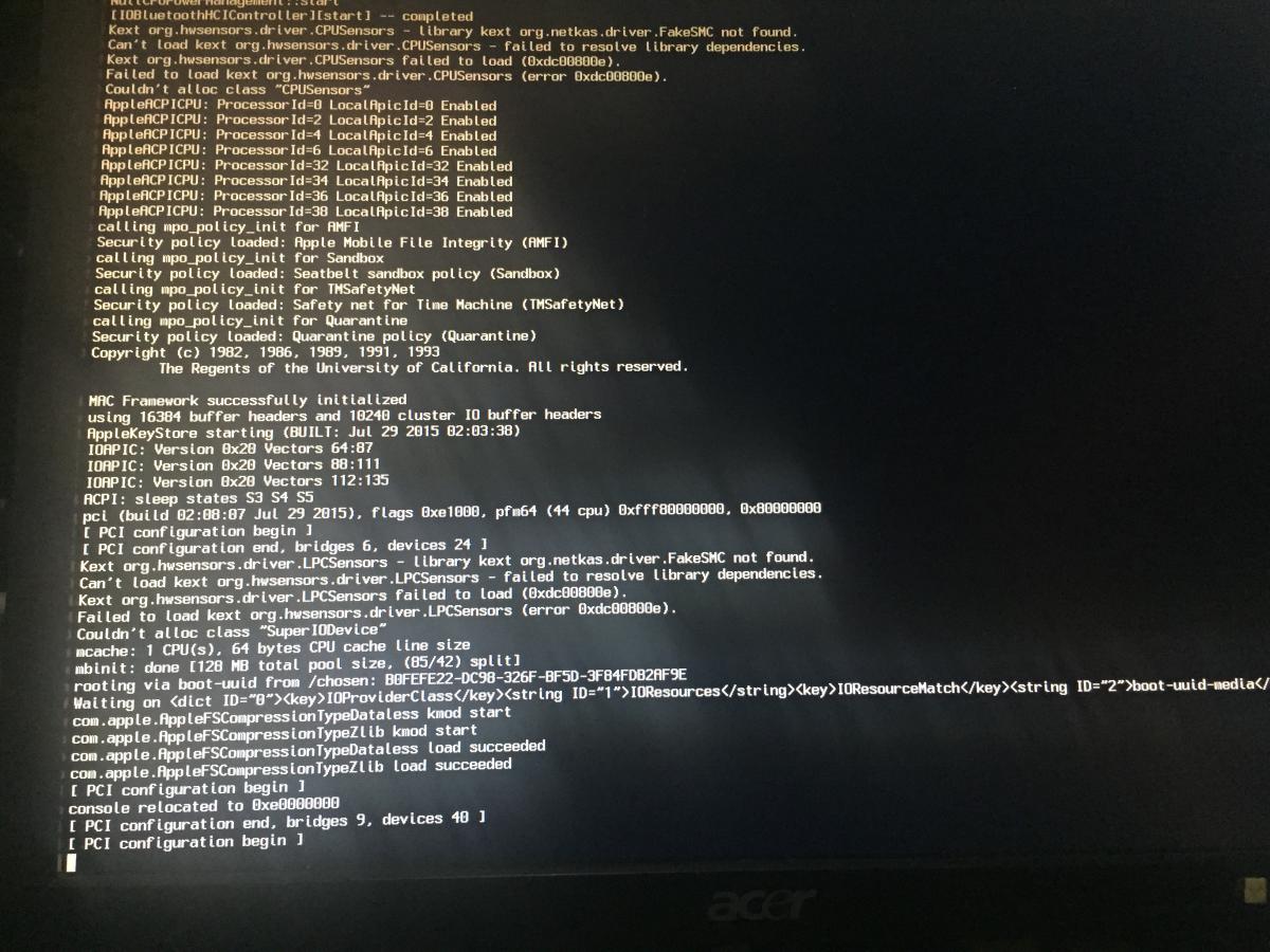

chris1111 Posted September 29, 2015 Share Posted September 29, 2015 Hey Chris, I've successfully made the installer, and discovered that the black screen was from needing to physically disable the onboard GFX with a jumper to get to the clover bootloader. Currently getting a variety of kernel panics, which seem to be created/resolved by BIOS settings. The latest is "Invalid Queue Element Linkage". Screenshot attached. *Update: I found another option that was enabled incorrectly in the BIOS. After disabling I no longer get Kernel panics, but I do get the dreaded [PCI Configuration Begin]. Screenshot added below. Secound pitture thats not the FakeSMC.kext Inside Efi Installer because I not put any plugin HWSensor Link to comment Share on other sites More sharing options...
DonDonnelly Posted September 29, 2015 Author Share Posted September 29, 2015 My mistake, should be this one. Side note- it does trigger a hard reset as opposed to just hanging, if that means anything. Link to comment Share on other sites More sharing options...

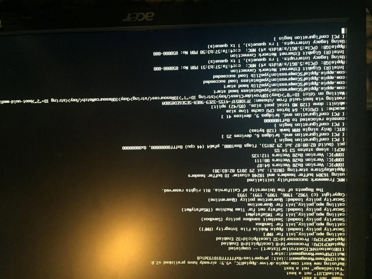

DonDonnelly Posted October 12, 2015 Author Share Posted October 12, 2015 Hi Jamie, I've rolled back those kexts to a 10.9.5 version I have from another machine and rebuilt caches, no change. UPDATE: After reinstalling the rollback kexts and clearing caches/fixing permissions a couple times I now get to FakeSMC: [Fatal] failed to initialize SMC Device. I've found a few articles from other forums on fixes, none of which help/seem to be legitimate solutions. Any ideas? Eventually found a link to FakeSMC 6.18 which now loads correctly, still stuck on Bluetooth Controller Missing though. I've swapped out to the following GFX cards, with all possible boot flags. Gtx960 Gtx980ti Quadro 4000 Mac I've also attempted setting up a vanilla install via another machine, installing clover, and nvidia web drivers. Same result. Link to comment Share on other sites More sharing options...
