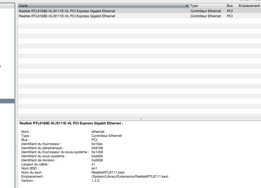

And new infos (attached picture) in system profiler (need to edit my DSDT for built-in tough)
Basically my chip is RTL8111/8168B ; it seems to be recognized by the driver as a different one ? No incidence i guess ?
Thanks RehabMan :)
No it isn't, it is a RTL8111E-VL as recognized by the driver.
