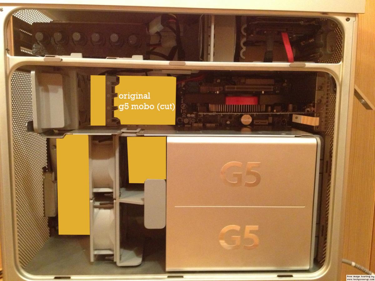

Ira Aduro Posted March 4, 2013 Share Posted March 4, 2013 I love that you are making the insides look close to stock, reusing a lot of the original parts. Thought, what if you cut down the original G5 motherboard so that it fit next to your PC motherboard, attached to the standoffs, hiding the cables? You might have to make a small kind of "bridge" that covers the seam between the two motherboards, something dark so it blends in. That would complete the new stock look. Where the front fans used to plug in you could cut out a small area from the G5's motherboard and have the new plug sticking out. Link to comment https://www.insanelymac.com/forum/topic/286762-worklog-the-powermac-g5-talulah-project/#findComment-1893935 Share on other sites More sharing options...
SirKeldon Posted March 4, 2013 Author Share Posted March 4, 2013 I love that you are making the insides look close to stock, reusing a lot of the original parts. Thought, what if you cut down the original G5 motherboard so that it fit next to your PC motherboard, attached to the standoffs, hiding the cables? You might have to make a small kind of "bridge" that covers the seam between the two motherboards, something dark so it blends in. That would complete the new stock look. Where the front fans used to plug in you could cut out a small area from the G5's motherboard and have the new plug sticking out. Thanks for your words and tip, in fact i still didn't throw any of the original internals so i could cut the parts you say to hide more cables (WhatTheTech can tell you how obsessive i am with cable management, even the pictures you're seeing, being a PoC, i tried to manage all the wires i could in a smart way, did my best since the hole under the motherboard is less than 1cm but can be improved on next revisions) Though that, being honest i wanted to make it more functional (that's why i said LCD temp monitors or some other internal nice stuff) as well as stylish, but i'll give it a try in Photoshop and see how it looks. Only part that i won't apply any styling is the CPU fan mounting, as i say in the first post, i rewired the original plug, not the fans itself in that one so they're truly deattachable and that part is not really visible since it's covered with plastic too. Thanks again! Link to comment https://www.insanelymac.com/forum/topic/286762-worklog-the-powermac-g5-talulah-project/#findComment-1893937 Share on other sites More sharing options...
