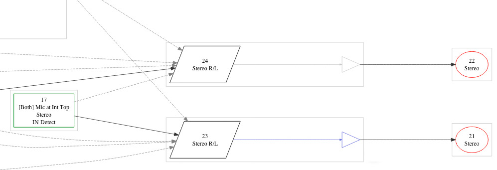

22 => 24 => 17, or
21 => 23 => 17
the mic works on both paths. Any logic behind that?

I think
22
24
17
but try both, I had to do so, to remove the doubts.
Your codec is very similar to mine, so I think you can edit my files, changing the codec id in layout12.xlm, and Nodes where different in Platforms.xlm.
Obviously also change the pinconfig in info.plist.... and again the codec id.
Micky

I think
22
24
17
No difference, just the values. (22=>24=>17 or 21=>24=>17)
