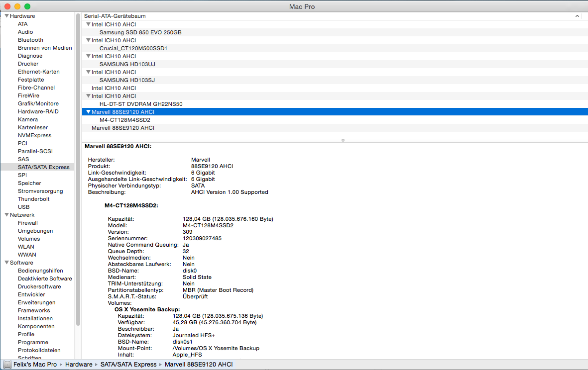

Multisaft Posted January 15, 2016 Share Posted January 15, 2016 The Asus U3S6 is a PCIe 4x card with Marvell 88SE9120 AHCI SATAIII + NEC uPD720200 USB 3.0 interconnected via a PLX PCIe switch. Happy hack ! I know, its old, but Toine44 did you ever managed to boot with clover form your ASUS U3S6 Card? I'm able to see the Marvell AHCI Controller from my Yosemite Clover Installation connected to my ICH10, but I'm not able to legacy boot from my Cruzial M4 SSD connected to the Asus U3S6 Card. Link to comment Share on other sites More sharing options...
