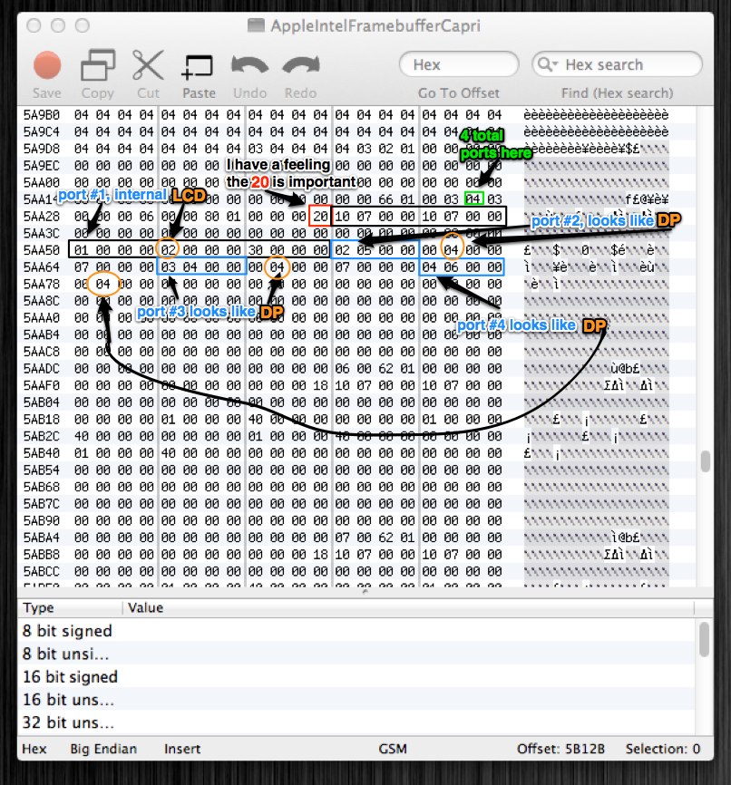

Okay, I've made some progress on this!
The edit you made affected id0. By comparing your file and the original, and looking at the surround hex, I'm now able to change the connector types on each platform.
I chose id4 for now as it had a single output.
I changed the connector type from 02 00 00 00 LVDS to 00 04 00 00 Displayport
But my display still wasn't detected.
I then looked at all the Id and connector types where my display was detected previously, it seems the 04 06 hex before the connector type is where it gets detected. I change that line to 04 06 and the screen now gets detected and goes blank as before.
So at least now I'm In some kind of control ;)
It's late now nearly 2am so I'm going to out it down,
I need to learn what these other values actually represent.

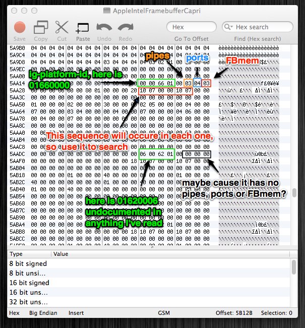

I wanted to share what I found so far in the Capri, and just get some of it written down for my own notes too, so I'm kinda editing this post as I go with any observations. 12 total ig-platform-id's but 2 of them have no pipes, ports or FBmem, haven't even looked at them all yet, but those 2 that can be seen here are 01620006 and 01620007, maybe they are for future versions that don't exist yet. After that the are all the familiar ones. The 10 07 00 00 10 07 00 00 that is present in each instance has a 20 before it on all but the two blank ones 01620006 and 01620007 which have an 18 there instead along with 01660004, so looks like 18 is desktop and 20 is laptop?. More decoding to be done.
rr7--01660004 only has the one connector 05 03 so I don't think changing that connector to 04 06 is the way to go, but instead edit and use one of the id's that already has that connector? id's 0a and 0b both have 04 06 already, but with connector type 08, maybe try changing one of these to 04 and using them? I'm sure all the other stuff factors into that somehow, just not sure how quite yet.
After a little more looking, 010000000 2000000 3000000 appears to be internal lcd display at port 1, not present in every id, then right after this will be 02050000 for port 2, except for on id#2 because it only has 1 port, so has zeros here instead. or like with ID#4 which also only has one port which is an internal lcd not located at port #1, but it's located at port #5 so it's internal lcd is 050300000 2000000 30020000. I've seen some where internal LCD is either at port# 01 or 05, but it is always the first port listed while the rest appear in numerical order. Since the most ports any id's have is 4, it may have either port 1 or port 5, but not both and these will always be internal lcd. So for laptop users, this is the key to get internal display working and should not be edited for external displays. id4 is interesting as it's the only one with ports (1 total) that has an 18 as noted above, but then also it's only connector which is at port 5, is an lcd. so a bit of an odd ball, I don't see how this would be for desktops and wonder if the 18 may be used to disable the id and 20 makes it usable by the OS?
I guess that's about all I can do until I win a free Ivy Bridge :(
note: The above is only from observation only and no testing, so take nothing I say as proven fact, but merely conjecture and thinking out loud in hopes that it may possibly prove to be useful. More heads are better than one!

So based on what I'm seeing, which I should again mention may be totally wrong, I added the internal LCD info to the list above.
it looks likek the intel frame buffer isnt bothered about the adaptor type,i can change it to whatever and it still gets detected when i use 04 06 in the bytes before it.
here is a copy of my notes, in case anyone finds it useful. i still dontt yet know what these numbers mean. but im now starting to think it may justt be a screen mode issue again for me :\
AAPL,ig-platform-id: 01660000, Stolen RAM for FB: 96MB, Pipes: 3, Ports: 4, FBMem: 3
@0, 01 00 00 00 02 00 00 00 03 00 00 00 // (LVDS)
@1, 02 05 00 00 00 04 00 00 07 00 00 00 // (DisplayPort)
@2, 03 04 00 00 00 04 00 00 07 00 00 00 // (DisplayPort)
@3, 04 06 00 00 00 04 00 00 07 00 00 00 // (DisplayPort)- DETECTED 0x0
AAPL,ig-platform-id: 01660001, Stolen RAM for FB: 96MB, Pipes: 3, Ports: 4, FBMem: 3
@0, 01 00 00 00 02 00 00 00 30 00 00 00 // (LVDS)
@1, 02 05 00 00 00 08 00 00 06 00 00 00 // (HDMI)
@2, 03 04 00 00 00 04 00 00 07 01 00 00 // (DisplayPort)
@3, 04 06 00 00 00 04 00 00 07 01 00 00 // (DisplayPort)- DETECTED 0x0
port-number 0x7
AAPL,ig-platform-id: 01660002, Stolen RAM for FB: 64MB, Pipes: 3, Ports: 1, FBMem: 1
@0, 01 00 00 00 00 02 00 00  30 00 00 00 // (LVDS)
port number 0x0
AAPL,ig-platform-id: 01660003, Stolen RAM for FB: 64MB, Pipes: 2, Ports: 4, FBMem: 2
@0, 05 03 00 00 02 00 00 00 30 00 00 00 // (LVDS)
@1, 02 05 00 00 00 04 00 00 07 04 00 00 // (DisplayPort)
@2, 03 04 00 00 00 04 00 00 81 00 00 00 // (DisplayPort)
@3, 04 06 00 00 00 04 00 00 81 00 00 00 // (DisplayPort) - DETECTED 0x0 desktop
AAPL,ig-platform-id: 01660004, Stolen RAM for FB: 32MB, Pipes: 3, Ports: 1, FBMem: 1
@0, 05 03 00 00 02 00 00 00 30 02 00 00 // (LVDS)
AAPL,ig-platform-id: 01620005, Stolen RAM for FB: 32MB, Pipes: 2, Ports: 3, FBMem: 2 512mb vram
@0, 02 05 00 00 00 04 00 00 11 00 00 00 // (DisplayPort)
@1, 03 04 00 00 00 04 00 00 07 01 00 00 // (DisplayPort)
@2, 04 06 00 00 00 04 00 00 07 01 00 00 // (DisplayPort) - DETECTED
AAPL,ig-platform-id: 01620006, Stolen RAM for FB: 0MB, Pipes: 0, Ports: 0, FBMem: 0
AAPL,ig-platform-id: 01620007, Stolen RAM for FB: 0MB, Pipes: 0, Ports: 0, FBMem: 0
AAPL,ig-platform-id: 01660008, Stolen RAM for FB: 64MB, Pipes: 3, Ports: 3, FBMem: 3
@1, 02 05 00 00 00 04 00 00 07 01 00 00 // (DisplayPort)
AAPL,ig-platform-id: 01660009, Stolen RAM for FB: 64MB, Pipes: 3, Ports: 3, FBMem: 3 - 0mb VRAM
AAPL,ig-platform-id: 0166000A, Stolen RAM for FB: 32MB, Pipes: 2, Ports: 3, FBMem: 2
@0, 02 05 00 00 00 04 00 00 07 01 00 00 // (DisplayPort)
@2, 04 06 00 00 00 08 00 00 06 00 00 00 // (HDMI) - DETECTED
AAPL,ig-platform-id: 0166000B, Stolen RAM for FB: 32MB, Pipes: 2, Ports: 3, FBMem: 2
