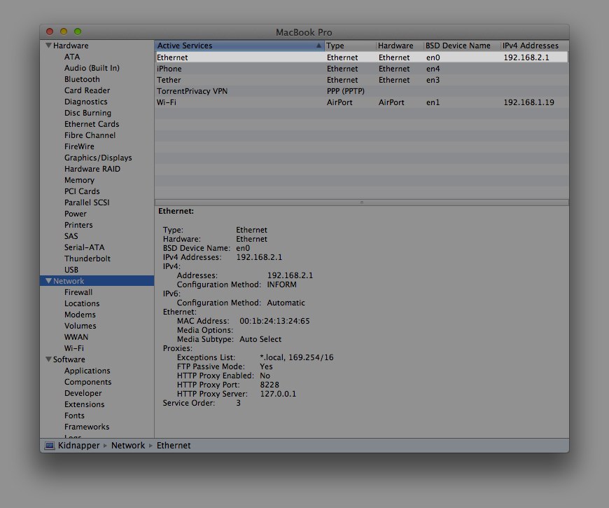

I believe Ethernet BSD Device Name needs to be set to en0 in order for FaceTime, iCloud, App Store, etc to work. Mine was set to en1 and my Wi-Fi was set to en0, so I had to uninstall kexts for Ethernet and Wi-Fi, reboot, then install Ethernet first, reboot, and then install Wi-Fi in order to set them to the correct order. You can check in System Information how your system is currently configured.
I am using MacBookPro5,5 smbios btw.

Thank you for answer, yellow!
I have it correctly set, and the AppStore and the iTunes store both work very well for me. But iCloud and FaceTime, no success at all.
