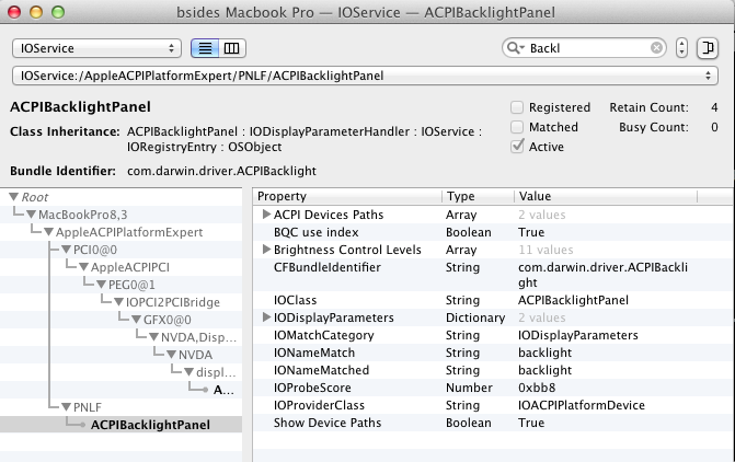

I have that in kernel.log
11-10-13 18:25:02,000 kernel: ACPIBacklightPanel: Found Backlight Device: DD02
11-10-13 18:25:02,000 kernel: ACPIBacklightPanel: ACPI Method _DOS found. Device path: _SB.PCI0.GFX0
11-10-13 18:25:02,000 kernel: ACPIBacklightPanel: ACPI Methods _BCL _BCM _BQC found. Device path: _SB.PCI0.GFX0.DD02
11-10-13 18:25:02,000 kernel: ACPIBacklightPanel: Version 1.1

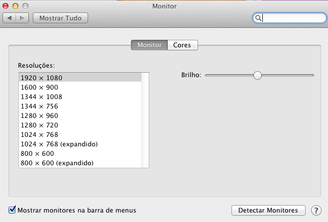

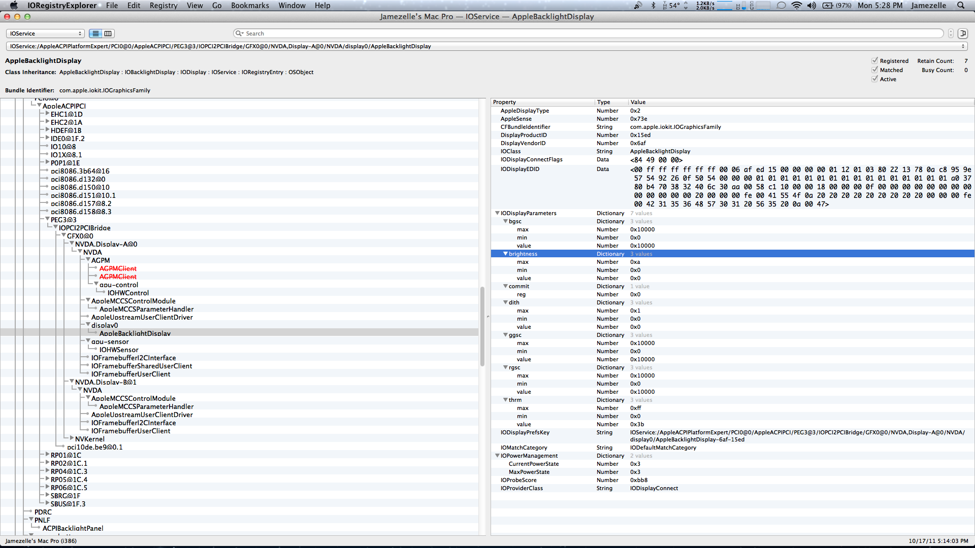

Thanks for the idea! The values were pointing to the wrong device(\_SB.PEG1.GFX0.LCDD instead of the correct one which is \_SB.PEG3.GFX0.LCDD), and I just fixed the paths by setting the path to the methods of my LCD in the PNLF Device, but the slider is still not changing the brightness.
I can change the brightness before it enters the system and when i do it reports the value i change it to (max is 0xa, when I turned the brightness down, but not all the way and it reported 0x3) So like you said it sems to be reporting indexes of the brightness levels instead of the actual levels.
Could that be a problem? Is there a way I could try to have _BCM set values of 0x0 through 0xa ? maybe from the terminal?
Attached File  Screen_Shot_2011_10_17_at_5.20.35_PM.png   328.82KB   82 downloads
Attached File  Screen_Shot_2011_10_17_at_5.28.19_PM.png   391.27KB   71 downloads
Kernel Log:
Oct 17 17:13:12 localhost kernel[0]: ACPIBacklightPanel::probe()Oct 17 17:13:12 localhost kernel[0]: ACPIBacklightPanel::findDevices()Oct 17 17:13:12 localhost kernel[0]: ACPIBacklightPanel::hasBacklightMethods()Oct 17 17:13:12 localhost kernel[0]: ACPIBacklightPanel: ACPI device PNLF has _BCLOct 17 17:13:12 localhost kernel[0]: ACPIBacklightPanel: ACPI device PNLF has _BCMOct 17 17:13:12 localhost kernel[0]: ACPIBacklightPanel: ACPI device PNLF has _BQCOct 17 17:13:12 localhost kernel[0]: ACPIBacklightPanel: PNLF has backlight MethodsOct 17 17:13:12 localhost kernel[0]: ACPIBacklightPanel: ACPI Methods _DOS _BCL _BCM _BQC found. Device path: _SB.PNLFOct 17 17:13:12 localhost kernel[0]: ACPIBacklightPanel: probe(devices found : true)Oct 17 17:13:12 localhost kernel[0]: ACPIBacklightPanel: PNLF has backlight MethodsOct 17 17:13:12 localhost kernel[0]: ACPIBacklightPanel::start()Oct 17 17:13:12 localhost kernel[0]: ACPIBacklightPanel::findDevices()Oct 17 17:13:12 localhost kernel[0]: ACPIBacklightPanel::getDeviceControl()Oct 17 17:13:12 localhost kernel[0]: ACPIBacklightPanel: BIOS control disabled: _DOSOct 17 17:13:12 localhost kernel[0]: ACPIBacklightPanel::setupIndexedLevels()Oct 17 17:13:12 localhost kernel[0]: ACPIBacklightPanel::queryACPISupportedBrightnessLevels()Oct 17 17:13:12 localhost kernel[0]: ACPIBacklightPanel: PNLF _BCL 13Oct 17 17:13:12 localhost kernel[0]: ACPIBacklightPanel: getIndexForLevel(36) is 3Oct 17 17:13:12 localhost kernel[0]: ACPIBacklightPanel: getIndexForLevel(72) is 7Oct 17 17:13:12 localhost kernel[0]: ACPIBacklightPanel::queryACPICurentBrightnessLevel()Oct 17 17:13:12 localhost kernel[0]: ACPIBacklightPanel: queryACPICurentBrightnessLevel _BQC = 8Oct 17 17:13:12 localhost kernel[0]: ACPIBacklightPanel: getIndexForLevel(8) not found !Oct 17 17:13:12 localhost kernel[0]: ACPIBacklightPanel: getBatteryDevice() matching not nullOct 17 17:13:12 localhost kernel[0]: ACPIBacklightPanel: min = 0, max = 10, value = 3Oct 17 17:13:12 localhost kernel[0]: ACPIBacklightPanel: Version 1.1Oct 17 17:13:37 Jamezelles-Mac-Pro kernel[0]: ACPIBacklightPanel::setDisplay()Oct 17 17:13:37 Jamezelles-Mac-Pro kernel[0]: ACPIBacklightPanel::doUpdate()Oct 17 17:13:37 Jamezelles-Mac-Pro kernel[0]: ACPIBacklightPanel: ACPILevel min 0, max 10, value 3Oct 17 17:13:37 Jamezelles-Mac-Pro kernel[0]: ACPIBacklightPanel::doUpdate()Oct 17 17:13:37 Jamezelles-Mac-Pro kernel[0]: ACPIBacklightPanel: ACPILevel min 0, max 10, value 3Oct 17 17:13:37 Jamezelles-Mac-Pro kernel[0]: ACPIBacklightPanel::doIntegerSet(brightness)Oct 17 17:13:37 Jamezelles-Mac-Pro kernel[0]: ACPIBacklightPanel::setACPIBrightnessLevel()Oct 17 17:13:37 Jamezelles-Mac-Pro kernel[0]: ACPIBacklightPanel: setACPIBrightnessLevel _BCM(36)Oct 17 17:13:37 Jamezelles-Mac-Pro kernel[0]: ACPIBacklightPanel::doIntegerSet(brightness)Oct 17 17:13:37 Jamezelles-Mac-Pro kernel[0]: ACPIBacklightPanel::setACPIBrightnessLevel()Oct 17 17:13:37 Jamezelles-Mac-Pro kernel[0]: ACPIBacklightPanel: setACPIBrightnessLevel _BCM(36)Oct 17 17:13:38 Jamezelles-Mac-Pro kernel[0]: ACPIBacklightPanel::doUpdate()Oct 17 17:13:38 Jamezelles-Mac-Pro kernel[0]: ACPIBacklightPanel: ACPILevel min 0, max 10, value 3Oct 17 17:13:38 Jamezelles-Mac-Pro kernel[0]: ACPIBacklightPanel::doIntegerSet(brightness)Oct 17 17:13:38 Jamezelles-Mac-Pro kernel[0]: ACPIBacklightPanel::setACPIBrightnessLevel()Oct 17 17:13:38 Jamezelles-Mac-Pro kernel[0]: ACPIBacklightPanel: setACPIBrightnessLevel _BCM(36)
Any more ideas? Thanks for all your help. ;)

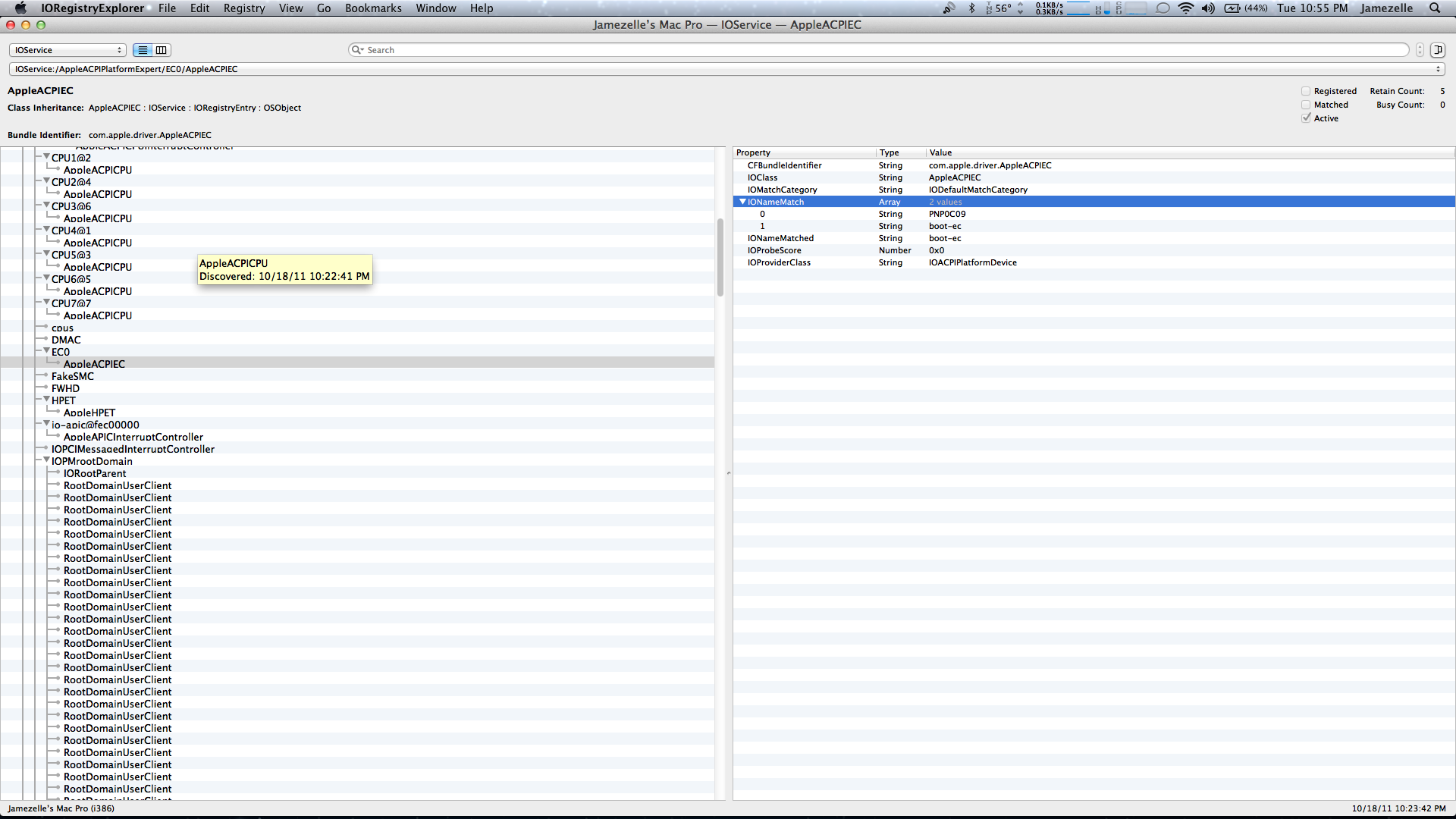

jamezelle
jamezelle
    InsanelyMac Protégé
  • Members
  • Pip
  • 27 posts
for BQC change
Method (_BQC, 0, NotSerialized)
DBGR ("\n_BQC: ")
DBGR (LBTN)
Return (LBTN)
to
Store (LBTN, Local0)
Store (BRTI, Local1)
ShiftLeft (Local1, 0x04, Local1)
Add (Local0, Local1, Local1)
Store (DerefOf (Index (PWAC, Local1)), Local0)
Return (Local0)
and verify than your embedded controller EC0 has the driver loaded

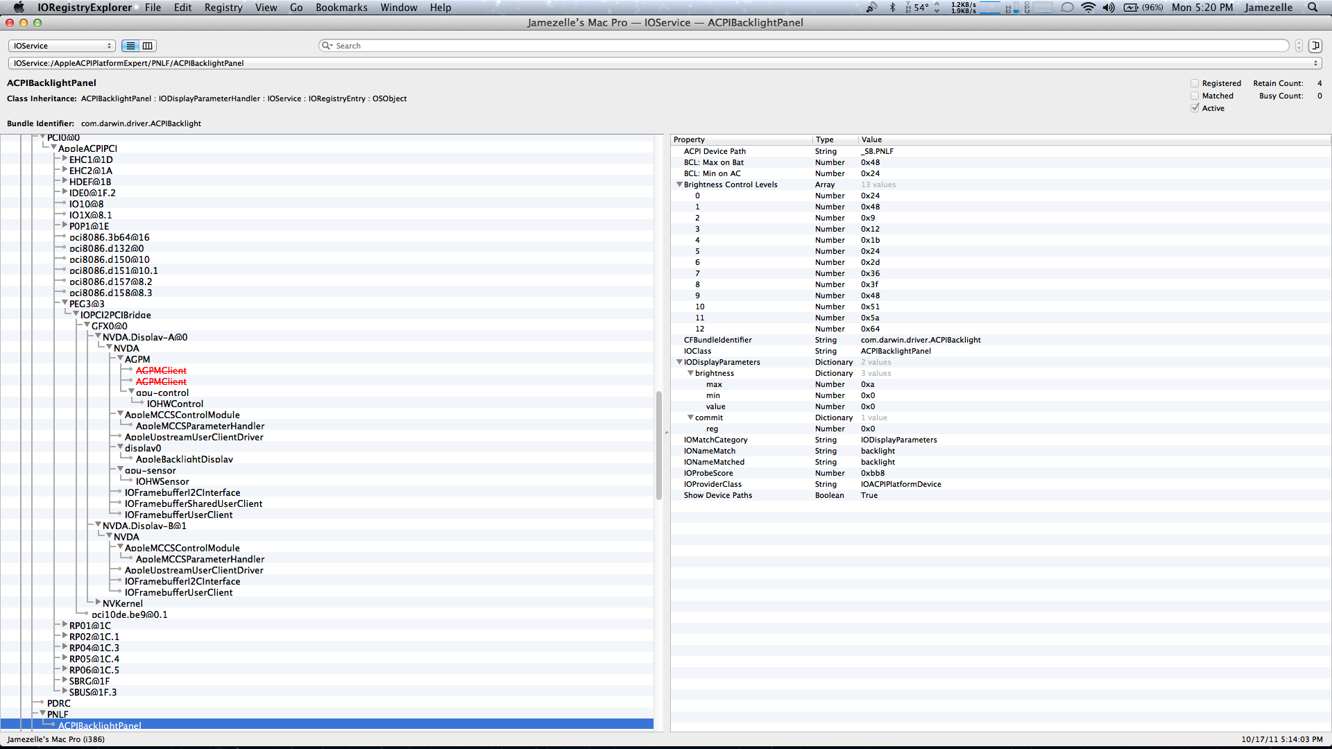

Ok, getting closer I think. now its reporting the correct brighness in ioreg when I move the slider but the brightness does not actually change on the screen, I suspect its not going to work :blink:. Maybe BCM isnt commiting the values correctly or perhaps the Nvidia driver is blocking it maybe?
EC0 Device is loaded in ioreg
Attached File  Screen_Shot_2011_10_18_at_10.55.22_PM.png   285.12KB   41 downloads
Current DSDT:
Attached File  dsdt.dsl.zip   47.7KB   16 downloads
For quick reference here are my brightness methods:
Method (_BCL, 0, NotSerialized)                        {                            DBGR ("\n_BCL: ")                            Return (PCTG)                            }                        Name (BCBH, Zero)                        Method (_BCM, 1, NotSerialized)                        {                            DBGR ("\n_BCM: ")                            DBGR (Arg0)                            Store (GCBL (Arg0), Local0)                            Subtract (0x0A, Local0, LBTN)                            DBGR ("\n  LBTN = ")                            DBGR (LBTN)                            ^^^^SBRG.EC0.STBR ()                        }                        Method (_BQC, 0, NotSerialized)                        {                            Store (LBTN, Local0)                            Store (BRTI, Local1)                            ShiftLeft (Local1, 0x04, Local1)                            Add (Local0, Local1, Local1)                            Store (DerefOf (Index (^^^^SBRG.EC0.PWAC, Local1)), Local0)                            Return (Local0)                        }
Kernel Log (grep ACPiBack)
Oct 18 22:59:47 localhost kernel[0]: ACPIBacklightPanel::probe()Oct 18 22:59:47 localhost kernel[0]: ACPIBacklightPanel::findDevices()Oct 18 22:59:47 localhost kernel[0]: ACPIBacklightPanel::hasBacklightMethods()Oct 18 22:59:47 localhost kernel[0]: ACPIBacklightPanel: ACPI device PNLF has _BCLOct 18 22:59:47 localhost kernel[0]: ACPIBacklightPanel: ACPI device PNLF has _BCMOct 18 22:59:47 localhost kernel[0]: ACPIBacklightPanel: ACPI device PNLF has _BQCOct 18 22:59:47 localhost kernel[0]: ACPIBacklightPanel: PNLF has backlight MethodsOct 18 22:59:47 localhost kernel[0]: ACPIBacklightPanel: ACPI Methods _DOS _BCL _BCM _BQC found. Device path: _SB.PNLFOct 18 22:59:47 localhost kernel[0]: ACPIBacklightPanel: probe(devices found : true)Oct 18 22:59:47 localhost kernel[0]: ACPIBacklightPanel: PNLF has backlight MethodsOct 18 22:59:47 localhost kernel[0]: ACPIBacklightPanel::start()Oct 18 22:59:47 localhost kernel[0]: ACPIBacklightPanel::findDevices()Oct 18 22:59:47 localhost kernel[0]: ACPIBacklightPanel::getDeviceControl()Oct 18 22:59:47 localhost kernel[0]: ACPIBacklightPanel: BIOS control disabled: _DOSOct 18 22:59:47 localhost kernel[0]: ACPIBacklightPanel::setupIndexedLevels()Oct 18 22:59:47 localhost kernel[0]: ACPIBacklightPanel::queryACPISupportedBrightnessLevels()Oct 18 22:59:47 localhost kernel[0]: ACPIBacklightPanel: PNLF _BCL 13Oct 18 22:59:47 localhost kernel[0]: ACPIBacklightPanel: getIndexForLevel(36) is 3Oct 18 22:59:47 localhost kernel[0]: ACPIBacklightPanel: getIndexForLevel(72) is 7Oct 18 22:59:47 localhost kernel[0]: ACPIBacklightPanel::queryACPICurentBrightnessLevel()Oct 18 22:59:47 localhost kernel[0]: ACPIBacklightPanel: queryACPICurentBrightnessLevel _BQC = 167Oct 18 22:59:47 localhost kernel[0]: ACPIBacklightPanel: getIndexForLevel(167) not found !Oct 18 22:59:47 localhost kernel[0]: ACPIBacklightPanel: getBatteryDevice() matching not nullOct 18 22:59:47 localhost kernel[0]: ACPIBacklightPanel: min = 0, max = 10, value = 3Oct 18 22:59:47 localhost kernel[0]: ACPIBacklightPanel: Version 1.1Oct 18 23:00:15 Jamezelles-Mac-Pro kernel[0]: ACPIBacklightPanel::setDisplay()Oct 18 23:00:15 Jamezelles-Mac-Pro kernel[0]: ACPIBacklightPanel::doUpdate()Oct 18 23:00:15 Jamezelles-Mac-Pro kernel[0]: ACPIBacklightPanel: ACPILevel min 0, max 10, value 3Oct 18 23:00:15 Jamezelles-Mac-Pro kernel[0]: ACPIBacklightPanel::doUpdate()Oct 18 23:00:15 Jamezelles-Mac-Pro kernel[0]: ACPIBacklightPanel: ACPILevel min 0, max 10, value 3Oct 18 23:00:15 Jamezelles-Mac-Pro kernel[0]: ACPIBacklightPanel::doIntegerSet(brightness)Oct 18 23:00:15 Jamezelles-Mac-Pro kernel[0]: ACPIBacklightPanel::setACPIBrightnessLevel()Oct 18 23:00:15 Jamezelles-Mac-Pro kernel[0]: ACPIBacklightPanel: setACPIBrightnessLevel _BCM(36)Oct 18 23:00:15 Jamezelles-Mac-Pro kernel[0]: ACPIBacklightPanel::doIntegerSet(brightness)Oct 18 23:00:15 Jamezelles-Mac-Pro kernel[0]: ACPIBacklightPanel::setACPIBrightnessLevel()Oct 18 23:00:15 Jamezelles-Mac-Pro kernel[0]: ACPIBacklightPanel: setACPIBrightnessLevel _BCM(36)Oct 18 23:00:16 Jamezelles-Mac-Pro kernel[0]: ACPIBacklightPanel::doUpdate()Oct 18 23:00:16 Jamezelles-Mac-Pro kernel[0]: ACPIBacklightPanel: ACPILevel min 0, max 10, value 3Oct 18 23:00:16 Jamezelles-Mac-Pro kernel[0]: ACPIBacklightPanel::doIntegerSet(brightness)Oct 18 23:00:16 Jamezelles-Mac-Pro kernel[0]: ACPIBacklightPanel::setACPIBrightnessLevel()Oct 18 23:00:16 Jamezelles-Mac-Pro kernel[0]: ACPIBacklightPanel: setACPIBrightnessLevel _BCM(36)Oct 18 23:00:16 Jamezelles-Mac-Pro kernel[0]: ACPIBacklightPanel::doIntegerSet(commit)Oct 18 23:00:17 Jamezelles-Mac-Pro kernel[0]: ACPIBacklightPanel::doIntegerSet(brightness)Oct 18 23:00:17 Jamezelles-Mac-Pro kernel[0]: ACPIBacklightPanel::setACPIBrightnessLevel()Oct 18 23:00:17 Jamezelles-Mac-Pro kernel[0]: ACPIBacklightPanel: setACPIBrightnessLevel _BCM(36)
Current DSDT:

try this
DBGR ("\n_BCM: ")
DBGR (Arg0)
DBGR ("\n LBTN = ")
DBGR (LBTN)
//^^^^SBRG.EC0.STBR ()
^^^^SBRG.EC0.ECCB ()
Tried this also, brightness does not actually change on the screen, I think the Nvidia driver is blocking the change for the brightness to the screen.
No the Nvidia has nothing to do with it.
I think there is something OS specific in your DSDT. You have to understand how the DSDT behave depending on the value returned by _OSI or _OS.
I think the best way is to follow windows 7 specificities
If (_OSI ("Windows 2009"))
Store (OSW7, OSFG)
using
If (_OSI ("Darwin"))
Store (OSW7, OSFG)
