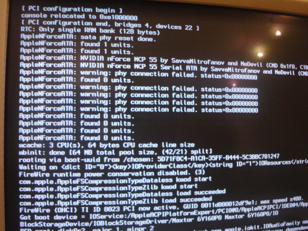

I get the KP "Out of 32kb Range" with these kexts listed:
IOATABlockStorage(Being a plugin of IOATAFamily)
IOATAFamily
IOStorageFamily
IOPCIFRamily
If I install this kext do I need to delete the kexts listed above first or just go ahead and install it as is. I am running OS X(MacPro 3.1 - [url="http://www.insanelymac.com/forum/topic/279450-why-insanelymac-does-not-support-tonymacx86/"]#####[/url].tonymacx86.com - 10.6.7 - Kernel 10.7)
eVga 780i
Intel C2Q Q9450
40GB Seagate IDE Drive(not partitioned - stand alone disk for OS X)
BenQ 1655 IDE DVD Burner
6GB BallistiX
Gigabyte Ethernet(Marvell 88E116)
On Brd Sound
Logiteck USB Keybrd
Rocatt Kone USB Mouse

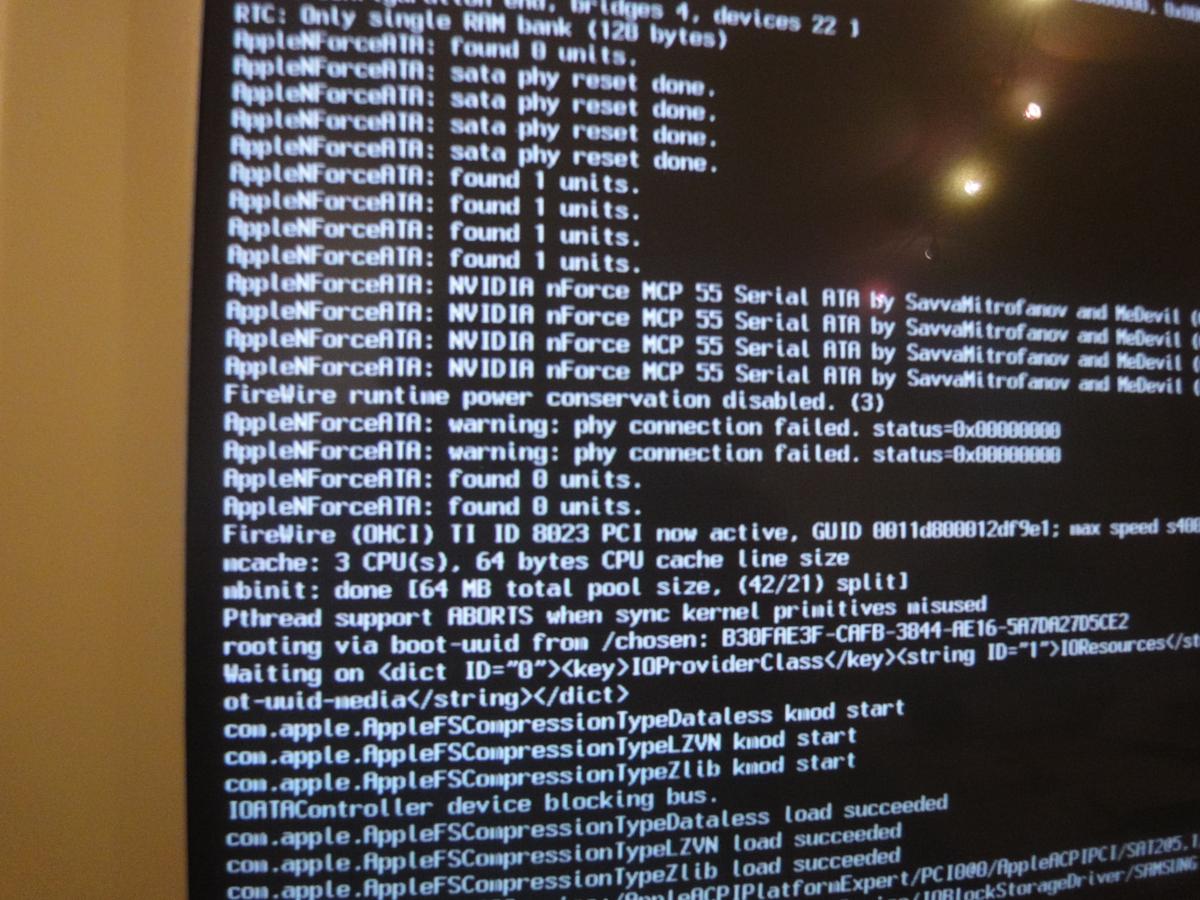

This is my first post for this forum. Recently I installed MAC OS X Lion 10.7.2 on my desktop computer based on EVGA 680i SLI with Intel Quad Q6600, 6GB of RAM, NVidia 7300 GS 256MB and 5 internal HDDs (all SATA II 3Gb/s)
After one week of hard work I finally succeed with the Lion installation but (there is a but) like other users in this forum I've started having the issue with the spinning colored ball and nothing works anymore except cold reboot and start over.
This is happening almost every time when I try copying big files or having a very intense hard drive activity.
My question is: is there any kind of solution for this annoying problem?
Thank you.
Zed
I currently use:
- boot in i386 (I get KP with x86_64)
- AppleNForceATA.imk64bit.kext
- all 6GB of RAM in use
- dual screen (RGB + DVI) with my Nvidia GeForce 7300 GS (display sleep mode work well for RGB connection but keeps sleep/awake every few seconds on DVI connection!)
Please let me know if any other info needed.
