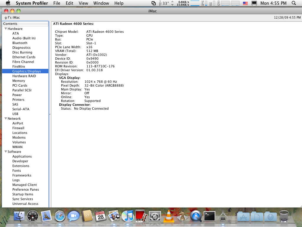

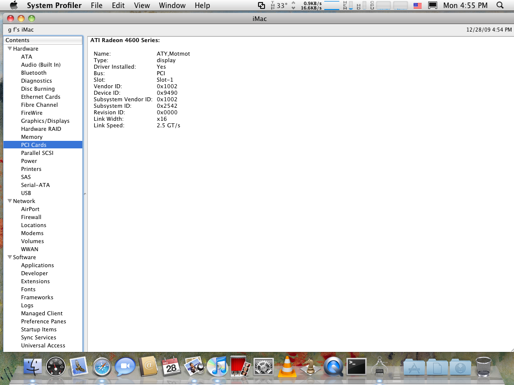

hamselv Posted December 27, 2009 Share Posted December 27, 2009 I am having halfway luck with a "MSI R4670 MD1G" (1Gb, VGA, DVI, HDMI) Using a DVI->VGA converter everything seems OK. I get good performance with surfaces when doing "orbit" in google sketchup, which was my main reason to get the card. When I connect all ports to my monitor (Syncmaster 2770hd) that is VGA->VGA, DVI->DVI, HDMI->HDMI - I get a picture on HDMI but it is too big, maybe the midlde 80% of the 1920x1080, there is nothing VGA or DVI If I use only one connection of the same kind VGA->VGA of DVI->DVI or HDMI->HDMI there is nothing. on the monitor. I still have a black screen after sleep, which I had using the build-in GMA950 Also I noticed that there is a 7.1 sound device on the board, it would be nice if that would work one day, having a clean HDMI setup. Link to comment Share on other sites More sharing options...
AuralArchitect Posted December 28, 2009 Share Posted December 28, 2009 Yeah, it would be nice to be able to use the 7.1 sound device! HDMI & DVI would be great too! LOL Oh, yeah... and dual-monitor support. That's what I should've asked for Christmas!!! LOL I missed it. Hopefully those things will be added/fixed in the upcoming 10.6.3 update... Link to comment Share on other sites More sharing options...

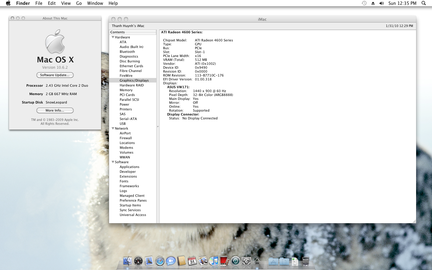

Jeanny Kaize Posted January 31, 2010 Share Posted January 31, 2010 Hi all, After i updated the Mac from 10.6 to 10.6.2, and use the boot file from netkas EFI10.5, i was able to set my display resolution to 1440x900. I'm using the HIS R4670 512Mb. LCD is plugged with a DVI-VGA adapter. However, i don't know how to determine that CI/QE since i can not find it in the System Profiler. Please take a look at my screen shot and help me. Thanks and Best Regards. P.S: Sorry for my bad English since i'm Vietnamese. Link to comment Share on other sites More sharing options...
Monkey D. Luffy Posted January 31, 2010 Share Posted January 31, 2010 The easiest way is to Press F12 or Click Dashboard (from Dock), then click the + sign on the lower left corner, then add any widget by clicking it. As soon as you clicked it and you noticed a ripple effect, you HAVE qi/ce. If you did not see any fancy effects, you don't have it. or try this: http://prasys.co.cc/2009/09/quartz-extreme...n-snow-leopard/ Link to comment Share on other sites More sharing options...
Jeanny Kaize Posted February 1, 2010 Share Posted February 1, 2010 The easiest way is to Press F12 or Click Dashboard (from Dock), then click the + sign on the lower left corner, then add any widget by clicking it. As soon as you clicked it and you noticed a ripple effect, you HAVE qi/ce. If you did not see any fancy effects, you don't have it. or try this: http://prasys.co.cc/2009/09/quartz-extreme...n-snow-leopard/ Thank you very much for the tip to determine QE/CI working. Now i turned to a new problem that i don't know if i can post here, or i have to create new topic in another sub-forum. My problem is: After the Snow Leopard worked fine on my desktop, i planned to install Windows 7. Yesterday, when i installed SL, i partitioned my HDD as follow (i followed the guide here in our forum): 1. 1GB HSF+ (for chameleon). 2. 40Gb HSF+ (formatted as Journaled) and installed Snow Leopard. 3. 40Gb FAT32 (will install Windows 7 here). 4. 100Gb FAT32 (will formatted as NTFS data partition to store my data). Then i installed Snow Leopard follow this instruction. And then, i installed Chameleon to the 1GB HFS+. Finally, i installed Windows 7 to the 3rd partition (40Gb FAT32, formatted to NTFS while installing Windows 7). But now, i'm only able to boot into Windows 7. Can you please tell me what to do next to have the Dual Boot SL & Windows 7 using Chameleon? I greatly appreciate your help. Link to comment Share on other sites More sharing options...
