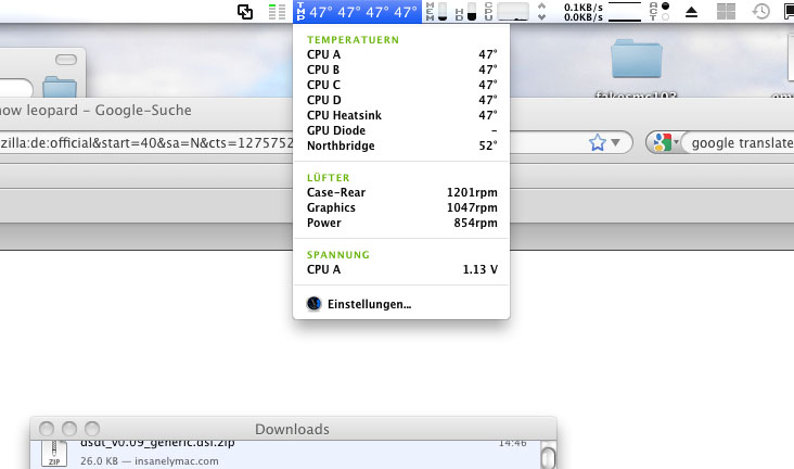

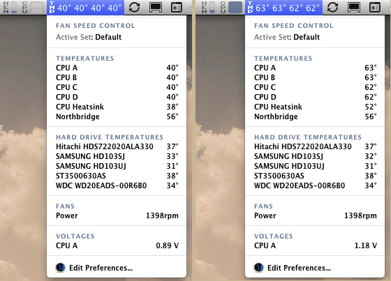

I seem to be having problems with either temperature sensors or something to do with DSDT or power management.
10.6.2 on my GA-X58A-UD7 works quite well, with only a few kexts in /E (see my signature).
At default clock (2.66), iStat reported core temperature around 41C idle.
At 3.86GHz, however, the core temperatures are around 52C idle. That seemed a bit too much so I booted into Win7 and there the same idle core temps are around 38C (going up to about 62C during prime95).
Does this discrepancy between Win7 & OSX temperatures make sense to anyone? I followed d00d's first post and he talks about idle temperatures around 39-41C, nowhere close to where I am (unless those were measured under Windows). AppleIntelCPUPowerManagement seems to be loading correctly during the OSX boot process in my case.
Any clues or suggestions?
It may be that W7 doesn't have as much running at idle compared to OS X?
My temperature readings were made by OS X Temperature Monitor.
I've noticed that the BIOS temperature alarm sounds around 10C higher than what's set.
