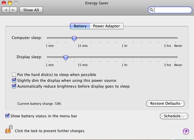

Hi valv,
i tried voodoobattery from such post and it's not showing me the battery folder under power savings preference.
Can u show us a screenshot of power saving options u have?
Thanks!
Mal

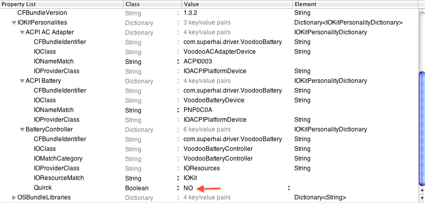

hi Mal,
look into info.plist and try to change the "Quirck" key value to "Yes".
Hi valv,
thanks for reply.
As soon as i try to change such Quirck Boolean Value from "False" to "True" (in my propertylisteditor it shows as a flag checked or unchecked and opening it in nano(terminal) it show false/ or true/) , my system panics in AppleACPIEC with dependencies in IOSMBUSFamily,IOACPIFamily,IOPCIFamily, and so on .
With such value at false/ it loads successfully (no kernel panic) but it shows no battery preference like i can see from your screenshots :/ really dunno what it is ... i tried BOTH original voodoobattery from superhai site and voodoobattery here from post23.
Any clue why it happens here ? It happens on an HDX18 laptop too ... like yours.
Mal
