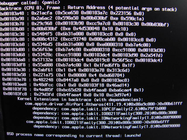

liupingguo Posted October 17, 2009 Share Posted October 17, 2009 I have a Belkin N1 Wireless Desktop PCI MIMO, Version 1000 with Atheros 5008 chip. I got KP when have it installed in 32bit, unplug it, system works normally again. Here is the screenshot, anyone can find a clue from these message? Link to comment https://www.insanelymac.com/forum/topic/186248-d-link-dwa-547-with-atheros-5008-will-not-work/#findComment-1301959 Share on other sites More sharing options...
