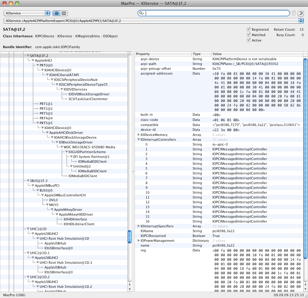

THe KiNG Posted September 9, 2009 Share Posted September 9, 2009 After another tons of tests I got to a conclusion, IMHO is not a DSDT bug but a BIOS one(if is a bug..). With same DSDT sometimes works. most dosen't with a 90% rate of failure(tired to flash my BIOS and restart forever) A friend of mine founded that is a missing interrupt on ioreg, look: Working dump pic: Not working dump pic: Also notice on not working one the new entry on ioreg IOPCIMSIMode So, or is a BIOS bug or IOPCIFamily is borked, for us... I think we can play with BIOS a bit: But so far I have no idea what to change there... @Atmosfear If you don't mind I will PM you later for some "dirty" dumps.. In mean time if you can. try to add some hdd's on those ports and see if you get smth like us...or any error, also if you have plug some cheap sata dvdrom like asus or lg, see if you get some serial atapi errors... Link to comment Share on other sites More sharing options...
Atmosfear Posted September 9, 2009 Share Posted September 9, 2009 @THe KiNG: I think that IOPCIMSIMode is not the problem, because it is also missing on the MacPro4,1. But could you expand the entry of IOInterruptControllers? On MacPro4,1 this has 17 entries and the first entry is "io-apic-0", while all the others are IOPCIMessageInterruptController. My guess is, that you are missing entry 0, which leads me to believe, that IO-APIC is disabled in your BIOS. Please check in the ASUS BIOS under Power section and play with ACPI 2.0 Support on/off and APIC support on/off. So far I have the apple supplied DVD-RW on SATA and a 1TB WD Green in an external case connected to the onboard ports and so far no problems. I will add another internal SATA DVD-RW (NEC Optiact 7240S) and an additional 1TB eSATA drive and do some test using Blackmagic Disk Speed Test. Btw. you guys should be using Blackmagic Disk Speed Test or AJA System Test for disk benchmark. XBench is one flaky peace of software, especially the disk benchmarks, which return very inaccurate or plain wrong results. Attached pic of IOReg on MacPro4,1: Link to comment Share on other sites More sharing options...

Atmosfear Posted September 11, 2009 Share Posted September 11, 2009 With APIC off=PanicWith ACPI 2.0 on/off no change. The problem seems to be on PCI IRQ Routing... ... @Atmosfear please do lspci -nnvvvb under Ubuntu 64bit if you can I did the dump under Mac OS X using the pciutils port, I'll attach the full dump. Also regarding the IOPCIMSIMode difference: This seems to indicate the usage of Message Signaled Interrupts, these can be enabled/disabled by writing to the SATA controllers registers and are always disabled in IDE mode, which would make sense, as to why IDE mode users do not see the problem. See the specs on the ICH10 chipset, page 513 and following on details regarding MSI configuration: http://www.intel.com/assets/pdf/datasheet/319973.pdf You can also see that on MacPro4,1 the MSI are disabled by looking at the lspci dump: MacPro4,1 00:1f.2 SATA controller [0106]: Intel Corporation Device [8086:3a22] (prog-if 01 [AHCI 1.0]) Subsystem: Intel Corporation Device [8086:7270] Control: I/O+ Mem+ BusMaster+ SpecCycle- MemWINV- VGASnoop- ParErr- Stepping- SERR- FastB2B- DisINTx- Status: Cap+ 66MHz+ UDF- FastB2B+ ParErr- DEVSEL=medium >TAbort- <TAbort- <MAbort- >SERR- <PERR- INTx- Latency: 0 Interrupt: pin B routed to IRQ 17 Region 0: I/O ports at 4138 Region 1: I/O ports at 414c Region 2: I/O ports at 4130 Region 3: I/O ports at 4148 Region 4: I/O ports at 4020 Region 5: Memory at 8b825000 (32-bit, non-prefetchable) Capabilities: [80] Message Signalled Interrupts: Mask- 64bit- Queue=4/4 Enable- Address: fee00000 Data: 40a0 Capabilities: [70] Power Management version 3 Flags: PMEClk- DSI- D1- D2- AuxCurrent=0mA PME(D0-,D1-,D2-,D3hot+,D3cold-) Status: D0 PME-Enable- DSel=0 DScale=0 PME- Capabilities: [a8] SATA HBA <?> Capabilities: [b0] PCIe advanced features <?> ASUS P6T X58 00:1f.2 SATA controller [0106]: Intel Corporation 82801JI (ICH10 Family) SATA AHCI Controller [8086:3a22] (prog-if 01) Subsystem: ASUSTeK Computer Inc. Device [1043:82d4] Control: I/O+ Mem+ BusMaster+ SpecCycle- MemWINV- VGASnoop- ParErr- Stepping- SERR- FastB2B- DisINTx+ Status: Cap+ 66MHz+ UDF- FastB2B+ ParErr- DEVSEL=medium >TAbort- <TAbort- <MAbort- >SERR- <PERR- INTx- Latency: 0 Interrupt: pin B routed to IRQ 14 Region 0: I/O ports at 8c00 Region 1: I/O ports at 8880 Region 2: I/O ports at 8800 Region 3: I/O ports at 8480 Region 4: I/O ports at 8400 Region 5: Memory at f7ffc000 (32-bit, non-prefetchable) Capabilities: [80] Message Signalled Interrupts: Mask- 64bit- Queue=0/4 Enable+ Address: feeff00c Data: 41b1 Capabilities: [70] Power Management version 3 Flags: PMEClk- DSI- D1- D2- AuxCurrent=0mA PME(D0-,D1-,D2-,D3hot+,D3cold-) Status: D0 PME-Enable- DSel=0 DScale=0 PME- Capabilities: [a8] SATA HBA <?> Capabilities: [b0] PCIe advanced features <?> Look closely at Capabilities: [80] Message Signalled Interrupts, it says Enable- on MacPro and Enable+ on X58. My guess is that Mac OS X can't handle Message Handled Interrupts for AHCI correctly, causing the slowdowns. macpro41_lspcivvb.txt Link to comment Share on other sites More sharing options...

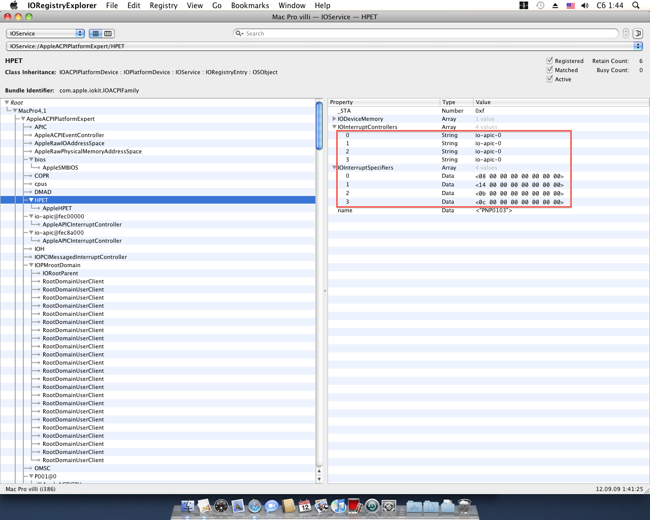

_villi_ Posted September 11, 2009 Share Posted September 11, 2009 And with hpet something wrong Link to comment Share on other sites More sharing options...
passw Posted September 11, 2009 Share Posted September 11, 2009 Hi all... I deleted AppleHPET.kext and it seems that SATA slow performance is gone... Im gonna try some more and let u guys know the outcome... Back soon with more reports... Back, seems that this work. Ive rebooted the computer into Leopard, win7 and SL like 10-15 times now Even turned my power off totally. Still work. I hope that this will work for all of us... Really dont know if AppleHPET.kext is important.... Good luck , Guys Link to comment Share on other sites More sharing options...
Rossini Posted September 12, 2009 Share Posted September 12, 2009 Hi all! I tried passw method and deleted AppleHPET.kext (of course made a backup before). Then i had kernel panics cause of AppleIntelPowerManagement.kext (or something like that). Installed NullCPUPowerManagement.kext and now everything is working like it should. Before i had a lot of problems with my DVD. And now? Nothing, nada! ... now updating my Signatur. Maybe someone can find out why deleting this kext works. Link to comment Share on other sites More sharing options...
KariNeko Posted September 12, 2009 Share Posted September 12, 2009 For those of you who are deleting/removing AppleHPET.kext, are you running AppleIntelCPUPowerManagement.kext or are you disabling it with a disabler like NullCPUPower..? By the way great finding _villi_ Thanks Link to comment Share on other sites More sharing options...

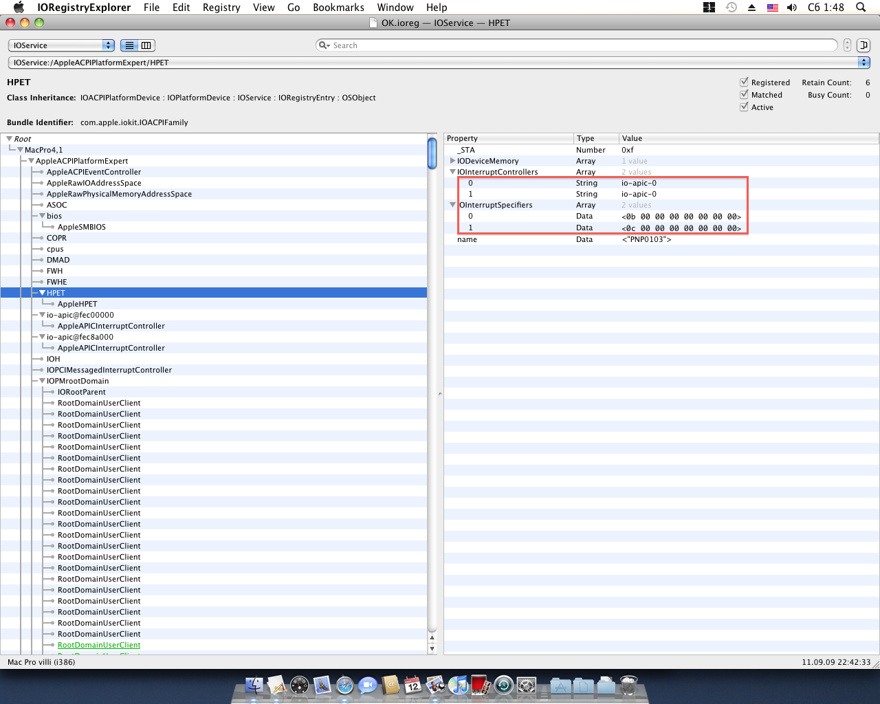

THe KiNG Posted September 12, 2009 Share Posted September 12, 2009 Yes it works with those disabled, but the system is still not stable, not to mention power management is gone. The bug is on PCI0 IRQ Routing Table(PR00 and AR00) IRQ 14 is used for both HPET and SATA(0x001FFFFF) notice on working ioreg pic that is missing on HPET and is present on SATA(io-apic-0) So that table has to be redesigned, as a fun part i added one from gigabyte it works but system is slow and hdd order is messed... Link to comment Share on other sites More sharing options...

THe KiNG Posted September 12, 2009 Share Posted September 12, 2009 That dosen't change anything.... I told you where is the bug... Link to comment Share on other sites More sharing options...
_villi_ Posted September 12, 2009 Share Posted September 12, 2009 My apologize - computer translation bios change rsdt and facp ??? why ? rsdt_facp.zip Link to comment Share on other sites More sharing options...
