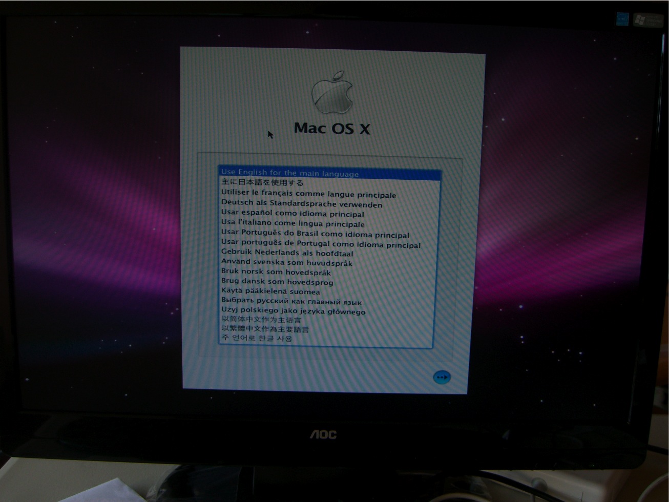

ALRIGHT! i just met Galaxy ( the Slimbuild author ) in irc, and it told me that i had to (tsk, tsk) :P;) press ESC AFTER F8 (which brings the hex menu for the bios boot drive ) and voila! no more KP!
so im booting with the slimbuild iso now, i'll update in a few minutes about progress
UPDATE: beachball defeated too!, which brings me to great, great news for all of you:
i created my own slimbuild boot (check this) without removing seatbelt.kext and AppleSMBIOSEFI.kext so it means we are back on the original track!
the link to the iso is: http://www.badongo.com/file/12836466
enjoy!

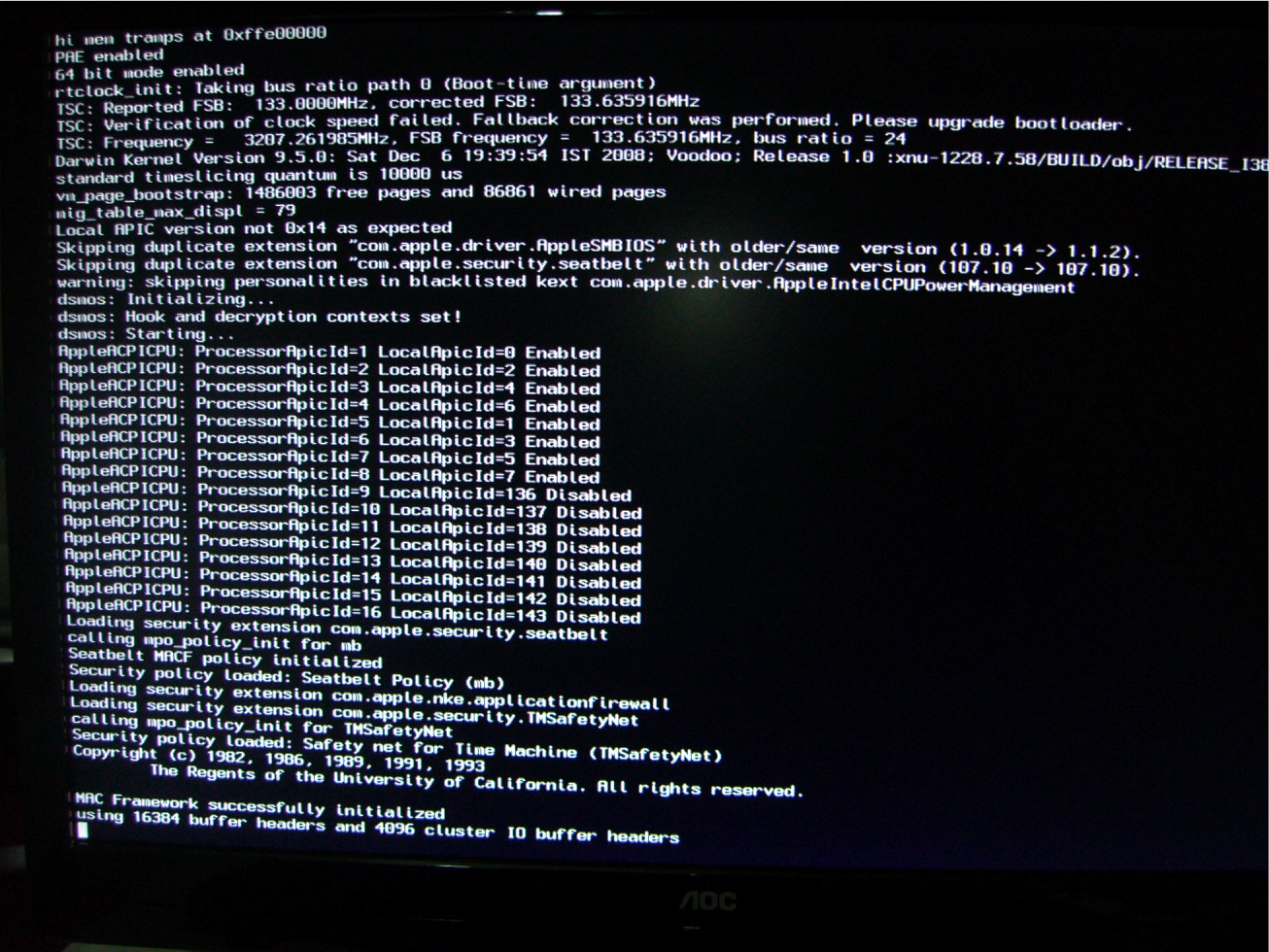

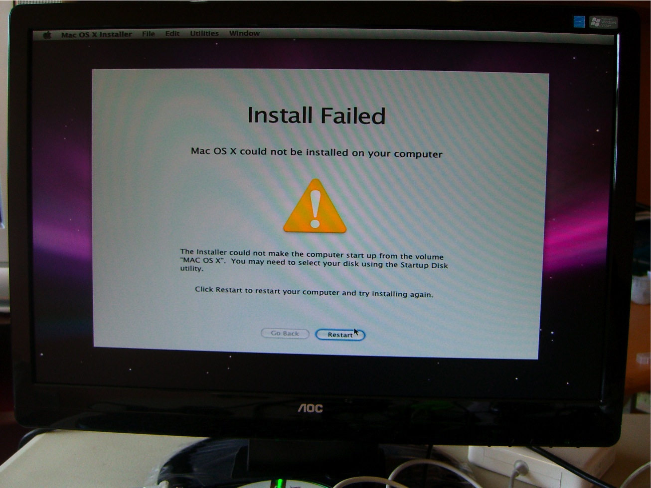

update: ok i formatted the HDD as GPT, first partition i formatted as MSDOS (for windows) and the second Mac OS case sensitive, Journaled. installation went smoothly until the end:
but i click restart, put again the efi boot disc,
f8 THEN ESC ;) then i booted with:
rd(0,1)/mach_kernel.voodoo busratio=24 -v -f rd=disk0s3 (i used 24 in the first boot to install, so it should be ok now too right?)

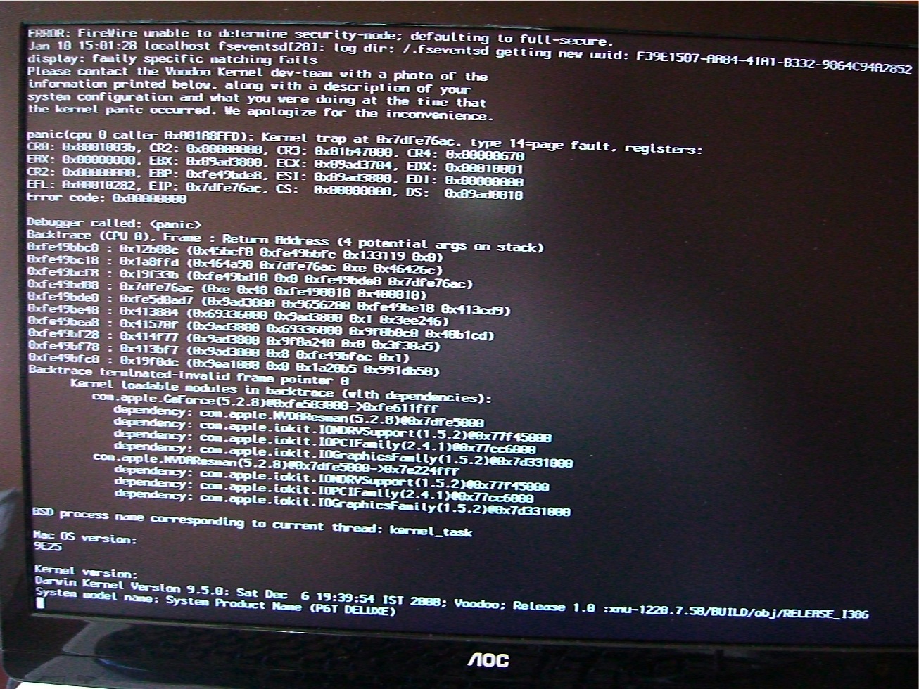

and i get this KP:
Im being told on irc that most likely this problem is caused by the video card (nvidia 9800gt 1gb), so the question is:
this is something i can fix by somehow (not really sure how) booting into a terminal and manually adding stuff or,
i have to patch the slimbuild iso and reinstall?
i'm assuming the later, but anyways, with all the problems, this is still great progress!
update: realityiswhere help me with the KP thing, basically i had to delete Geforce.kext and NVDAResman.kext, now
i finally booted into the OS :-)
