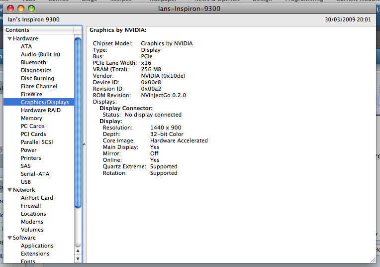

Innus Posted March 30, 2009 Share Posted March 30, 2009 Hey all, I required some extra steps to get mine to work from the ones mentioned: I had some major problems getting the graphics to work on my Inspiron 9300 (which uses Geforce Go 6800 256mb) despite following the guide on this thread, and many other threads. Took me several days of research to crack the problem (even though the steps seem quite simple that I'll describe). Note: I could not get iDeneb v1.4 (i.e. iDeneb for 10.5.6) working using the steps above, even though they worked for other people who had the same i9300 with nvidia go 6800 as me :/ .. I used iPC OSx68 10.5.6 (is an internal link ) The main problem I experienced was that often, once I got a stable system running, I could only boot if I plugged in an external DVI monitor: even after applying the steps above, the system would not boot on its own without one. I finally fixed this using the following steps, but I want to share these steps because I found that although the above guides included what I needed to get the system working, for me there were several required steps that were missing, which I'll show now. Using this guide should hopefully help anyone with the same laptop as me who finds they're required to plug in a DVI monitor. You will need: KextHelper (I used version b7) OSx86 Tools Pacifist (I used version 2.5.2) These are all available to install when installing using the iPC disk. Install iPC OSx68 10.5.6 Options: Graphics: leave all unchecked EXCEPT LaptopDisplay Ethernet: AppleBCM440XEthernet Kernel: Voodoo Chipset: ICHx Audio: AC'97 power management: BatteryManager only (AppleACPIBatteryManager?) Fixes: Seatbelt, verbose,ClamshellDisplay if it's there. Applications: select all Can't remember where it was, but the USB option that enables high speed, and the one that adds kext-loading to rc.common, these are described in the descriptions. I think the latter one is under Fixes. -- Hopefully you have installed OSX now, and you can boot it successfully, but because you didn't pick any graphic drivers, it'll be in a low-resolution mode. -- So far we aren't remarkably different to the above guide, except that we've avoided installing any graphics drivers. The other options aren't important really, at this stage, as I found I only had a problem with the graphics. Note: I didn't need to plug into an external DVI monitor. Now, 1) Download Apple Graphics Update, and open and install it using pacifist (choose overwrite all when asked) 2) Download NVinjectorgo.0.2.0Installer and install it. I found that installing using NVinstaller v41 broke my system. If you're following my guide, just use NVinjectorgo.0.2.0Installer. 3) Now, you need to edit some of the .kext files that you've just installed to /System/Library/Extensions. The best way of doing this, I found, was to open the terminal and use nano to edit each one. In each case you're navigating within the .kext to Contents/Info.plist e.g. sudo nano /System/Library/Extensions/NVinjectGo.kext/Contents/Info.plist (another way of doing this is to copy the following kexts to the desktop, edit them there, then use KextHelper to re-add them back in the right place etc) Steps you need to take: 3a) Edit NVinjectGo.kext->Contents->Info.plist <key>IOPCIMatch</key> <string>0x00c810de</string> and (missing from above guide) <key>NVCAP</key> <data> BAAAAAAABQACAAAAAAAABwAAAA= </data> and swap around <string>NVDA,Display-B</string> with <string>NVDA,Display-A</string> (you only need to change these, not the keys/strings around them) 3b) In NVDANV40Hal.kext: <key>IOPCIPrimaryMatch</key> <string>0x00c810de</string> 3c) Next, open GeForce.kext->Contents->Info.plist and change <key>IOPCIMatch</key> <string>0x00c810de</string> 3d) I didn't need to edit NVDAResman.kext . Now fix permissions etc using OSX86Tools and delete /System/Library/Extensions.kext and restart! fingers crossed... I hope this helps someone, as I couldn't find a set of steps exactly the same as these anywhere: it was a mish-mash of other tutorials. EDIT: I've uploaded an archive containing the working kexts that I think are relevant: insert these using KextHelper, then repair permissions using OSx86Tools p.s. they're not viruses, honest! Just for ease of use =D .Note: this is only a replacement for step 3, you still need to do steps 1 and 2 first EDIT: added a screenshot of System Profile Link to comment Share on other sites More sharing options...

Kevin87 Posted April 29, 2009 Share Posted April 29, 2009 Innus, You rock man. Thanks a lot for taking the time to post that. I could not find how to fix my laptop screen for the life of me and modifying the NVInjectGo.kext solved the problem. Just wanted to mention that my device ID was 00c9 and not 00c8 so if anyone is having problems I would check your device ID. Link to comment Share on other sites More sharing options...
Innus Posted April 29, 2009 Share Posted April 29, 2009 Innus, You rock man. Thanks a lot for taking the time to post that. I could not find how to fix my laptop screen for the life of me and modifying the NVInjectGo.kext solved the problem. Just wanted to mention that my device ID was 00c9 and not 00c8 so if anyone is having problems I would check your device ID. Hey, no problem! Glad it helped Link to comment Share on other sites More sharing options...
