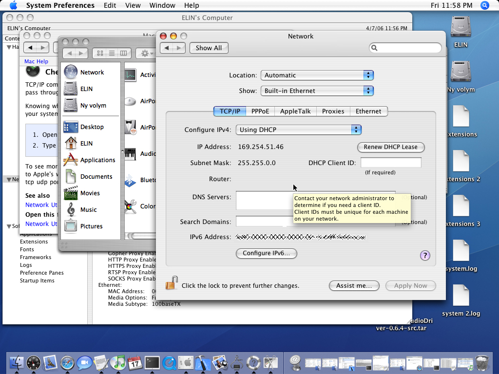

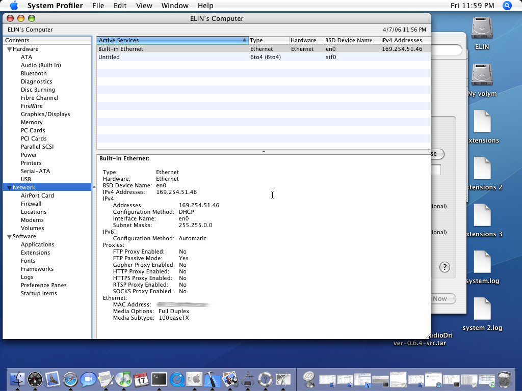

ROELLE Posted April 7, 2006 Share Posted April 7, 2006 **************** Got some major update! Im running a A8N-VM Board with nforce 4 410 chipset. I got all the stuff to work for now BUT, i wont get any ip adress, im just getting the ol 169.254.51.46, when I boot into windows I get an working ip! :/ Posting log when I kextload it ********************* Apr 7 23:50:18 elins-computer kernel[0]: forcedeth: Initializing. Apr 7 23:50:18 elins-computer kernel[0]: forcedeth: Probing. Apr 7 23:50:18 elins-computer kernel[0]: forcedeth: WARNING - your nVidia device 0x10DE:0x0269 is not known to work, but it could be supported in the future. Please contact the coder. Continuing anyway... Apr 7 23:50:18 elins-computer kernel[0]: forcedeth: Starting. Apr 7 23:50:18 elins-computer kernel[0]: forcedeth: PCI system 0x10DE:0x0269, subsystem 0x1043:0x816A opened. Apr 7 23:50:18 elins-computer kernel[0]: forcedeth: Mapped from 0xDFFBC000 of length 4096. Apr 7 23:50:18 elins-computer kernel[0]: forcedeth: Allocated 3072 bytes of contiguous memory for DMA: rx at 0x1b4b2000, tx at 0x1b4b2400, wired at 0x13c43000. Apr 7 23:50:18 elins-computer kernel[0]: forcedeth: Found nForce4 LAN with MAC: 00:XX:D4:FD:XX:AE. Apr 7 23:50:18 elins-computer kernel[0]: forcedeth: Found PHY 0x0000:0x0020 at address 1. Apr 7 23:50:18 elins-computer kernel[0]: com_triton_forcedeth: Ethernet address 00:xx:d4:XX:Xc:ae" ********************* Anyone with a solution? Gonna work on this all night long, I REALLY want the net to work in OS X, I got all sound and gfx hooked up so I just need this ;D Some screens: Link to comment Share on other sites More sharing options...
