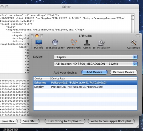

mitch_de Posted December 17, 2008 Share Posted December 17, 2008 I made an new EFISTUDIO_EXTENDED with TRIAKIS( i not recommend anymore since 10.5.5) and MEGADOLON support for ATI 3850/3870 512 MB. Both names are name for different framebuffer - problems with framebuffer may give blue screen or scrambled screen. You dont need NATIT anymore (often also makes problems!). Delete it if you have it in extensions. You can add ETHERNET Device which fixes TIMEMACHINE , then add 3850 MEGA.... Grafik Device and let the tool create your efistring in the boot.plist. The ETHERNET device efistring , i didnt know that before (i used before that modded but very old IONET...kext TM fix ) can really named TIMEMACHINE_FIX , it sets the ethernet to build in=true , which IONET.KEXT always sets build in=false at boottime without efistring for ETHERNET Device. I tested both with 10.5.6 : Timemachine now works again (with orig. newest 10.5.6 IONET...kext) and orig. newest OpenGL/ ATI 10.5.6 drivers. HINT: The new great pcwiz UniversalInstaller has a bug, cant make both EFISTR TM_FIX+ EFISTR GPU. It only creates one string, even both sould be created. Attatched EFISTUDIO_EXTENDED .sitx.zip (smaller) / also as .zip (small) EDIT: May also work for ATI 3870 (also use 3850 Megadlon Selction) DL today didnt work. Tried to upload again - not working. Must be a problem of the forum ! I will upload it later again. Link to comment Share on other sites More sharing options...

dodusman Posted December 18, 2008 Share Posted December 18, 2008 I made an new EFISTUDIO_EXTENDED with TRIAKIS( i not recommend anymore since 10.5.5) and MEGADOLON support for ATI 3850/3870 512 MB.Both names are name for different framebuffer - problems with framebuffer may give blue screen or scrambled screen. You dont need NATIT anymore (often also makes problems!). Delete it if you have it in extensions. You can add ETHERNET Device which fixes TIMEMACHINE , then add 3850 MEGA.... Grafik Device and let the tool create your efistring in the boot.plist. The ETHERNET device efistring , i didnt know that before (i used before that modded but very old IONET...kext TM fix ) can really named TIMEMACHINE_FIX , it sets the ethernet to build in=true , which IONET.KEXT always sets build in=false at boottime without efistring for ETHERNET Device. I tested both with 10.5.6 : Timemachine now works again (with orig. newest 10.5.6 IONET...kext) and orig. newest OpenGL/ ATI 10.5.6 drivers. HINT: The new great pcwiz UniversalInstaller has a bug, cant make both EFISTR TM_FIX+ EFISTR GPU. It only creates one string, even both sould be created. Attatched EFISTUDIO_EXTENDED EDIT: May also work for ATI 3870 (also use 3850 Megadlon Selction) Thank's. Could you post in ZIP no sitx please ? Link to comment Share on other sites More sharing options...

weaksauce12 Posted December 31, 2008 Share Posted December 31, 2008 I installed a 512mb Sapphire HD 3870 and it is working with the "ATI Radeon HD 3800_MEGADOLON - 512MB" EFI String. I edited the XML for my particular card: I was using one of lastExile's installers previously. That installer has no fan management, but this string seems to have some - the fan stops spinning from time to time. I'll definitely have to pick up a silent cooler for this puppy. A couple questions: 1. How do you initially install an ATI card? I tried doing a fresh install, but I got a scrambled screen upon booting. I tried -f and -x, but just got gobbly-gook on the screen. I ended up using one of my NVIDIA cards for the initial installation in VESA mode, then installing the ATI driver, then rebooting and install the ATI card. 2. Is there any better fan management for ATI? Mine seems to go either full-tilt or stop spinning. Link to comment Share on other sites More sharing options...
