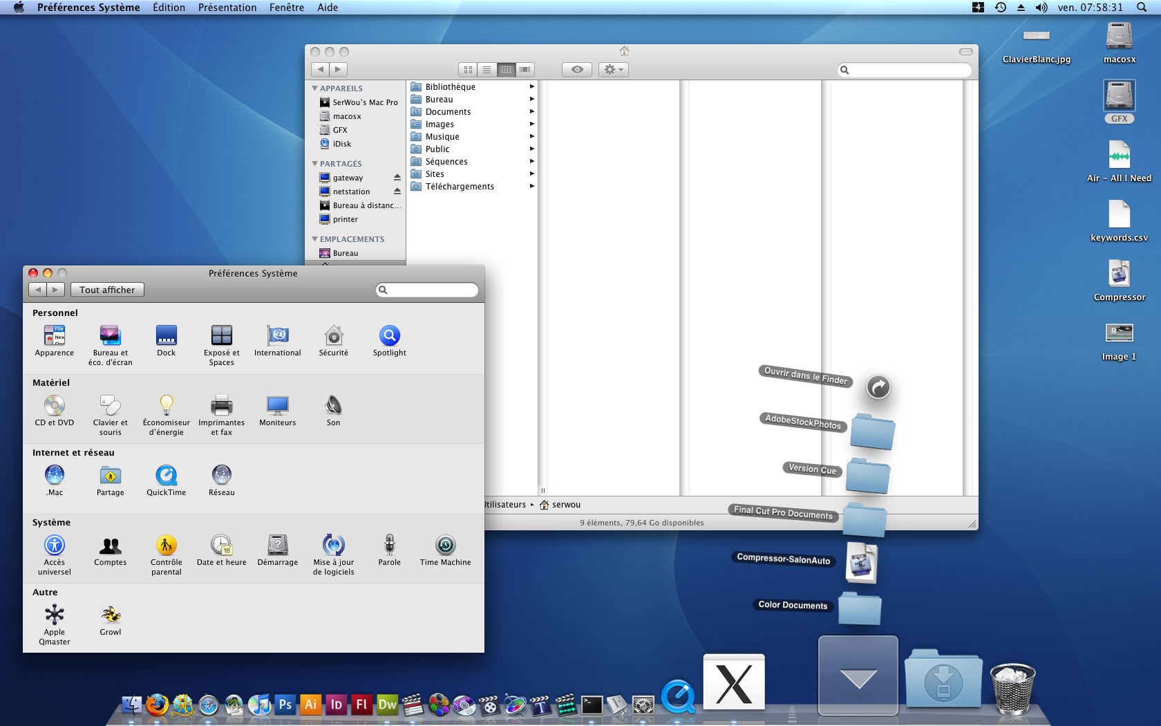

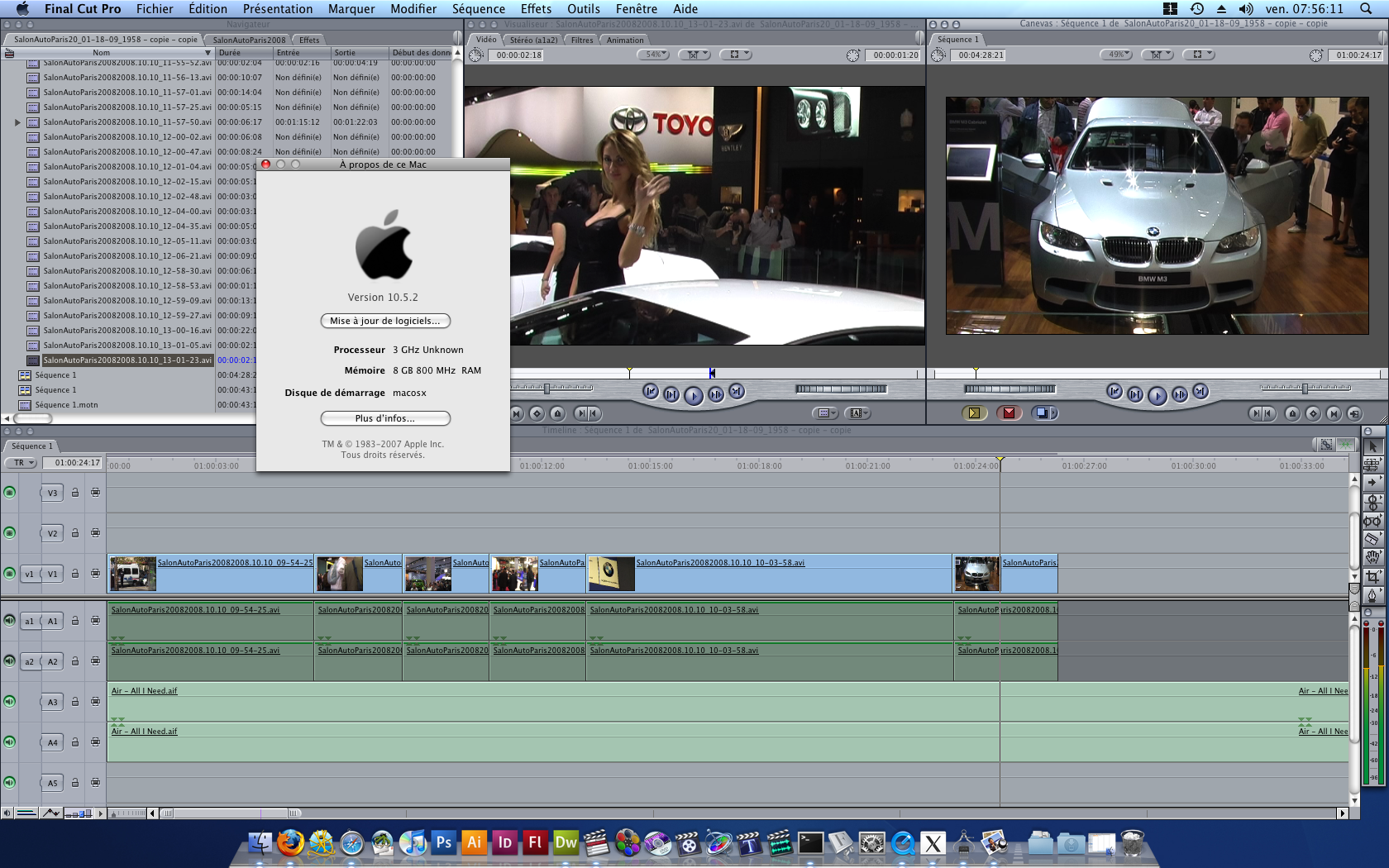

Crono S'6 Posted March 24, 2008 Share Posted March 24, 2008 Hello, First of all, I would thanks ALL people : who posted in the InsanelyMac Forum : http://forum.insanelymac.com the hardware compatibilty list (HLC) : http://wiki.osx86project.org/wiki/index.php/HCL_10.5.2 the one from the IRC chat (irc.osx86.hu ♯hackint0sh) After a couple of weeks of googling, read the HLC and so on and some questions here Topic 86404, I bough : Motherboard Gigabyte GA-P35-DS3L / GA-P35-S3L CPU Intel Q6600 (4 cores) Video Card knows as Geforce 8600GT (Gigabyte GV-NX86T256H / GV-NX86T256H-ZL / GV-NX86T512H) 8GB of Corsair DDR2-RAM a SATA DVD burner a 500GB Western Digital SATA2 HDD 550W silent power supply Then, I've download via Bittorrent the Kalyway MacOSX86 version, which is the 10.5.2 version (KALYWAY_LEO_10.5.2_intel_SSE2_SSE3.zip) and burned on a DVD (I had to overburn a little bit) According to this Forum Tutorial, i tweak a couple of BIOS Settings Put the CD, boot on it, wait for 10min and I have the installation wizard I choose Utilities > Disk Utility, I've created a 80GB partition (should be ok with 15GB but I knew I have to install big softwares such as Adobe Creative Suite, Final Cut Pro and so soon...). I gave a simple short name to the partition : macosx and formated as Mac OS Extended(journaled). Then, I setup the second partition (around 410GB) for my business (short name : GFX, formated as Mac OS Extended(journaled)) After a couple of questions, MacOSX begun the installation, after 10min, it rebooted and HERE WE ARE, MacOSX x86 is up and running on my PC The network and audio works fine, the Video need a patch. Do not update via the System Updated, I've broke my system by mistake, let's try after a backup BACKUP NOW, I've used this free application Carbon Copy Clone : http://www.bombich.com/software/ccc.html I took as source the macosx HD and choose a new Destination Disk to my other partition driver Launch it and wait for 20min, it will make a .DMG. It will allow you to restore your system someday :censored2: Here is the way to install the Nvidia drivers, it's pretty simple : Download NVinstaller : http://scottdangel.com/blog/?p=23 Run it and choose the right amount of memory you have, wait and then, reboot Should works, if not : good luck. If yes, go to the step 6) once more. Come on, don't be lazy. How long did he take to arrive at the step 7? How long you have to wait for a full backup? [*]I usually recommand to install Open Source softwares found here : http://www.maclibre.com/ Web browser Firefox : http://www.mozilla.com/en-US/firefox/all.html IRC Client Colloquy : http://colloquy.info/ FTP Client Cyberduck : http://cyberduck.ch/ Open Office : http://download.openoffice.org/other.html [*]WE ARE DONE, enjoy The only problems for me now are some characters are missing on my keyboard such as the @ ♯ or !. They are somewhere but where... I hope you enjoyed this experience. It's not a dream, it's true : here is my own print screens : Edit : 15 April 2009 : changed the size of the first HD if you install graphic appz Edit : 25 June 2008 : removed the sound part, works out of the box now Edit : 5 July 2008 : added http://www.maclibre.com/ website. Edit : 13 Feb 2009 : updated the printscreen and my Mac OSX version Link to comment https://www.insanelymac.com/forum/topic/95414-success-story-installation-of-kalyway-macosx86-on-my-pc/ Share on other sites More sharing options...
