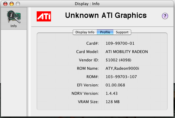

Slice Posted November 24, 2008 Author Share Posted November 24, 2008 I found new keys useful for ATILead.info.plist <key>ATY,Copyright</key> <string>Copyright ATI Technologies Inc. 2005</string> <key>ATY,EFIVersion</key> <string>01.00.068</string> <key>ATY,EFIDisplay</key> <string>LVDS</string> <key>ATY,Card#</key> <string>109-99700-01</string> <key>ATY,Rom#</key> <string>103-99703-107</string> <key>@0,ndrv_version</key> <string>1.4.43</string> <key>ATY,memsize</key> <integer>0x08000000</integer> <key>ATY,Fcode</key> <string>1.95</string> <key>ATY,VendorID</key> <integer>4098</integer> Look also posts by Krazubu http://forum.insanelymac.com/index.php?sho...96664&st=51 post #52 and #57. ATIUtilities is a significant part of ATI driver. It can switch on TVOut, tune OpenGL, find diplays and others. With new keys I have more interesting picture. Why "Unknown ATI Graphics"? Link to comment https://www.insanelymac.com/forum/topic/91042-atilead-natit-like-injector-for-radeon/page/5/#findComment-975898 Share on other sites More sharing options...

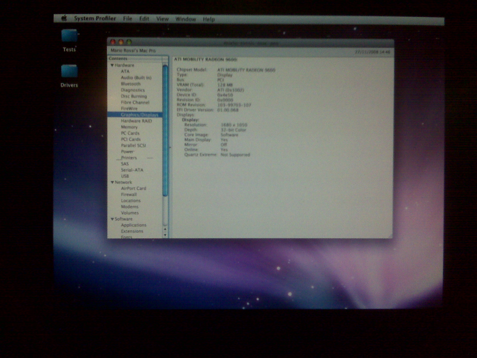

berteso Posted November 26, 2008 Share Posted November 26, 2008 Slice, so far here is the best configuration I have found for my laptop, an ASUS W1NA with Mobility Radeon 9600/9700 (M10/M11) Dev_ID 4e50: - your ATI FB - ATILead 1.2.2 with Info.plist.zip plist, updated with your last post keys + LCD, EDID from Windows extracted using Phoenix app for win. AGPGart 2.7.1 IONDRVSupport 1.4.3 (your one) IOPCIFamily patched for Leo (from your AGPGart Forum) I can enter GUI and my Xbench score for Quarz Graphics went from 40.xx to 80.xx. My native resolution should be 1600x1050x32 (which I could get with Callisto) however, max I can enter is 1280x1024x32. I have tried turning on QE/CI using X1000/9700 GLDriver patch/rename method, however, I can't get it working on thits new configuration. In fact, Radeon9700GA.plugin (which I even patched as you have suggested to IOFramebuffer) conflict with AGPGart. Here are my reports: - ioreg.txt.zip - system.log.txt.zip Thank you very much for your time. I must say you are doing a tremendous work. If there is anything I can do to help, please let me know. Link to comment https://www.insanelymac.com/forum/topic/91042-atilead-natit-like-injector-for-radeon/page/5/#findComment-978726 Share on other sites More sharing options...
Slice Posted November 27, 2008 Author Share Posted November 27, 2008 2 berteso First of all thank you for good testing. I am looking into your system.log and have some questions. Nov 26 17:42:43 mario-rossis-mac-pro kernel[0]: AUDI: family specific matching fails Nov 26 17:42:43 mario-rossis-mac-pro kernel[0]: P0P2: family specific matching fails this spam arises because of skge.info.plist. You must set IOPCIMatch to be more specific 0x432011ab. Nov 26 17:42:43 mario-rossis-mac-pro kernel[0]: skgeosx::probe(VGA) Nov 26 17:42:43 mario-rossis-mac-pro kernel[0]: skgeosx::start(VGA) <1> Why "VGA"? It is a driver for LAN! Ati: F8 written 08000000 May be you can't use GA.plugin because of this value. Try 0x003f0000. This value is my headache. I don't know why it influences on GA. AGP: Aperture Reduced To 128MB May be it is better you reduce aperture manually in BIOS? ATIFB: Panel Size from BIOS: 1680x1050 ..... Nov 26 17:42:47 mario-rossis-mac-pro kernel[0]: 640x480@60Hz Nov 26 17:42:47 mario-rossis-mac-pro kernel[0]: 800x600@60Hz Nov 26 17:42:47 mario-rossis-mac-pro kernel[0]: 1024x768@60Hz Nov 26 17:42:47 mario-rossis-mac-pro kernel[0]: 1152x864@60Hz Nov 26 17:42:47 mario-rossis-mac-pro kernel[0]: 1280x960@60Hz Nov 26 17:42:47 mario-rossis-mac-pro kernel[0]: Detailed Timings Nov 26 17:42:47 mario-rossis-mac-pro kernel[0]: modes from EDID extracted So your EDID doesn't include 1680x1050 mode? My driver Ati.kext seems do not use Panel Size information to create native videomode. Did you try to change | | | | | "width" = <00040000> | | | | | "linebytes" = <00100000> | | | | | "height" = <00030000> width = 1680 height = 1050 linebytes = width * 4 injected in ATILead.info.plist? And at last. Did you try the same but without AGPGart? With AGPGart v2.6.7? Link to comment https://www.insanelymac.com/forum/topic/91042-atilead-natit-like-injector-for-radeon/page/5/#findComment-979327 Share on other sites More sharing options...

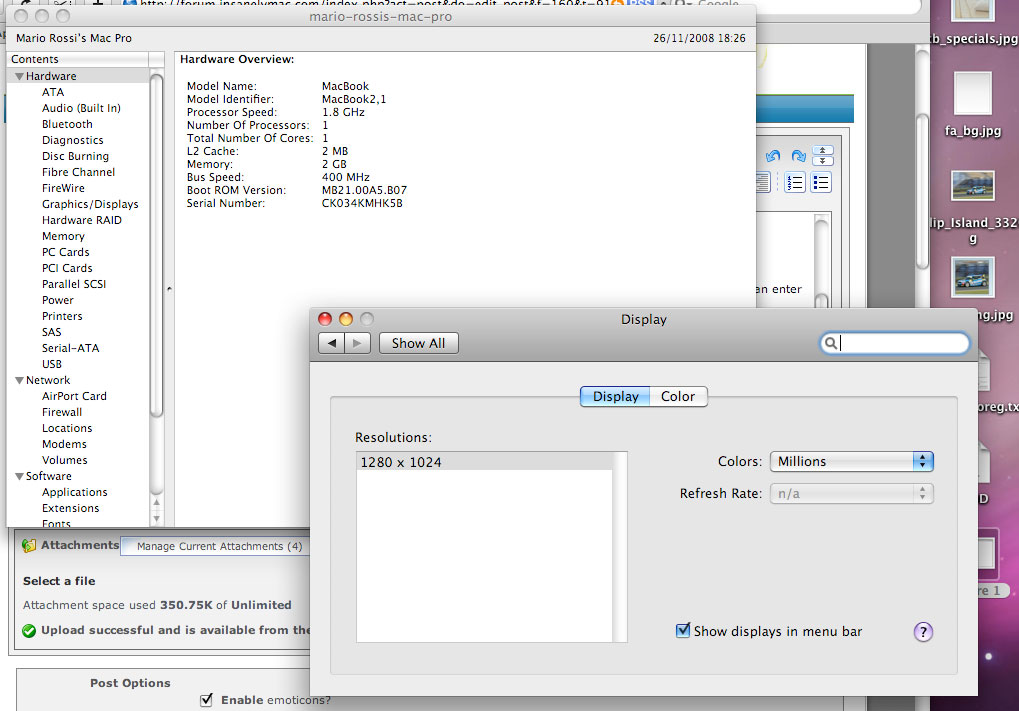

berteso Posted November 27, 2008 Share Posted November 27, 2008 2 Slice Thanks for reviewing the stuff so quickly. skge the devid vendid was already specified in the plist. However I did remove the other ones, leaving only mine but nothing changed. skge::probe VGA I never got why it says so... Radeon9700GA Success!! Got it to work, without AGPGart, with F8 = VRAM (in my case 64 MB) AGPGart I tried other versions, but 2.7.1 is the only one working if I use Host base 0xe0000000 or 0xe80000000. However, it doesn't work with ATIRadeon9700GA. Seems that it's either one or the other for me so far. Native Resolution I tried what you said and it partially worked: i got my native resolution of 1680x1050x32 however the display was only showing a portion of it. In other words, I could only see an area as big as 1024x768 or 1280x1024 (depending on how I boot with "Graphics Mode"="widthxheightx32"). See screenshot below: Link to comment https://www.insanelymac.com/forum/topic/91042-atilead-natit-like-injector-for-radeon/page/5/#findComment-979939 Share on other sites More sharing options...

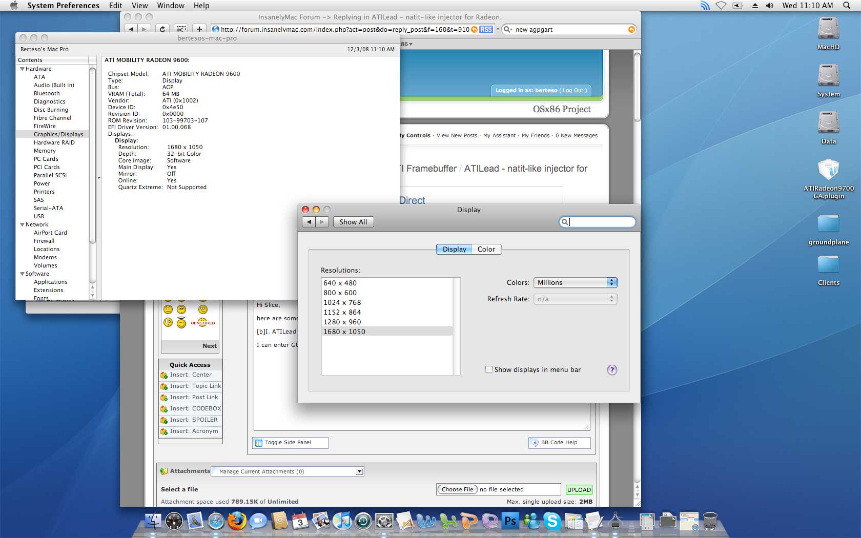

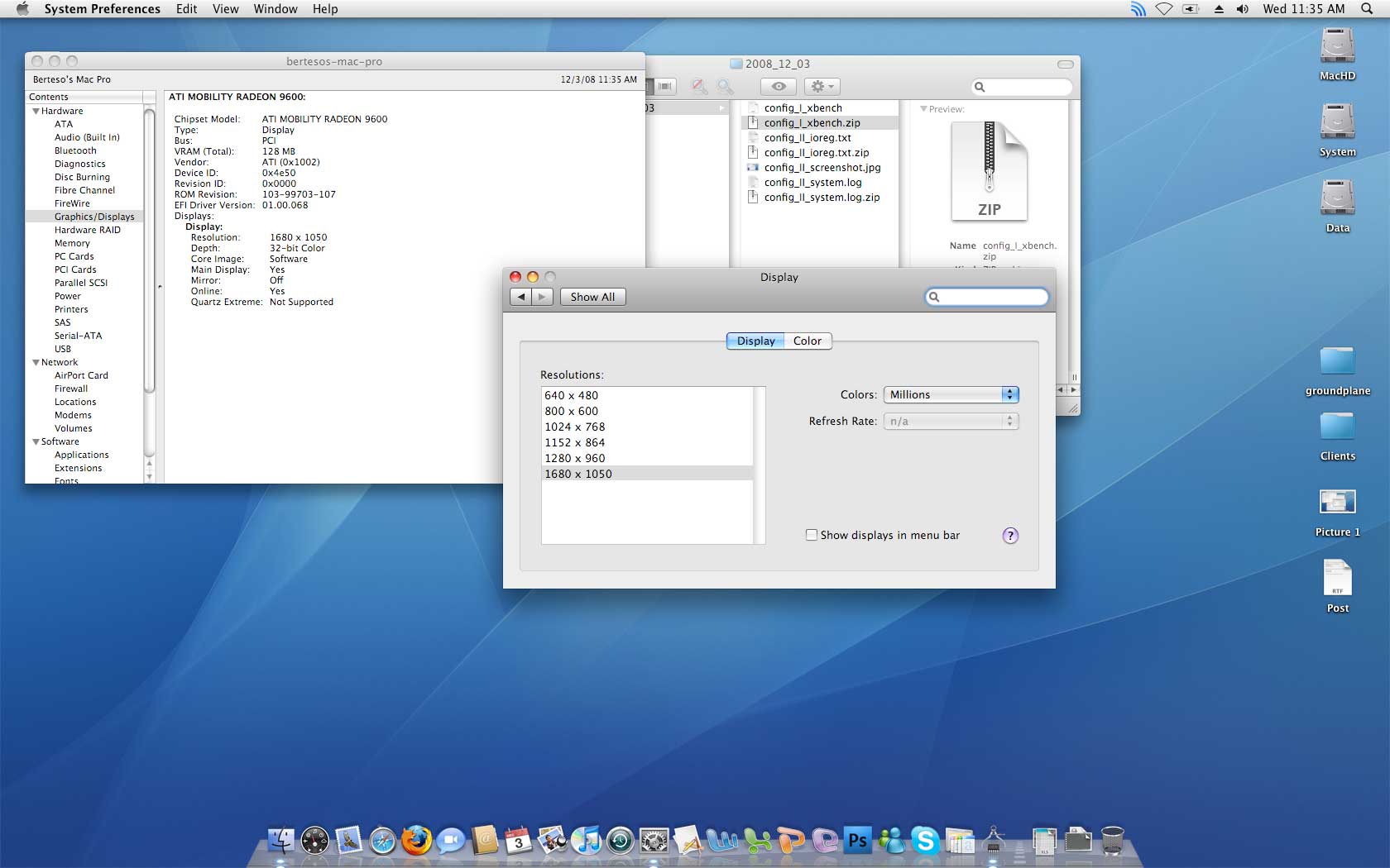

berteso Posted December 3, 2008 Share Posted December 3, 2008 Hi Slice, here are some new results that might be interesting for your research. Config I. ATILead -> Callisto 008 + GA.plugin Mouse tearing Scrolling is smooth DVDPlayer doesn't crash config_I_ioreg.txt.zipconfig_I_system.log.zipconfig_I_xbench.zip Config II. ATILead -> Callisto 008 + AGPGart 2.7.1 (Host: 0xe8000000) GA.plugin No mouse tearing Scrolling is choppy DVDPlayer crashes config_II_ioreg.txt.zipconfig_II_system.log.zipconfig_II_xbench.txt.zip Notes: ATILead:: Info.plist unchanged from last posts ATILead seems to be probing twice... I had to reinstall Kalyway so: IONDRVSupport Kalyway 10.5.1 original IOPCIFamily Kalyway 10.5.1 original skge not installed yet XBench :: overall it seems that with your ATI.kext scores(+-80) are higher than with Callisto (+- 55), unless it is a resolution issue (I am now using my native 1680x1050 thanks to Callisto whereas with ATI.kext was in VESA 1280x1024). Look forward for your comments. Cheers Link to comment https://www.insanelymac.com/forum/topic/91042-atilead-natit-like-injector-for-radeon/page/5/#findComment-986363 Share on other sites More sharing options...
Slice Posted December 8, 2008 Author Share Posted December 8, 2008 I had to reinstall Kalyway so: IONDRVSupport Kalyway 10.5.1 original IOPCIFamily Kalyway 10.5.1 original skge not installed yet Do you remember that OpenGL impossible for your Radeon in 10.5.x because of ATIRadeon9700GLDriver.bundle? It is PowerPC only! XBench :: overall it seems that with your ATI.kext scores(+-80) are higher than with Callisto (+- 55), unless it is a resolution issue (I am now using my native 1680x1050 thanks to Callisto whereas with ATI.kext was in VESA 1280x1024). Yes, I know that Ati.kext is not finished to provide more resolutions. Sorry! Development is paused waiting for new programmers. Link to comment https://www.insanelymac.com/forum/topic/91042-atilead-natit-like-injector-for-radeon/page/5/#findComment-991493 Share on other sites More sharing options...
