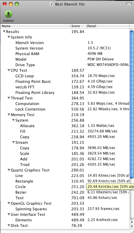

mtotho Posted February 18, 2008 Share Posted February 18, 2008 Mine is at 3ghz.. 334 fsb.. here are my results, before the oc, my total score was 165, it raised everythings performance. 35 percent cpu usage at the time of this picture Link to comment https://www.insanelymac.com/forum/topic/88510-recommended-oc-values-for-p35-ds3q6600/#findComment-631441 Share on other sites More sharing options...
