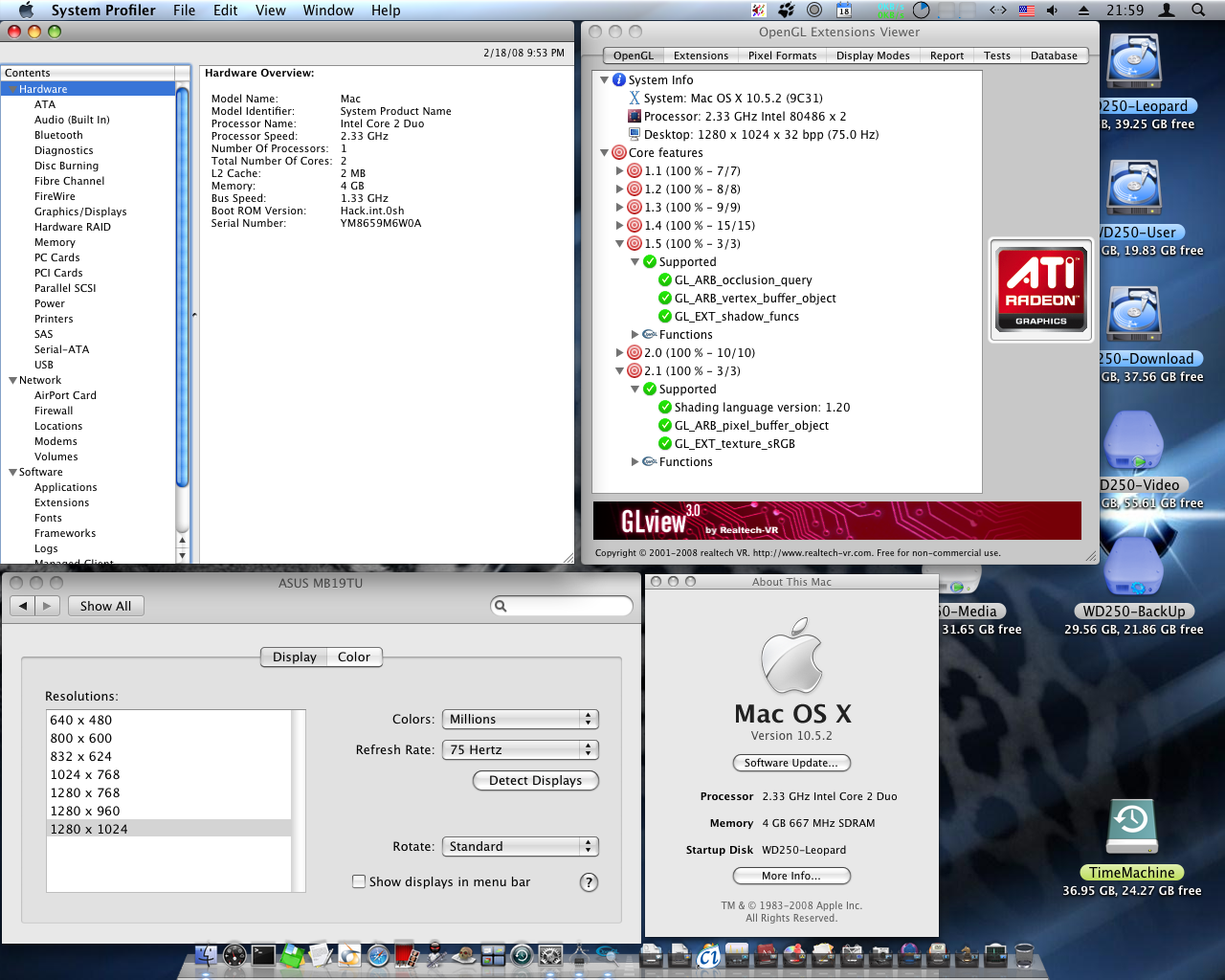

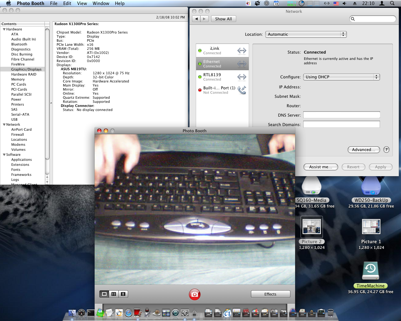

auqs10 Posted February 18, 2008 Share Posted February 18, 2008 This is my first guide, and refers to the install procedure of Kalyway's 10.5.1 Leopard and updated version to 10.5.2 Motherboard ASUS P5LD2 (GREEN) BIOS settings 1. Updated with version 1904 from ASUS home 2. in the MAIN / IDE Configuration section I set following options: Configure SATA (Standard IDE) Onboard IDE ... (Enhanced Mode) Enhanced Mode ... (S-ATA) IDE Detection time ... (0) 3. in the ADVANCED / Jumper Free Configuration section AI Overclocking (Manual) CPU Frequency (333) DRAM Frequency (DDR2-666MHz) the rest I set them (AUTO) 4. in the ADVANCED / USB Configuration section USB Function (Enabled) Legacy USB Support (AUTO) USB 2.0 Controller (Enabled) USB 2.0 Controller Mode (HiSpeed) BIOS EHCI Hand-off (Enabled) 5. in the ADVANCED / CPU Configuration section Frequency 2331 MHz (these cannot be set, but they are displayed, see captures attached) FSB 1333 MHz (these cannot be set, but they are displayed, see captures attached) Default CPU Ration (Disabled) Ratio CMOS setting (7) VID CMOS setting (62) Execute Disable Function (Enabled) - forcing flag to always return 0 - by factory default is (Disabled) 6. in the ADVANCED / Chipset section Boot Graphic Adapter Priority (PCI Express/PCI) 7. in the ADVANCED / Onboard Devices section HD Audio Controller (Enabled) Front Panel ... (AC97) Onboard PCIEX GbE LAN (Enabled) LAN Option ROM (Enabled) ITE8211F Controller (Disabled) - comes (Enabled) by factory settings - should be enabled only when drives are plugged into extra IDE controller (but they cannot be recognized in OSX) 8. in the ADVANCED / PCIPnP section Plug and Play O/S (Yes) PCI Latency Timer (32) Allocate IRQ to PCI VGA (Yes) Palette Snooping (Disabled) - comes (Enabled) by factory settings HARDWARE Compatibility with patching solutions Motherboard - ASUS P5LD2 (green) - Chipset Intel 945P - Socket LGA774 - onboard LAN - Marvell 88E8053 PCI-E Gb - fully working w/o patch - sound ALC882 8ch - needs Taruga's v1.20 and 882.txt dump code - PS2 Keyboard and Mouse working w/o patch on 10.5.1, but needs patches on 10.5.2 (ACPIPS2NUB.kext & ApplePS2Controller.kext needed) Processor - Intel Core 2 Duo E6300 1.86GHz (overclocked at 2.33 GHz in BIOS) - working fine (GeekBench ~3000) Memory - 4x1 Gb DDR2-667MHz PC2-5300 (available 3.2 Gb and 896 Mb reserved - reported by POST and BIOS on system start) Monitor - ASUS MB19TU - working fine at 1280x1024@75Hz Video card - Sapphire ATI X1300Pro 256 Mb - working fine QE/CI with patch from DiaboliK Extra LAN PCI card - RTL8139 - working fine with patch AppleRTL8139Ethernet.kext version 1.41 Hard disk 1 - SATA2 - Western Digital WDC WD2500YS-01SHB1 - partitioned with Kalyway's OSX 10.5.1 DVD (GUID) - system Leo 10.5.1 installed on first HFS+ journaled partition, and working with "vanilla" kernel from the DVD; - system updated with combo 10.5.2 (340 Mb from Apple) but respecting the Kalyway's rules Hard disk 2 - SATA2 - Seagate Quantum ST3160811AS - MBR partitioned (Vista 32 on first primary NTFS partition) Hard disk 3 - IDE 100 Primary Master - Western Digital WDC WD400JB-00EAT00 - HFS+ journaled formated and allocated for TimeMachine DVD-RW ASUS DRW-1608P2S - IDE Primary Slave - fully supported Please consider this guide only as it is for the specific parts mentioned above. Is on your OWN RISK. I have attached captured screens for the non-believers. Link to comment https://www.insanelymac.com/forum/topic/88497-guide-asus-p5ld2-with-leo-1052-updated-from-kalyway-1051/ Share on other sites More sharing options...

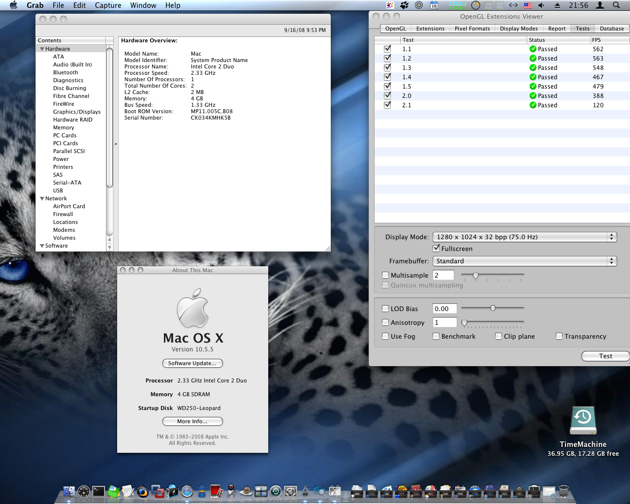

auqs10 Posted September 16, 2008 Author Share Posted September 16, 2008 Hi folks, yesterday the new 10.5.5 cat was launched and again I managed to install it respecting the method used for 10.5.2 , 10.5.3 or 10.5.4 (see some guides in the forums to this link http://forum.insanelymac.com/index.php?showtopic=107340#). Just Audio has to be reinstalled (ALC882 from the older kext). Everything works out of the box. Capture attached for proving the result. Link to comment https://www.insanelymac.com/forum/topic/88497-guide-asus-p5ld2-with-leo-1052-updated-from-kalyway-1051/#findComment-893185 Share on other sites More sharing options...
