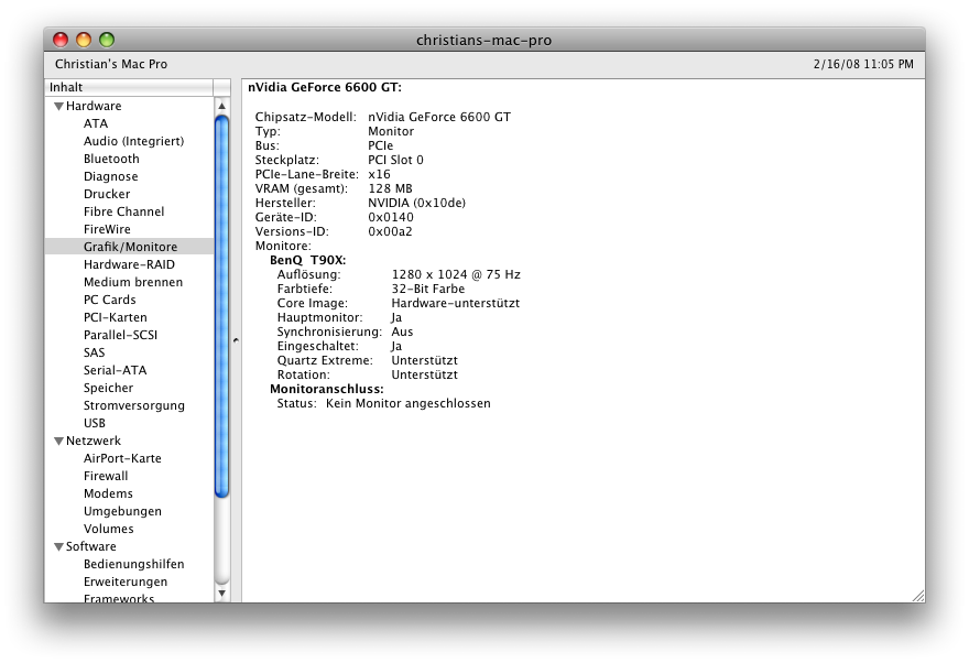

jetztsofort Posted February 16, 2008 Share Posted February 16, 2008 Hey guys, a few days ago I've successfully installed Zephyroth's AMD Leopard (Athlon 3200) and I have a problem: My GeForce 6600GT has got one DVI and one VGA output. I've got two monitors: one 20" plugged in by DVI and one 19" plugged in by VGA. When I start with both monitors plugged in, he only uses the 19" (VGA) screen and "detect Monitors" doesn't help. When I've just plugged in the 20" (DVI) it uses the 20"-Screen. When I start the system with both monitors, move my mouse to "detect Monitors", plug the 19" (VGA) out and click, my 20" gets a signal and works. Seems, that my system can only use one monitor. Also it's shown only one monitor in the hardware-profiler (see attachment). But he prefers the the VGA-Monitor. I've right now installed Natit and the GeForce and NVidia stuff with my device id (I think). I also tried titan and NVInject, but nothing works. Can you help me? Greetings, Christian. Link to comment Share on other sites More sharing options...

-aKy- Posted February 18, 2008 Share Posted February 18, 2008 use a dvi to vga converter for your dvi-monitor. dvi-vga won't work in dual-screen but vga-vga will. This means that both monitors need to be plugged in via vga cables, you mustn't use a dvi cable. Cheers Link to comment Share on other sites More sharing options...

toxap Posted September 22, 2008 Share Posted September 22, 2008 This solution is really work. I purchased VGA cable and VGA -> DVI converter for video card. Link to comment Share on other sites More sharing options...
PrometheusInc Posted February 14, 2010 Share Posted February 14, 2010 hi there guys; got the same card -> 6600gt, but different vendor (=gigabyte), but souldnt matter that hard! I got the same dualView trouble like the rest of us. The Tipp using the VGA converter on the DVI socket really did it. Just plugin the Converter! Goto Preferences -> Display ..., wait a sec .... and viola ... your second Mon. is coming to life ... given that you graphics card was successfully detected! Link to comment Share on other sites More sharing options...
