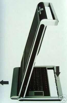

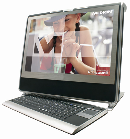

PC: Medion RIM2520 <-- Intel VIIV "standard"
Motherboard: ?? "rim 2520"
CPU: Intel® Yonah® Core Duo 1.66Ghz (T2300)
Chipset: intel 945GM / ICH7
Graphics: (0x01d8) GeForce Go 7400 / Quadro NVS 120M
  • VRAM: 128MB + 128MB shared
  • 1440x900 (WXGA/WXGA+/WSXGA)
WLAN: Intel Pro/Wireless 3945 Wireless LAN (802.11a/b/g) <-- not working
Kallyway 10.5.1, EFi, GUID, 10.5.2 Update, Graphics Update [i guess here is the error.... i could kill me *g*]
Age: 16,5 *g*
