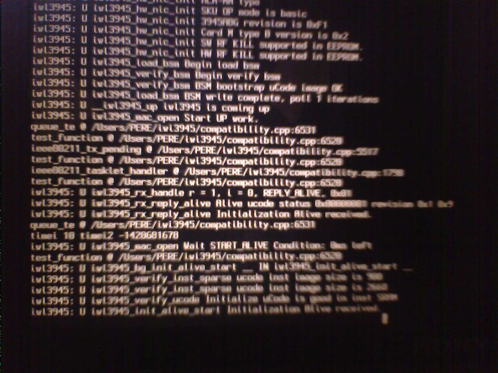

pere Posted April 27, 2008 Share Posted April 27, 2008 iwi 3945 Rel 862. The reboot frozen issue came back, just could take pics. Attached kext. iwi3945.kext.zip Link to comment https://www.insanelymac.com/forum/topic/84072-intel-wireless-2100-2200bg-2915bg-3945abg-4965agn/page/66/#findComment-726158 Share on other sites More sharing options...

jalavoui Posted April 27, 2008 Author Share Posted April 27, 2008 pere, try a iosleep to fix that or comment this line tasklet_enable(&local->tasklet); iwi4965 rel 864 the driver wants to send a pakcet maybe you get a kp Link to comment https://www.insanelymac.com/forum/topic/84072-intel-wireless-2100-2200bg-2915bg-3945abg-4965agn/page/66/#findComment-726173 Share on other sites More sharing options...
pere Posted April 27, 2008 Share Posted April 27, 2008 pere,try a iosleep to fix that iwi4965 rel 864 the driver wants to send a pakcet maybe you get a kp Iosleep set to 2000, could boot, log attached, Ucode error, but seems finally recovered from error and started ok. reboot.txt Link to comment https://www.insanelymac.com/forum/topic/84072-intel-wireless-2100-2200bg-2915bg-3945abg-4965agn/page/66/#findComment-726181 Share on other sites More sharing options...
