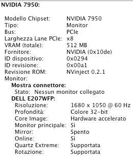

IronFly Posted April 5, 2008 Share Posted April 5, 2008 ok i understand that we need to put the ID of the GPU in the nvinject.kext and some other files. now i can see the right resolution but i have corrupted graphic. need to understand what other files need to be corrected. Link to comment https://www.insanelymac.com/forum/topic/82847-xfx-geforce-7950-gx2-xxx-1024gb/#findComment-696884 Share on other sites More sharing options...
IronFly Posted April 5, 2008 Share Posted April 5, 2008 no quartz extreme but 1680x1050@32 available. just copy this kexts from /system/library/extensions to your desk and open them: nvinject NVDAresman NVDANV40hal open the info.plist with PlistEdit PRO and search this string: IOPCIPrimaryMatch edit the value before the 10de with your device ID: this from mine XFX 7950 gx2 m520 Modello Chipset: 7950 gx2 Tipo: Monitor Bus: PCIe Larghezza Lane PCIe: x8 VRAM (totale): 512 MB Fornitore: NVIDIA (0x10de) ID dispositivo: 0x0294 save the modifies and install the edited kexts with kext helper b7.....reboot and enjoy. Link to comment https://www.insanelymac.com/forum/topic/82847-xfx-geforce-7950-gx2-xxx-1024gb/#findComment-697027 Share on other sites More sharing options...
IronFly Posted April 6, 2008 Share Posted April 6, 2008 mmmm when i try to put GEforce.kext (Leo graphic update 1.0) with the correct ID, it boots but i got a black desktop with 2 mouse pointer... any help? i edited also NVDANV50hal.kext but with no luck. Link to comment https://www.insanelymac.com/forum/topic/82847-xfx-geforce-7950-gx2-xxx-1024gb/#findComment-698195 Share on other sites More sharing options...
IronFly Posted April 6, 2008 Share Posted April 6, 2008 OK gotcha!!!! first delete every nvida/geforce driver from your extensions folder. then download .41 nvinstaller http://scottdangel.com/blog/?p=23 and with PACIFIST extract: NVDANV10Hal.kext NVDANV20Hal.kext NVDANV30Hal.kext NVDANV40Hal.kext NVDANV50Hal.kext NVDAResman.kext GeForce.kext NVinjext.kext (use the 512mb version or try the Vanilla 256mb version....but you need to edit the VRAM). open the .kext and open Info.plist, with PLISTeditor PRO and search/edit this string in EVERY kexts with your GPU DEVICE ID (mine is: 0x0294): IOPCIMatch string YOURDEVICEID10de 10de is standard for all the Nvidia GPU. save it. if you use the Vanilla NVinject.kext version you must add a sting under "entries to add": VRAM,totalsize DATA 00000020 00000020 is 512mb see here for infos: http://nvinject.free.fr/downloads.php scroll down. after you edited/saved all the files, launch the NVInstaller v.41 and install just the latest kexts and framework (so, if i understand correctly, you have the leo graphic update). ok now with kext helper install your kexts!!! once done, reboot and enjoy. i hope it will run as me. BTW this on LEO4ALL v2 version with Vanilla 9.2.2!!! Thanks MASTER EDDIE11C!!! Link to comment https://www.insanelymac.com/forum/topic/82847-xfx-geforce-7950-gx2-xxx-1024gb/#findComment-698634 Share on other sites More sharing options...

IronFly Posted April 6, 2008 Share Posted April 6, 2008 Is then QE enabled? YES! Link to comment https://www.insanelymac.com/forum/topic/82847-xfx-geforce-7950-gx2-xxx-1024gb/#findComment-698803 Share on other sites More sharing options...
x0a Posted April 6, 2008 Share Posted April 6, 2008 open the .kext and open Info.plist, with PLISTeditor PRO and search/edit this string in EVERY kexts with your GPU DEVICE ID (mine is: 0x0294): IOPCIMatch string YOURDEVICEID10de Mine looks like this: Bevore: 0x020010de&0xfff8ffff 0x025010de&0xfff8ffff 0x028010de&0xfff8ffff After: 0x029410de&0xfff8ffff 0x029410de&0xfff8ffff 0x029410de&0xfff8ffff and i have the same ID as you and the vanilla kext. Where I have to add the String for the Vanilla kext? Only in the NVinject? Thanks Link to comment https://www.insanelymac.com/forum/topic/82847-xfx-geforce-7950-gx2-xxx-1024gb/#findComment-698987 Share on other sites More sharing options...
IronFly Posted April 6, 2008 Share Posted April 6, 2008 just put: 0x029410de nothing else. the vanilla nvinject.kext need to add a string for the 512mb ram or the default is 256mb. you must add: VRAM,totalsize in the first column DATA in the second column 00000020 in the third column Link to comment https://www.insanelymac.com/forum/topic/82847-xfx-geforce-7950-gx2-xxx-1024gb/#findComment-699053 Share on other sites More sharing options...
