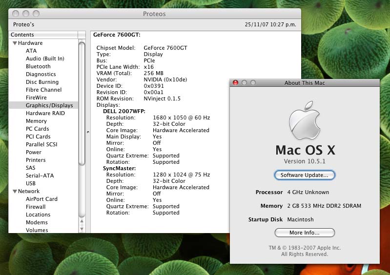

Proteo Posted November 26, 2007 Share Posted November 26, 2007 NVinject does not work with a 7600gt Untrue: Link to comment Share on other sites More sharing options...

Proteo Posted November 26, 2007 Share Posted November 26, 2007 Does your mouse cursor have a shadow under it? Yes. And can you run the Shell screensaver for a couple minutes without it crashing to a bluescreen? Absolutely. Link to comment Share on other sites More sharing options...
