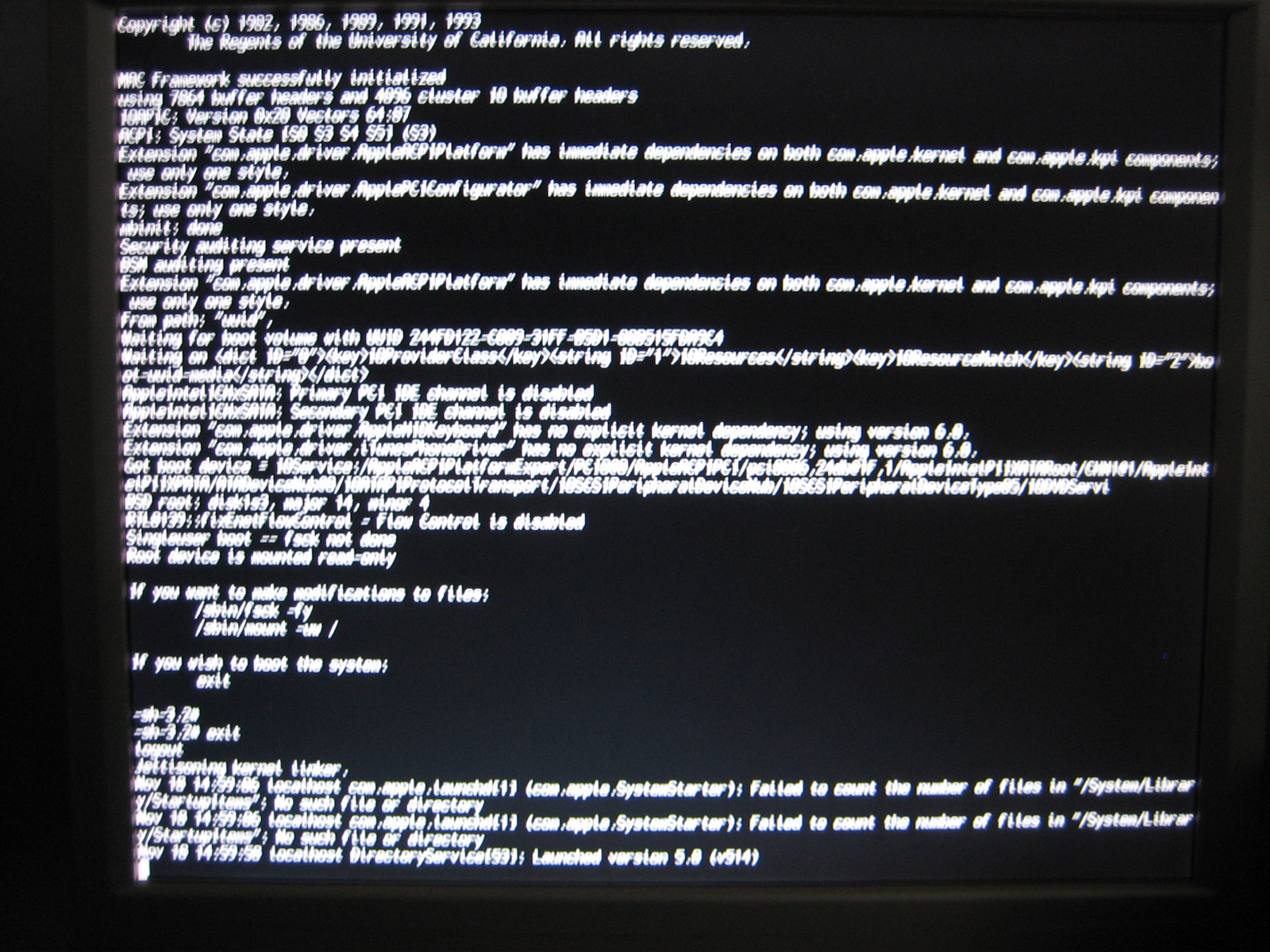

Eldrial Posted November 18, 2007 Share Posted November 18, 2007 I have the same problem. While it was booting, it got an error saying something like: Error Counting Item in /System/StartupItems: No Such Directory. That was with ISO downloaded from Pirates and burned with Nero. I tried again by burning the ISO using Disk Utility, but it doesn't boot at all with that. Need help! Link to comment https://www.insanelymac.com/forum/topic/71908-toh-rc2-dvd-wont-boot/#findComment-510128 Share on other sites More sharing options...

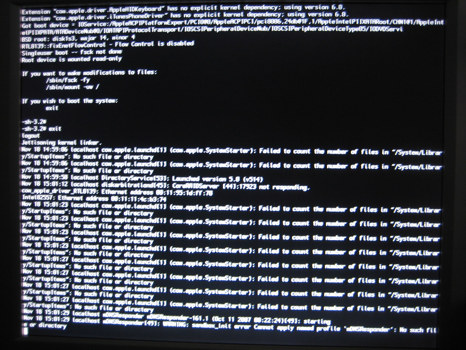

Eldrial Posted November 19, 2007 Share Posted November 19, 2007 Here are images of the error I receive. Link to comment https://www.insanelymac.com/forum/topic/71908-toh-rc2-dvd-wont-boot/#findComment-511157 Share on other sites More sharing options...

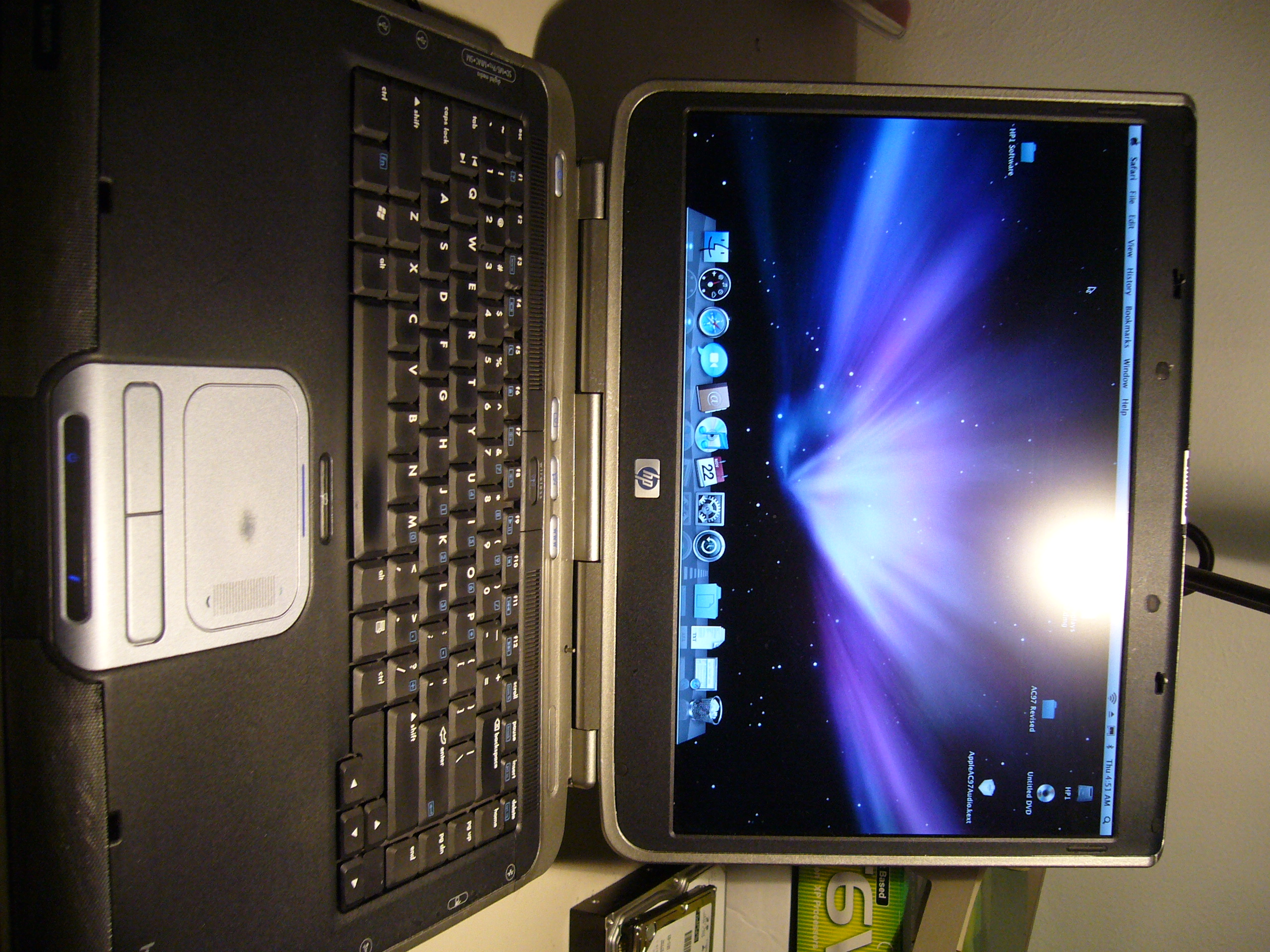

schmiede Posted November 22, 2007 Share Posted November 22, 2007 Here's a fix that worked for me. A. Clean install of JaS 10.4.8. (10.4.6 worked for me as well on a second machine.) B. Enter an administrative name and password when prompted toward the end of the install. C. Go right to System Preferences > Accounts > Login Options - Open the lock with your system Admin name and password - Disable "Login Automatically" - Check "List of Users" radio button - Check "Show the restart, sleep , and shutdown buttons - make sure all other buttons are unchecked. D. Insert Leopard install disk, open, and double click install icon - When prompted click "Install" - you must then enter your admin name and password. After that the system will reboot. E. When the system reboots, the Install OSX prompt will appear. Hit the enter button right away, and the UPGRADE install process will begin. F. Follow the install prompts after the blue screen appears. After disk integrity check, Leopard will begin to install to the hard disk. IMPORTANT: Stay at your machine while the blue status bar moves forward, and move your mouse around a bit every couple of minutes. If you don't do this the system may try to go to sleep, your installation will freeze and may fail. G. When the system has installed, allow your machine to reboot. You will get a plain grey screen for a (long) while, and after some time, BINGO!!! Leopards cosmic background will appear with a login window. G1. If you followed the instructions in section "C.", after you log in, Leopard will unfold on your screen. If you did not follow the instructions in "C." , you may still get a login window, BUT the system won't know who you are, and will refuse to let you in. If this happens, erase your disk, start at "A." - and follow ALL the instructions this time! After a successful install Leopard should boot sweetly every time without any hacks or other nonsense. As I said, this has worked very well for me. I hope it works for you too! Link to comment https://www.insanelymac.com/forum/topic/71908-toh-rc2-dvd-wont-boot/#findComment-515163 Share on other sites More sharing options...
schmiede Posted November 22, 2007 Share Posted November 22, 2007 Sorry - Forgot to add system information, HP Pavillion ZX 5000 Notebook 3.2GHZ Prescott mobile processor, SSE3 HTT 1 GB DDR 2700 Ram ATI 9200 Mobility 64MB @ 1200 x800X32 with Callisto b003_Fixed (Followed Omni's instructions) NEC DVD/CD 8X +/- R RW DL - Working with patch recommended HCL 10.4.6 Hitachi 160 GB HD 5400 rpm USB 2.0 working "out of box" Firewire working "out of box" Ethernet working "out of box" Wireless G working "out of box" Sound - not yet working. About this Mac: "Model Name: Mac Model Identifier: ACPI Processor Name: Mobile Intel® Pentium® 4 CPU Processor Speed: 3.2 GHz Number Of Processors: 1 Total Number Of Cores: 1 L2 Cache: 512 KB CPU Features: FPU VME DE PSE TSC MSR PAE MCE CX8 APIC SEP MTRR PGE MCA CMOV PAT PSE36 CLFSH DS ACPI MMX FXSR SSE SSE2 SS HTT TM SSE3 Memory: 1 GB Bus Speed: 200 MHz" DVD issues: I patched DVD in 10.4.6, started the install from the native drive, as soon as I got a "waiting for root" message, I popped the DVD out of the native drive, put it in an external USD drive, made sure the drive was powered up, and plugged the USB cable into an open USB port on the computer. The system recognized it immediately and continued with the install. I have read of others doing the entire install from an external DVD drive. Link to comment https://www.insanelymac.com/forum/topic/71908-toh-rc2-dvd-wont-boot/#findComment-515201 Share on other sites More sharing options...

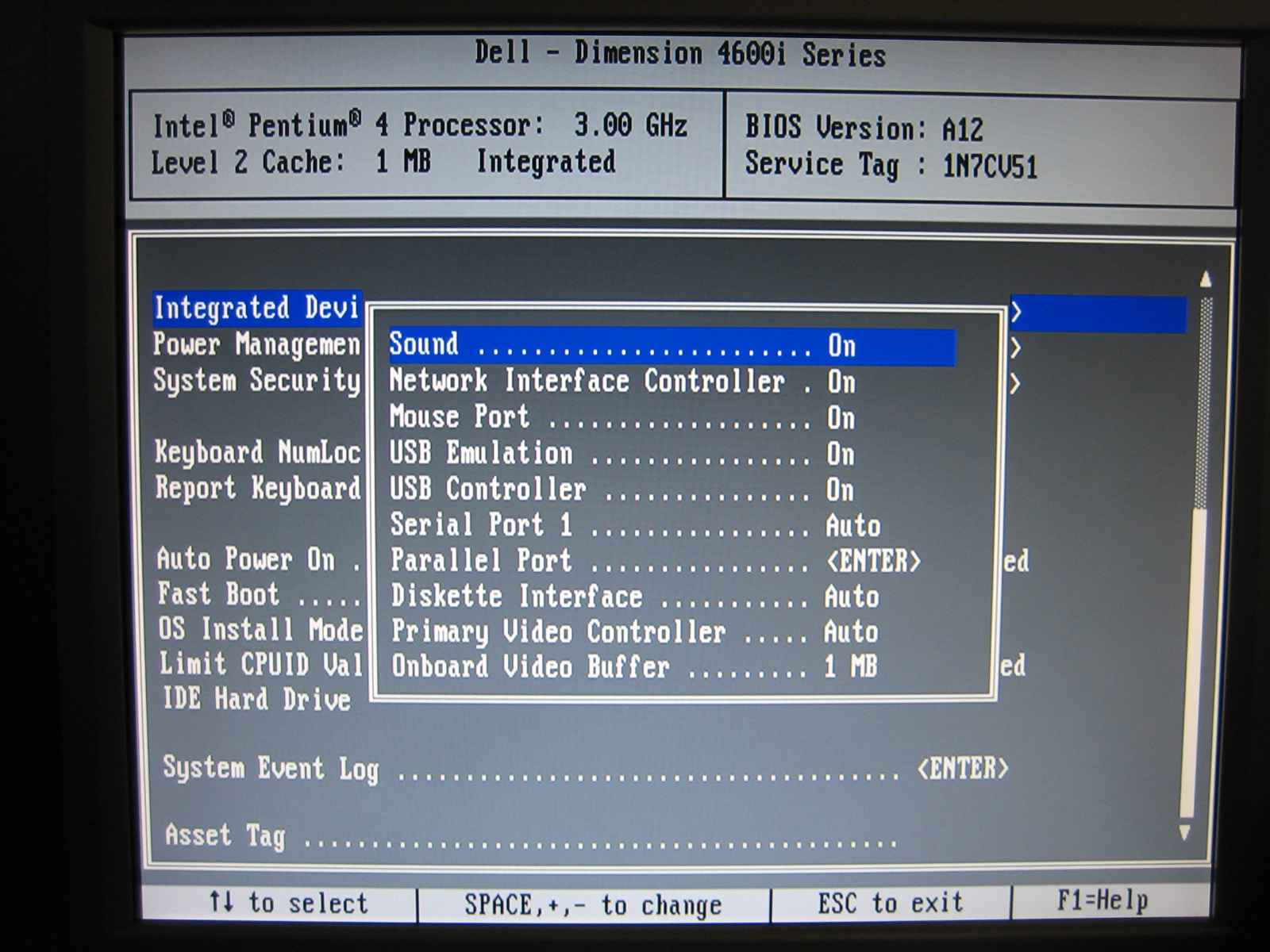

Eldrial Posted November 24, 2007 Share Posted November 24, 2007 maniac20 suggested that, and I tried it, but to no avail. I am not sure if I am turning the right thing off though, in the BIOS (I turned off Network Interface Controller). Here's an image showing the options. I have a Dell Dimension 4600 if anyone knows more about disabling the ethernet on it. Link to comment https://www.insanelymac.com/forum/topic/71908-toh-rc2-dvd-wont-boot/#findComment-516662 Share on other sites More sharing options...
schmiede Posted November 24, 2007 Share Posted November 24, 2007 Not sure about the network card. Anything is worth trying at least once though. Looks like setup sees your neworkcard just fine and assigns a mac address with no issues. For the record, I got the same message you have gotten repeatedly until I broke down, wiped the hard disk clean, formated again with hfs, and did a vanilla install of 10.4.8. (or 10.4.6 on the old HP laptop). Unless your DVD drive isn't working, don't attempt to install any patches before installing Leopard. OSX 10.5 will overwrite any patches you have made, and you will have to install them on the fresh system. It looks as if you are hitting F8 before install. Don't! As soon as you get a darwin screen with a prompt, hit enter or almost any other ket but F8. Check your dvd to make sure it won't work better as a coaster. Again, If you already have an install that refuses to upgrade, you will get no joy unless you start from scratch. Even then, there is no guarantee that you system will run Leopard. You have a P4 processor. Most P4's have only up to SSE2 capabilities. Leopard requires SSE3. Check your processor specifications. If it doesn't have a processor with SSE3, Leopard wont run on your machine. I swapped out an older Northridge processor (SSE2), for a Prescott with SSE3 to get Leopard running on my old machine. Before you try anything else I suggest you check to see what model processor your machine uses. Link to comment https://www.insanelymac.com/forum/topic/71908-toh-rc2-dvd-wont-boot/#findComment-516976 Share on other sites More sharing options...
Eldrial Posted November 24, 2007 Share Posted November 24, 2007 Yeah. I turn off the Network Interface Controller, but it can still read my MAC Address, and I think that is what causes the problem. What is a Vanilla install of 10.4.8? I think my DVD is good. I checked with someone else with the size, and they're exactly the same and it boots and everything. I'm thinking it's my computer. I didn't hit F8 at the prompt—I was just describing the prompt that came up. I hit a key and the screen starts listing all the kexts being loaded from the DVD and eventually gets to the error. I am pretty sure my computer is SSE3. I haven't checked in a long time though, since I don't have Windows to check with CPU-Z. Is there any way checking from a Mac? I suppose the problem might be that I am not doing it from a fresh install, but I don't think that it would make much of a difference because after starting the installer from OS X, it just restarts and boots from the DVD normally seemingly without difference. It just boots to the DVD and will probably get the same error, as it always does. I don't see what starting it from OS X would make a difference, since you told me to set the BIOS to boot from the DVD first. I'm probably being redundant, but that makes it just boot from the DVD as if I didn't start it from OS X, right? Thanks for all the help, by the way. I really appreciate it. Link to comment https://www.insanelymac.com/forum/topic/71908-toh-rc2-dvd-wont-boot/#findComment-517218 Share on other sites More sharing options...

Eldrial Posted November 24, 2007 Share Posted November 24, 2007 Ok. I gave it another fresh install, started the installer from the DVD, it restarted and booted from it, gave me the prompt to hit a key, I did. Started loading its kexts and everything, and got to the same error just as I thought it would. Link to comment https://www.insanelymac.com/forum/topic/71908-toh-rc2-dvd-wont-boot/#findComment-517474 Share on other sites More sharing options...
