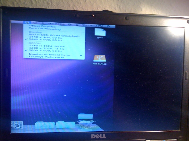

teufel2k Posted June 10, 2010 Share Posted June 10, 2010 Hi there, thanx for your help with all these dsdt hacks. Unfortunatly I stioll have the same problem. I tried the DualLink patch from above but it still not working. On my internal display which works under Linux and windows with 1440x900, only a half display is shown like my shot shows. But as you also see, the internal display resolution is correctly recognized, so I don't think that I have a problem with my EDID. On that external display x203h, everything works fine! Could you give me an advise what I can try next? Thanks, teufel2k Intel GMA X3100: Chipset Model: GMA X3100 Type: Display Bus: Built-In VRAM (Total): 144 MB Vendor: Intel (0x8086) Device ID: 0x2a02 Revision ID: 0x000c Displays: Display: Resolution: 1440 x 900 @ 60 Hz Depth: 32-Bit Color Core Image: Hardware Accelerated Mirror: Off Online: Yes Quartz Extreme: Supported Built-In: Yes X203H: Resolution: 1600 x 900 @ 60 Hz Depth: 32-Bit Color Core Image: Hardware Accelerated Main Display: Yes Mirror: Off Online: Yes Quartz Extreme: Supported Rotation: Supported And here my DDC block report: DDC block report generated by SwitchResX version 4.0.3 for display Unknown Monitor ----------------------------------------------------- ------------------- RAW DATA ------------------------ ----------------------------------------------------- 0 1 2 3 4 5 6 7 8 9 A B C D E F ----------------------------------------------------- 0 | 00 FF FF FF FF FF FF 00 06 AF 47 13 00 00 00 00 1 | 01 10 01 03 80 1E 13 78 0A 87 F5 94 57 4F 8C 27 2 | 27 50 54 00 00 00 01 01 01 01 01 01 01 01 01 01 3 | 01 01 01 01 01 01 9E 25 A0 40 51 84 0C 30 40 20 4 | 33 00 2F BD 10 00 00 19 5A 1F A0 40 51 84 0C 30 5 | 40 20 33 00 2F BD 10 00 00 00 00 00 00 FE 00 47 6 | 52 35 38 34 00 42 31 34 31 50 57 31 00 00 00 FE 7 | 00 28 38 44 4D 6D 96 B6 FF 02 01 0A 20 20 00 3A ----------------------------------------------------- < 00FFFFFF FFFFFF00 06AF4713 00000000 01100103 801E1378 0A87F594 574F8C27 27505400 00000101 01010101 01010101 01010101 01019E25 A0405184 0C304020 33002FBD 10000019 5A1FA040 51840C30 40203300 2FBD1000 00000000 00FE0047 52353834 00423134 31505731 000000FE 00283844 4D6D96B6 FF02010A 2020003A > ----------------------------------------------------- Valid EDID block: checksum passed ----------------------------------------------------- ------------------- MAIN EDID BLOCK ----------------- ----------------------------------------------------- EDID Version........1.3 Manufacturer........AUO Product Code........18195 (4713) (1347) Serial Number.......00000000 Manufactured........Week 1 of year 2006 Max H Size..........30 cm Max V Size..........19 cm Gamma...............2.20 Display Supported Features: --------------------------- Display type: ------------- RGB 4:4:4 & YCrCb 4:4:4 Color Encoding Formats Display is non continuous frequency Default color space is not sRGB standard Preferred timing mode includes Native Pixel Format Input signal & sync: -------------------- Digital Input Color Bit Depth is undefined Digital Interface is not defined Color info: ----------- Red x = 0.580 Green x = 0.310 Blue x = 0.155 White x = 0.313 Red y = 0.340 Green y = 0.550 Blue y = 0.155 White y = 0.329 Established Timings: -------------------- Manufacturer Reserved Timings: ------------------------------ Standard Timing Identification: ------------------------------- Monitor Description blocks: --------------------------- Descriptor #0 - Timing definition: Mode = 1440 x 900 @ 59.996Hz Pixel Clock............. 96.30 MHz Non-Interlaced Horizontal Vertical Active.................. 1440 pixels 900 lines Front Porch............. 64 pixels 3 lines Sync Width.............. 32 pixels 3 lines Back Porch.............. 224 pixels 6 lines Blanking................ 320 pixels 12 lines Total................... 1760 pixels 912 lines Scan Rate............... 54.716 kHz 59.996 Hz Image Size.............. 303 mm 189 mm Border.................. 0 pixels 0 lines Sync: Digital separate with * Negative vertical polarity * Negative horizontal polarity Descriptor #1 - Timing definition: Mode = 1440 x 900 @ 50.002Hz Pixel Clock............. 80.26 MHz Non-Interlaced Horizontal Vertical Active.................. 1440 pixels 900 lines Front Porch............. 64 pixels 3 lines Sync Width.............. 32 pixels 3 lines Back Porch.............. 224 pixels 6 lines Blanking................ 320 pixels 12 lines Total................... 1760 pixels 912 lines Scan Rate............... 45.602 kHz 50.002 Hz Image Size.............. 303 mm 189 mm Border.................. 0 pixels 0 lines Sync: Analog composite with Sync on green {...} Link to comment https://www.insanelymac.com/forum/topic/71784-leopard-laptops-with-non-working-gma-x3100/page/33/#findComment-1486265 Share on other sites More sharing options...
