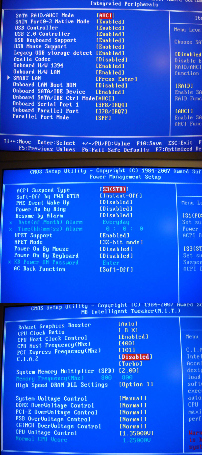

eclau Posted November 7, 2007 Share Posted November 7, 2007 Thanks! Everything works except wake from sleep. Build, Can you post your BIOS settings? I can seem to get sleep working properly (no wake). Thank you. Link to comment https://www.insanelymac.com/forum/topic/68532-gigabyte-p35-ds4-is-working-with-leopard-105/#findComment-498332 Share on other sites More sharing options...
hackcat Posted November 7, 2007 Share Posted November 7, 2007 In Bios I'm using 32bit HPET. Everything seems to be working really well including sleep. Build, just to confirm, you have kept AppleIntelCPUPowerManagement.kext in your extensions and have no HPET errors? I can't seem to make that work for me w the BrazilMac kernel. Is EIST enabled or disabled in your case? On another note, I found the simplest of fixes for my garbled video on wake. Move my DVI cable to the port closest to the motherboard and now I can wake from sleep with no video issues. I do get an invalid FireWire GUID on wake, and according to Gigabyte the F6 BIOS fixed wake from sleep and firewire problems. I'm using F7, but maybe this is still a BIOS issue. Using rev2.0 of the board. Link to comment https://www.insanelymac.com/forum/topic/68532-gigabyte-p35-ds4-is-working-with-leopard-105/#findComment-498406 Share on other sites More sharing options...
build Posted November 7, 2007 Author Share Posted November 7, 2007 Eclau, Here are my BIOS settings. hackcat, When I ran brazilmac's post patch I typed n (no) for AppleIntelCPUPowerManagement.kext Link to comment https://www.insanelymac.com/forum/topic/68532-gigabyte-p35-ds4-is-working-with-leopard-105/#findComment-498590 Share on other sites More sharing options...
