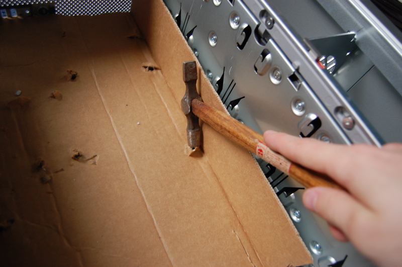

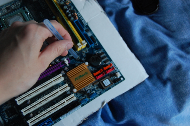

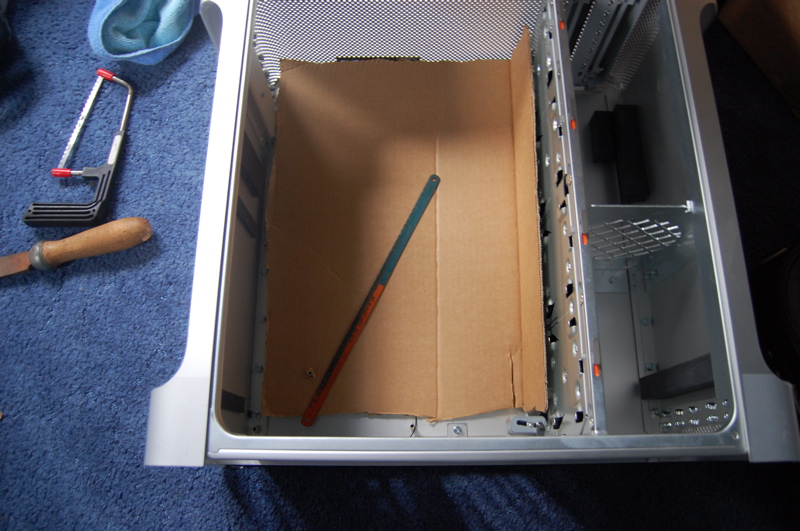

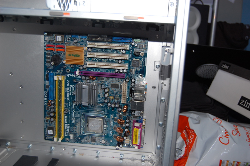

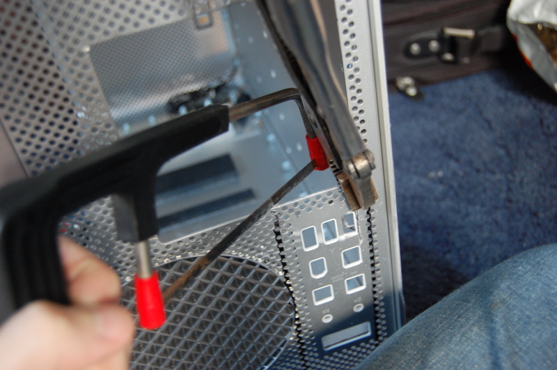

ZoidBergPro Posted July 2, 2007 Share Posted July 2, 2007 Ok, So, Here we go. I got one the other day from America, took a while to get here, but, its here! So, I started to look inside, and now I need a motherboard tray. I guess i will be spending more money on this, and then custom charges, so I'm going to save for bit. But, I had a quick go at the case. Step 1: Remove the existing MotherBoard Mounts. I tried this first with a blade, but failed badly, so I got a hammer and they came out very easily. Then, I took out the back panel, because it useless. I used mole-grips to hold the other-side, to stop it from cracking and snapping. I would advise this. :] Using cardboard, i marked the holes of the motherboard onto it, allowing me to mark in the case. I simple, (for a test) super-glued the motherboard mounts that came with the case onto the back and screwed the board on. The mounts are different heights, so i had to make sure that i was using the correct ones. More too come, if you would donate moneys, please pm me :] Zoid. Link to comment https://www.insanelymac.com/forum/topic/55943-how-fit-a-pc-inside-a-mac-pro-case/ Share on other sites More sharing options...
