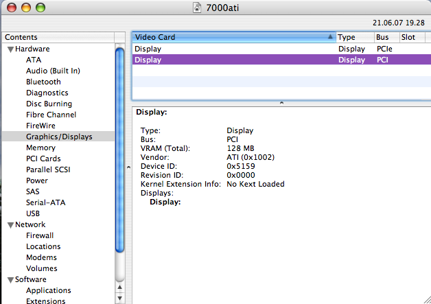

delish Posted June 21, 2007 Share Posted June 21, 2007 tiny update, the pc bios I flashed to appears to be too old, and that might be the problem, Vram not recogniced. the 7000 has a mac bios upgrade available to get it to work in "newer macs" (back to when G4 was new, hehe) the mac version of bios is 226, the pc one was first release one from techpowerup.com If I'll come across a newer pc bios I'll try again. edit, update: What you know, I found a newer pc bios for hynix vram. when I set gfx order in bios to pci -> pci-e it shows VESA 2.0 32mb I can boot from dvd and the installer shows up fine also, here is a systemprofiler pic from uphuck 1.2 funny it shows up as 128mb, hehe. booting from hd is the same as before, but I found out why I get blackscreen, system log says: Jun 21 19:33:17 localhost kernel[0]: ATY,Alopias: Not usable Jun 21 19:33:17 localhost kernel[0]: ATY,Alopias: Not usable so it appears as Jccool x19x0 drivers atleast doesn't work with 2 different gfx-card, since it tries to load the same driver for both. with my x1900xt as primary, osx boots and work fine, but no output from the 7000 as it doesn't show any vram. Jccool drivers are based on Natit, so is it Natit that doesn't load 2 different drivers when 2 different gfx-cards are installed maybe? Link to comment https://www.insanelymac.com/forum/topic/54282-dual-pcie-cards/#findComment-391370 Share on other sites More sharing options...
