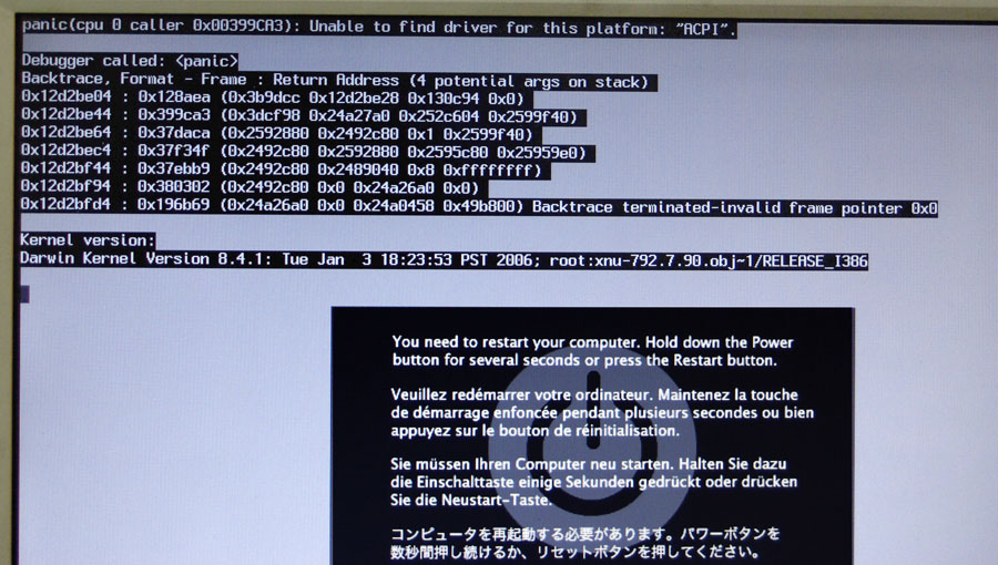

guks Posted April 28, 2007 Share Posted April 28, 2007 Hi Need help Machine COnfig as under AMD Athlon 3200+ CPU Asus A8N-VM Mother Board Bios 0506 Socket 939 Nvidia GE Force 6100 If i start installing the OS with my AMD 10.4.6 installation DVD I get a message Reboot to Install & do not move further to it. Please Help me ASAP Link to comment https://www.insanelymac.com/forum/topic/49648-unable-to-install-os-1046-on-amd/ Share on other sites More sharing options...

hecker Posted April 28, 2007 Share Posted April 28, 2007 Did you go through the genius bar, tutorial and faq sections yet? This is a very common problem and quite difficult to pinpoint if you don't know exactly how things are configured. Some of the things you might try: - Use IDE insted of SATA, if possible. - Always pin your IDE HDD to master (no cable select) - Remove any overclocking settings you may have in your BIOS - Enable ACPI - Do not combine PS2 with USB keyboards/mice Also, the DVD you are using is quite dated. Try downloading tubgirls 10.4.8 DVD; it works better for AMD systems. Good luck, hecker Link to comment https://www.insanelymac.com/forum/topic/49648-unable-to-install-os-1046-on-amd/#findComment-355092 Share on other sites More sharing options...

guks Posted April 29, 2007 Author Share Posted April 29, 2007 Hi Hacker I have checked all the suffs you had pointed & every thing is ok but even then I am getting error. Find attached the error I am getting. Await your advice. Link to comment https://www.insanelymac.com/forum/topic/49648-unable-to-install-os-1046-on-amd/#findComment-355551 Share on other sites More sharing options...

flashfile Posted April 30, 2007 Share Posted April 30, 2007 update bios to 0902 form website asus. good luck. Link to comment https://www.insanelymac.com/forum/topic/49648-unable-to-install-os-1046-on-amd/#findComment-356005 Share on other sites More sharing options...
guks Posted May 1, 2007 Author Share Posted May 1, 2007 This helped me but my ethernet is not working hence no internet. pls help. Also am looking for a OS 10.4.9 if possible on Rapidshare pls help Link to comment https://www.insanelymac.com/forum/topic/49648-unable-to-install-os-1046-on-amd/#findComment-356699 Share on other sites More sharing options...
