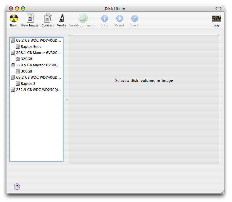

KasperNL Posted March 10, 2007 Share Posted March 10, 2007 On my Intel Bad-Axe 2 (D975XBX2/BOX) I have 8 Serial-ATA ports, the four ICH7R ports are working perfect (when setting the conroller to AHCI mode in the Bios). But the 4 additional ports on the Marvell 88SE6145 controller don't work correct. The most weird thing is that sometimes one of the connected disks shows up in Disk Utillity but without it's partitions etc. I allready tried installing the Silicon Image and the Highpoint driver (was meantioned on this forum).. The 250GB Western Digital Disk contains a 250GB HFS+ Journaled partition but it's not shown in Disk Util nor it mounts. This is one of the two disks connected to the Marvell controller. Link to comment https://www.insanelymac.com/forum/topic/44762-marvell-88se6145-sata-ii-contoller/ Share on other sites More sharing options...

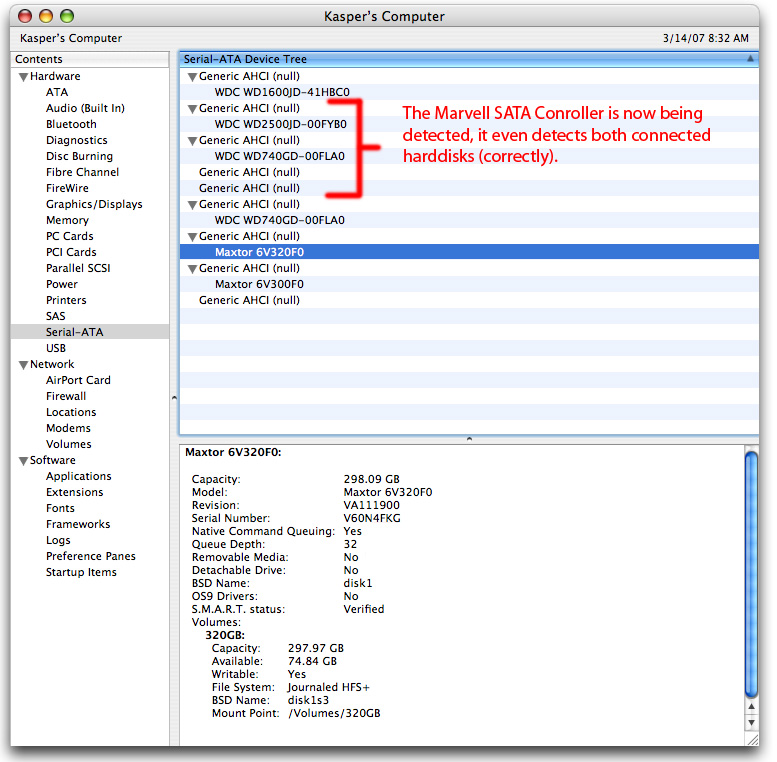

KasperNL Posted March 14, 2007 Author Share Posted March 14, 2007 (edited) I just updated to 10.4.9 with the latest Semthex kernel (being 8.8.1) and paulicat's 'AppleSMBIOS.kext' and 'IOATAFamily.kext'.. Now all the SATA controller ports (both Intel + Marvell) show up in the System Profiler, And the System Profiler even detects both Harddisks attached to the Marvell Controller.. But still no partitions are found/mounted.. But still this feels als a little improvement.. Anybody.... ideas? Edited March 14, 2007 by KasperNL Link to comment https://www.insanelymac.com/forum/topic/44762-marvell-88se6145-sata-ii-contoller/#findComment-323307 Share on other sites More sharing options...
KasperNL Posted March 14, 2007 Author Share Posted March 14, 2007 Some more information.. When looking in the System Profiler, I see that the Intel ICH7R shows up as: 'AHCI Version 1.10 Supported' while the Marvell shows up as: 'AHCI Version 1.00 Supported' What's the difference between these AHCI version? Already cheked WikiPedia (without success) and when Googling I only find pages about the System Profiler... Anybody? Link to comment https://www.insanelymac.com/forum/topic/44762-marvell-88se6145-sata-ii-contoller/#findComment-323335 Share on other sites More sharing options...
