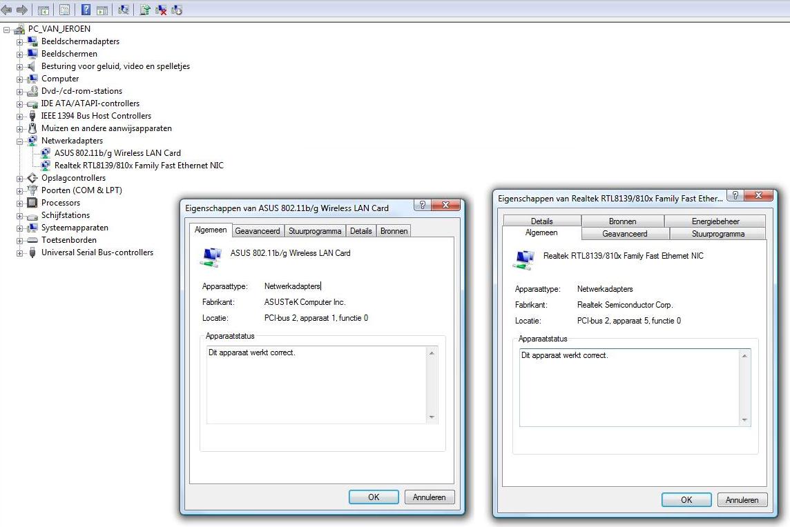

Bomans Posted April 29, 2008 Share Posted April 29, 2008 Kalyway 10.5.2 runs without problems on my packard bell iMedia. But I want to know if I can get my wifi working. Read thru this topic, but I didn't get much wiser Maybe cause I been using OS X for just 1 singele day now (in my whole life!) Can anyone tell me if my wifi will work? And what I have to do to get it to work?! See screenshot for little more info. Link to comment https://www.insanelymac.com/forum/topic/38223-pcgenrtl8139ethernet-v110-841-v120-881-released/page/4/#findComment-729356 Share on other sites More sharing options...
Bomans Posted April 30, 2008 Share Posted April 30, 2008 If someone wants more info. It's this computer http://support.packardbell.com/uk/item/ind...0310&g=1400 Link to comment https://www.insanelymac.com/forum/topic/38223-pcgenrtl8139ethernet-v110-841-v120-881-released/page/4/#findComment-729928 Share on other sites More sharing options...
