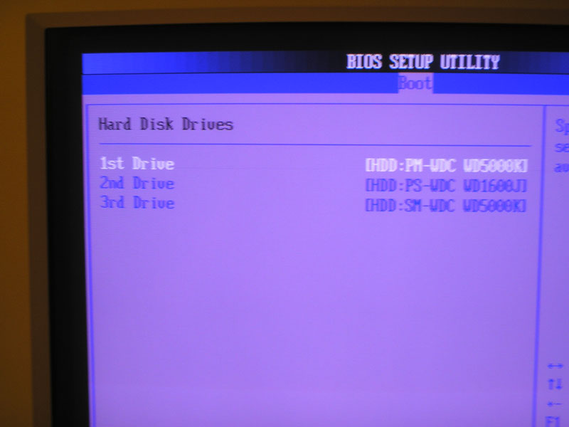

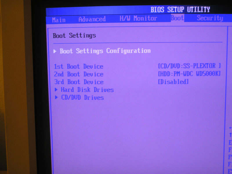

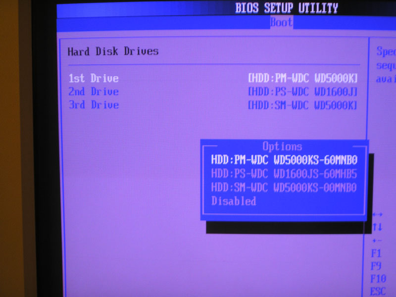

These are shots from an ASROCK board. Each board/bios is a little different but not that much. The first shot (#1)(under the "boot" tab) is like what you described, a list of devices that you can't move or edit. I have my Plextor DVD looked at 1st followed by my WD 500GB Windows Drive. 3rd boot is disabled. What you need to note is below all of that. Hard Disk Drives with the little arrow by it? That is where you go next. Selecting that brings up screen shot (#2). This is a list of the Hard drives on the system. 500GB, 160GB, and 500GB's. In the third screen shot (#3), I have selected the 1st drive (500GB) and it has pulled a list that I can shift it up or down in the priority.

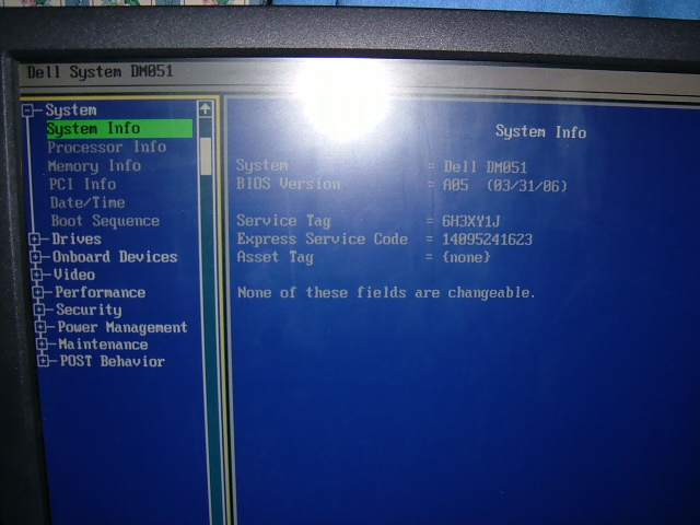

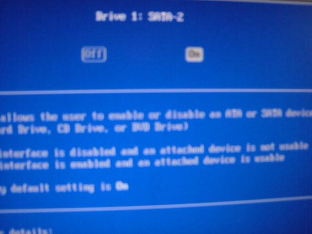

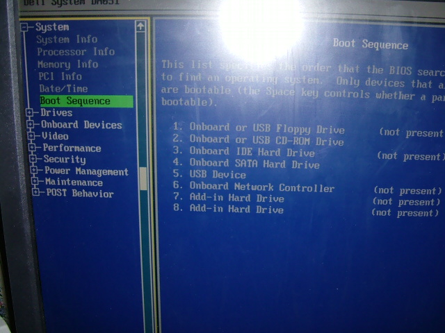

here is my bios (its my friends cam so i didnt know how to switch the flash off):
-STUFF IN BOLD ARE PICTURE NAMES-
First of all i repeatedly click F2 to "enter setup"
The first thing i see is picture "First Menu"
Then i scroll down to "boot sequence" as any normal person would do in this situation and i click "enter/return" on it and recieve this screen: "Boot Sequence". In this menu you can only move device sections, not the actual devices up/down the boot priority list.

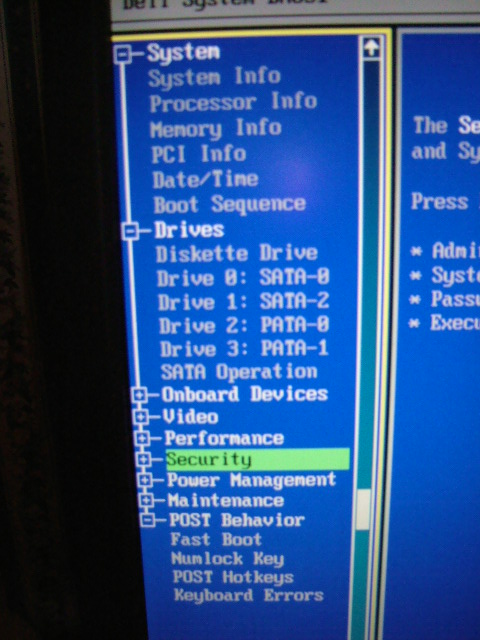

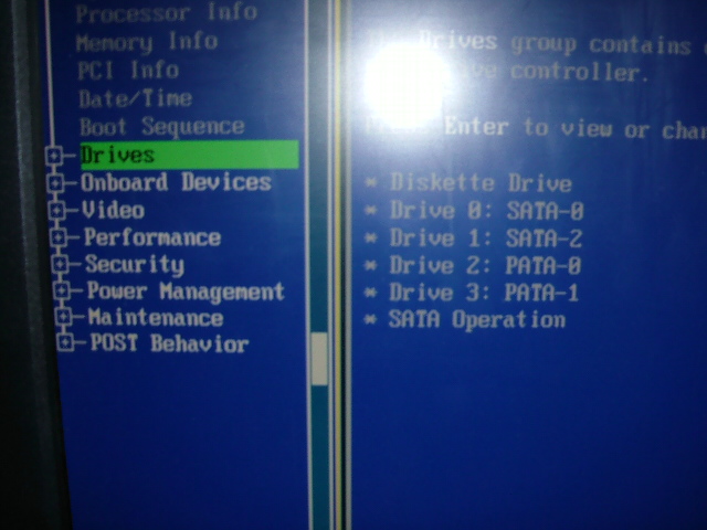

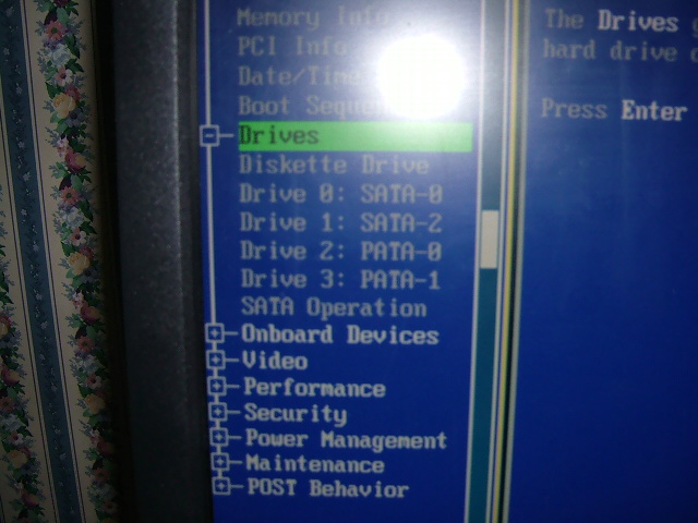

So then i scroll down to "Drives" to see what magical goodies i find in here ("Drives List", and when i click "enter/return" i get "Drives List In Menu")
But i am only to be dissapointed because when i click on a drive i only get 1 option - "Only Option When clicking on a drive" pic. BTW my mac drive is turned off bcos it always takes first place infront of my windows drive. <-- this is my problem)

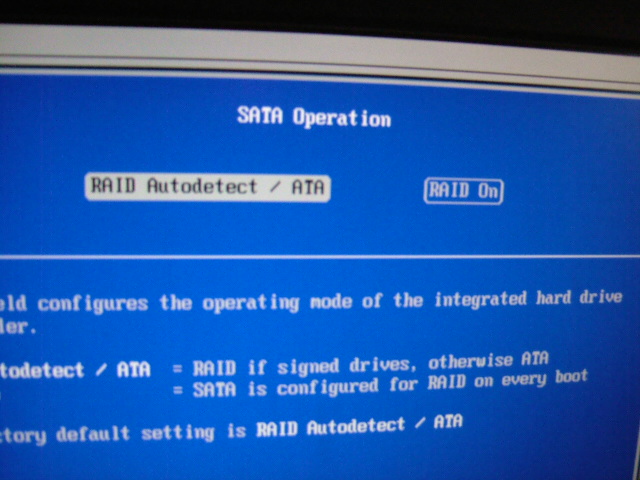

Finally after sheer dissapointment i get to my last menu that says "click me" which is SATA Operation...see the pic.
You can then see the "Rest of my Bios" menu to fiddle about with if you want to.
Pic list is in order 1 going to 7th i think.

OK, I know that this is frustrating for you. The PATA is your CD/DVD. I wish I had this BIOS handy to play with. There will be a screen somewhere in there that will list your SATA drives by there model number (see my screeny #2). That sub-list is sortable. I have never seen a BIOS without one but I suppose that its possible that it just doesn't exist. Sort through every line item. Click the plus (+) signs beside them, read every pane to the right with it's options, leave no stone unturned. That is about all I can offer at this time.
