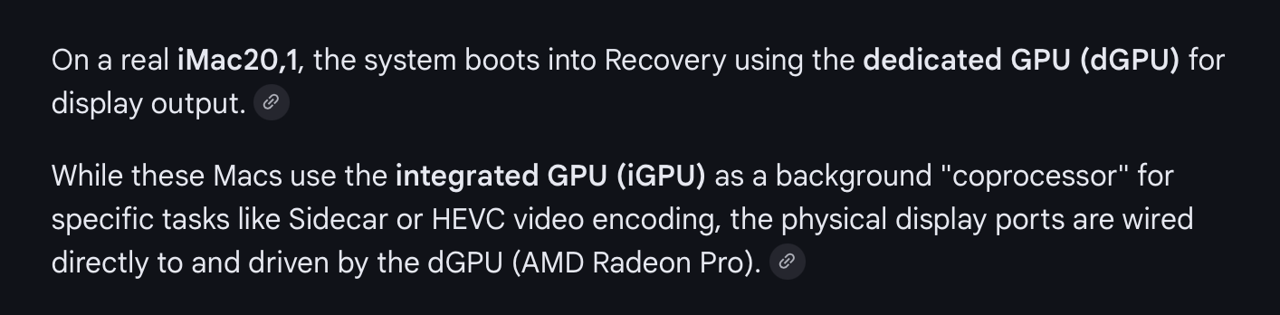

arsradu Posted April 19 Author Share Posted April 19 (edited) 3 hours ago, XanthraX said: As far as I know, real Macs boot in recovery mode with the igpu. I don't know how it is in Mac Pros. I don't think it is other solution for us. Unfortunately. That's why I avoided to boot in recovery mode. If someone can make a solution to boot in recovery mode from the RX, it would be a real achievement. I mean, there is a way... Using the agdpmod=pikera boot arg. :)) Other than that...I don't know. Also, I used to think so too (that real Macs use the iGPU for low level stuff)... However, Google seems to have a different opinion. Now, of course, just like ChatGPT, it also lied to me before. So...not sure if I should trust it or not. After all, that's why I decided to open up this topic in the first place. :)) Edited April 19 by arsradu Link to comment https://www.insanelymac.com/forum/topic/362665-solved-attempting-to-fix-black-screen-in-recovery-mode-without-agdpmodpikera/#findComment-2849291 Share on other sites More sharing options...
