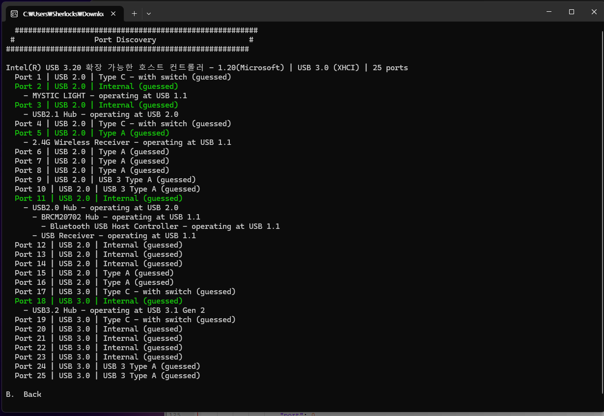

pio Posted June 5 Share Posted June 5 13 hours ago, Sherlocks said: Yes i just test for brcm kext. Now disabled kext in attached config.plist. airportbrcmfixup too. I also remapped usb port from windows. https://github.com/perez987/USB-ports-map-for-macOS-with-USBToolBox But as result, both usbtoolbox and usbinjectall with ssdt is same.🥲 I prefer to use usbinjectall. So now i use it I will try to remap usb again Usb power management? SSDT-USBX? In windows 11, i don't have problem. I think there was some confusion here. I wasn’t talking about SSDT-USBX, just the USB header cable on the PCIe card. If USBToolBox and USBInjectAll both act the same, and it works fine in Windows, I'd still check the USB map in macOS. Worth trying a fresh remap on Tahoe just to rule it out. Also check if the Bluetooth USB device actually shows up after boot. Had a similar issue before and just unplugging/replugging the PCIe USB cable fixed it. P.S. 혹시 Tahoe로 오시면서 기본에 사용하시던 USB매핑 kext 수정하셧나요? Tahoe에서 USB 스택 쪽이 좀 바뀌면서 예전 방식 USB 매핑이 안 맞는 경우도 있는 것 같습니다. 1 Link to comment https://www.insanelymac.com/forum/topic/362501-release-hackintosh-and-beyond-auxiliary-kexts-v110-real-hardware-level-watchdogs-for-wi-fi-bluetooth/page/2/#findComment-2850869 Share on other sites More sharing options...

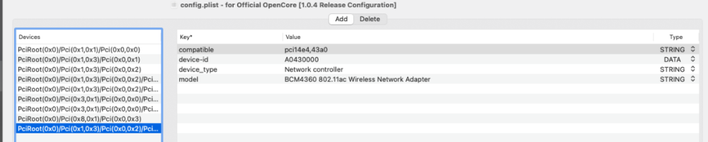

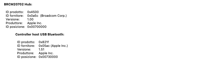

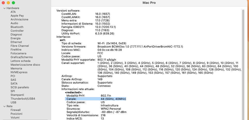

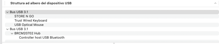

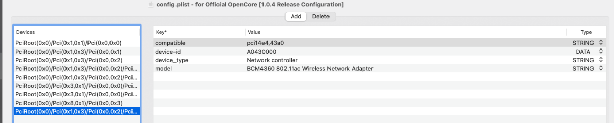

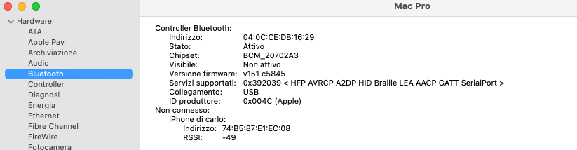

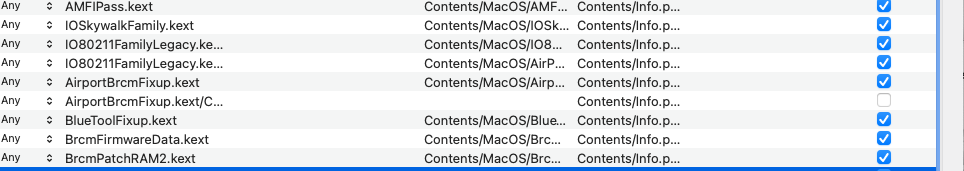

carlo_67 Posted June 5 Share Posted June 5 I found this card inside a 2012 MacBook Air, bcm943224pciebt2, which is old and native up to Catalina. I bought an M2 to mini PCI adapter and installed it in my AMD card. I'm using OCLP-Mod and these kexts: IOSkywalkFamily - IO80211FamilyLegacy + block. I also used the old AirportBrcmFixup, removing the AirPortBrcmNIC_Injector and AirPortBrcm4360_Injector.kext plugins, loading only the kext. In the device properties of the OC card, I set the Spoof Device-id. data A0430000 compatible string pci14e4,43a0 The bootarg and kext for BT are in the screenshot. I use it on my AMD and it works. Tahoe 26.5.1 Maybe it could be useful. 2 Link to comment https://www.insanelymac.com/forum/topic/362501-release-hackintosh-and-beyond-auxiliary-kexts-v110-real-hardware-level-watchdogs-for-wi-fi-bluetooth/page/2/#findComment-2850876 Share on other sites More sharing options...

Mirone Posted June 6 Share Posted June 6 @Sherlocks, Could you send me your complete EFI folder? If you'd rather not post it here, feel free to send it to me via PM. Please also send me the USB kext you mapped using USBToolBox. I took a look at the GitHub repository you mentioned, and honestly, I didn't need to use many of the things listed there to get either my BCM4352 or BCM4360 working. Regarding the Bluetooth issue after sleep, I had already tried several approaches, including the BlueToolFixup boot arguments. In the end, I decided to analyze the bluetoothd daemon to address the problem directly, and so far the results have been very good on both Sonoma and Sequoia. Actually, I only noticed this behavior of Bluetooth remaining disabled after sleep with my BCM4352. On the BCM4360, Bluetooth was always enabled and working properly after waking from sleep. I haven't tested AirDrop, though. 18 hours ago, carlo_67 said: This didn't work for me but I'm continuing to try anyway thanks Have you tested the BlueToolFixup version I posted here? Do you have any issues with Bluetooth not being re-enabled after waking from sleep? 1 Link to comment https://www.insanelymac.com/forum/topic/362501-release-hackintosh-and-beyond-auxiliary-kexts-v110-real-hardware-level-watchdogs-for-wi-fi-bluetooth/page/2/#findComment-2850898 Share on other sites More sharing options...
Sherlocks Posted June 6 Share Posted June 6 1 hour ago, Mirone said: @Sherlocks, Could you send me your complete EFI folder? If you'd rather not post it here, feel free to send it to me via PM. Please also send me the USB kext you mapped using USBToolBox. I took a look at the GitHub repository you mentioned, and honestly, I didn't need to use many of the things listed there to get either my BCM4352 or BCM4360 working. Regarding the Bluetooth issue after sleep, I had already tried several approaches, including the BlueToolFixup boot arguments. In the end, I decided to analyze the bluetoothd daemon to address the problem directly, and so far the results have been very good on both Sonoma and Sequoia. Actually, I only noticed this behavior of Bluetooth remaining disabled after sleep with my BCM4352. On the BCM4360, Bluetooth was always enabled and working properly after waking from sleep. I haven't tested AirDrop, though. Have you tested the BlueToolFixup version I posted here? Do you have any issues with Bluetooth not being re-enabled after waking from sleep? please check pm here is usb in windows. now i don't have usb stick. sorry usb.json 2 Link to comment https://www.insanelymac.com/forum/topic/362501-release-hackintosh-and-beyond-auxiliary-kexts-v110-real-hardware-level-watchdogs-for-wi-fi-bluetooth/page/2/#findComment-2850899 Share on other sites More sharing options...

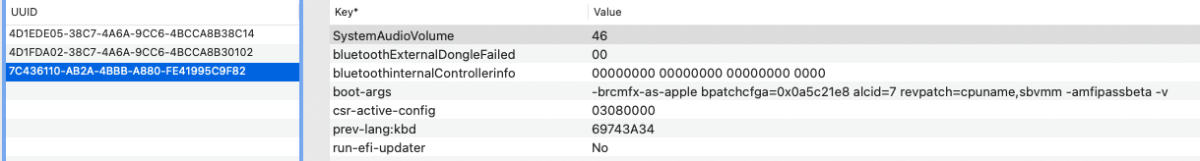

carlo_67 Posted June 7 Share Posted June 7 Il 06/06/2026 alle 09:59, Sherlocks ha detto: -btlfxnvramcheck, it is not working. i find info https://github.com/vluncasu/BCM94360-Sonoma-Fix i will test it. and the same one I indicated above, I only changed bootarg -brcmfx-as-apple It tells the kext (variant related to AirportBrcmFixup or BrcmPatchRAM) to mask the third-party Bluetooth controller, bpatchcfga= Stands for Bluetooth Patch Configuration (or similar firmware configuration string for BrcmPatchRAM). It tells the driver to apply a specific firmware patch directly to the following hardware ID. Hardware Identifier: (0x0a5c21e8) Represents the unique device IDs expressed in hexadecimal format: 0A5C: This is the Vendor ID and corresponds to Broadcom. 21E8: This is the Product ID and corresponds to the BCM20702A0 chip. and then use AirportBrcmFixup.kext, without loading the plugins, and when I wake up everything works normally 2 Link to comment https://www.insanelymac.com/forum/topic/362501-release-hackintosh-and-beyond-auxiliary-kexts-v110-real-hardware-level-watchdogs-for-wi-fi-bluetooth/page/2/#findComment-2850906 Share on other sites More sharing options...
Sherlocks Posted June 7 Share Posted June 7 4 hours ago, carlo_67 said: and the same one I indicated above, I only changed bootarg -brcmfx-as-apple It tells the kext (variant related to AirportBrcmFixup or BrcmPatchRAM) to mask the third-party Bluetooth controller, bpatchcfga= Stands for Bluetooth Patch Configuration (or similar firmware configuration string for BrcmPatchRAM). It tells the driver to apply a specific firmware patch directly to the following hardware ID. Hardware Identifier: (0x0a5c21e8) Represents the unique device IDs expressed in hexadecimal format: 0A5C: This is the Vendor ID and corresponds to Broadcom. 21E8: This is the Product ID and corresponds to the BCM20702A0 chip. and then use AirportBrcmFixup.kext, without loading the plugins, and when I wake up everything works normally Can you upload kext or config? 1 Link to comment https://www.insanelymac.com/forum/topic/362501-release-hackintosh-and-beyond-auxiliary-kexts-v110-real-hardware-level-watchdogs-for-wi-fi-bluetooth/page/2/#findComment-2850909 Share on other sites More sharing options...

Mirone Posted June 7 Share Posted June 7 @carlo_67, I tried your method but unfortunately it didn't work for my BCM4352. 1 Link to comment https://www.insanelymac.com/forum/topic/362501-release-hackintosh-and-beyond-auxiliary-kexts-v110-real-hardware-level-watchdogs-for-wi-fi-bluetooth/page/2/#findComment-2850920 Share on other sites More sharing options...
carlo_67 Posted June 8 Share Posted June 8 @Mirone put the correct device-id of your device 4352 (Key) Type. Value device-id Data. B1430000 compatible String pci14e4,43a0 1 Link to comment https://www.insanelymac.com/forum/topic/362501-release-hackintosh-and-beyond-auxiliary-kexts-v110-real-hardware-level-watchdogs-for-wi-fi-bluetooth/page/2/#findComment-2850933 Share on other sites More sharing options...
