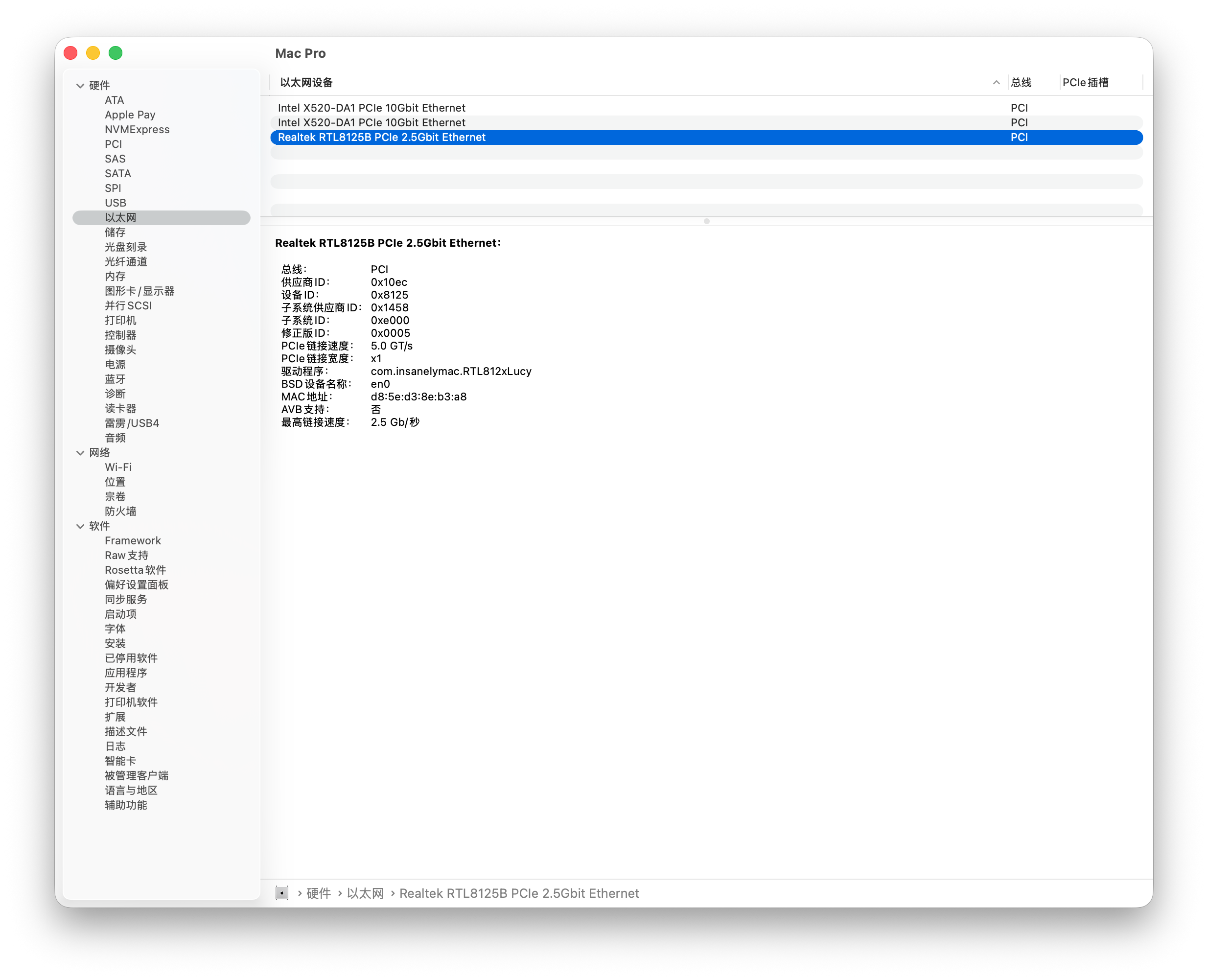

Test: Gigabyte Z690 Gaming X with RTL812xLucy.kext V1.0.2
Spoiler
Last login: Sun Feb 15 16:19:10 on ttys006
fabiomn@Mac-Pro ~ % ifconfig en0
en0: flags=8863<UP,BROADCAST,SMART,RUNNING,SIMPLEX,MULTICAST> mtu 1500
    options=40b<RXCSUM,TXCSUM,VLAN_HWTAGGING,CHANNEL_IO>
    ether d8:5e:d3:e7:xx:xx
    inet6 fe80::1877:cfea:f04c:14df%en0 prefixlen 64 secured scopeid 0x5
    inet 192.168.1.xxx netmask 0xffffff00 broadcast 192.168.1.xxx
    nd6 options=201<PERFORMNUD,DAD>
    media: autoselect (1000baseT <full-duplex>)
    status: active
fabiomn@Mac-Pro ~ % networksetup -getMedia en0
Current: autoselect
Active: 1000baseT <full-duplex>
fabiomn@Mac-Pro ~ % iperf3 -c 192.168.1.123 -4 -R
Connecting to host 192.168.1.xxx, port 5201
Reverse mode, remote host 192.168.1.xxx is sending
[  5] local 192.168.1.xxx port 49324 connected to 192.168.1.xxx port 5201
[ ID] Interval           Transfer     Bitrate
[  5]   0.00-1.00   sec  8.40 GBytes  72.1 Gbits/sec
[  5]   1.00-2.00   sec  7.99 GBytes  68.6 Gbits/sec
[  5]   2.00-3.00   sec  7.96 GBytes  68.4 Gbits/sec
[  5]   3.00-4.00   sec  8.66 GBytes  74.2 Gbits/sec
[  5]   4.00-5.00   sec  8.21 GBytes  70.7 Gbits/sec
[  5]   5.00-6.00   sec  8.43 GBytes  72.3 Gbits/sec
[  5]   6.00-7.00   sec  8.78 GBytes  75.8 Gbits/sec
[  5]   7.00-8.00   sec  8.68 GBytes  74.4 Gbits/sec
[  5]   8.00-9.00   sec  8.49 GBytes  73.1 Gbits/sec
[  5]   9.00-10.00  sec  8.59 GBytes  73.8 Gbits/sec
[  5]   0.00-10.00  sec  84.2 GBytes  72.3 Gbits/sec                  sender
[  5]   0.00-10.00  sec  84.2 GBytes  72.3 Gbits/sec                  receiver
iperf Done.
fabiomn@Mac-Pro ~ % iperf3 -c 192.168.1.123 -6 -R
[  5] local 192.168.1.xxx port 49326 connected to 192.168.1.xxx port 5201
[  5]   0.00-1.00   sec  8.37 GBytes  71.6 Gbits/sec
[  5]   1.00-2.00   sec  8.31 GBytes  71.7 Gbits/sec
[  5]   2.00-3.00   sec  8.41 GBytes  72.3 Gbits/sec

tested and working
kextstat | grep RTL812xLucy
Executing: /usr/bin/kmutil showloaded
No variant specified, falling back to release
   78    0 0xffffff80041e5000 0x66000    0x66000    com.insanelymac.RTL812xLucy (1.1.200) 52B1F25A-28BB-32BB-974F-8D78C4D9AC70 <52 19 7 6 3 1>
