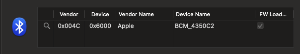

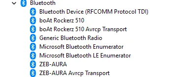

Tehzeeb Zaryoun Posted January 30 Share Posted January 30 I have successfully installed macOS Sequoia 15.7.3 in my computer (AMD Ryzen 5600G with only internal graphics & no graphics card, Gigabyte B450M DS3H V2 motherboard) but my bluetooth & wifi are not working. I'm not bothered by the wifi but bluetooth is important for me, my bluetooth adapter is a USB device, TP Link model: UB400. Does anybody know how to make this device work in my mackintosh ? I also have a dual boot setup with Windows 11, the bluetooth device info is something like below in my Windows 11 Here are images from the macOS (Sequoia) Quote Link to comment https://www.insanelymac.com/forum/topic/362277-tp-link-usb-bluetooth-device-not-working-in-my-hackintosh/ Share on other sites More sharing options...
Slice Posted February 15 Share Posted February 15 macOS said BCM_4350C2 even if no bluetooth present at all. Quote Link to comment https://www.insanelymac.com/forum/topic/362277-tp-link-usb-bluetooth-device-not-working-in-my-hackintosh/#findComment-2847419 Share on other sites More sharing options...
