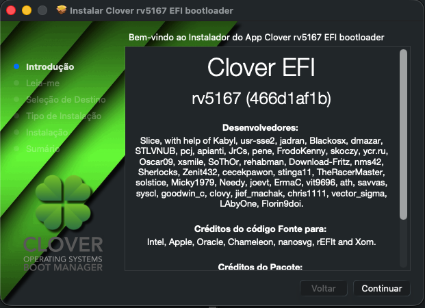

Hnanoto Posted January 12 Share Posted January 12 The Giant Awakes! Clover Bootloader Updated for macOS Sequoia/Tahoe (GCC 15 Ready) 🍀🚀 Hey everyone, hnanoto here! I have some exciting news about our good old Clover Bootloader. Tired of seeing the project lagging behind in compatibility, I decided to roll up my sleeves and perform a heavy "under the hood" update. We've essentially transformed Clover into a beast (in the best way possible!), ready to stand toe-to-toe with any modern bootloader. Key Recent Improvements (by @Hnanoto): Recovery DMG Booting (ALREADY MERGED!): Clover is now capable of booting natively from a recovery BaseSystem.dmg file. Installations and recoveries are now much easier and more robust. Updated OpenCore Engine (New PR #782): I've bumped the internal OpenCorePkg submodule to the latest version. Clover now speaks macOS 15 (Sequoia) and macOS 26 (Tahoe) natively. Essential New Quirks (Sequoia/Tahoe): DisableIoMapperMapping : Goodbye Sequoia WiFi/Ethernet issues! VT-d support is now properly handled. ResizeGpuBars : Control Resizable BAR (Smart Access Memory) directly in the bootloader. No more disabling it in BIOS and losing Windows performance. Modern Compilation (GCC 15): Major cleanup of C++ code to support modern compilers (GCC 15+). Clean, lean code with no build errors. Bottom Line: Clover is alive, up-to-date, and future-proof. For those who love the classic GUI and on-the-fly editing, you now have the latest OpenCore V8 engine running underneath, plus exclusive DMG booting features. Cheers and happy Hackintoshing! — @Hnanoto 2 4 Link to comment https://www.insanelymac.com/forum/topic/362206-the-giant-awakes-%F0%9F%8D%80/ Share on other sites More sharing options...

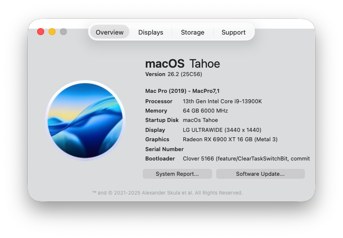

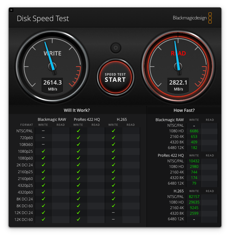

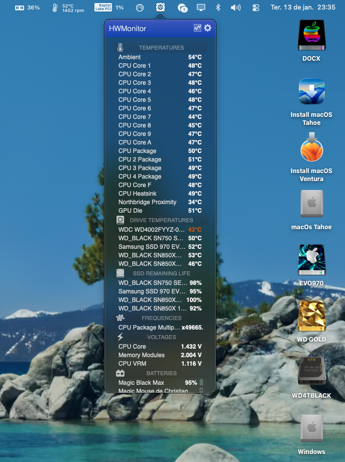

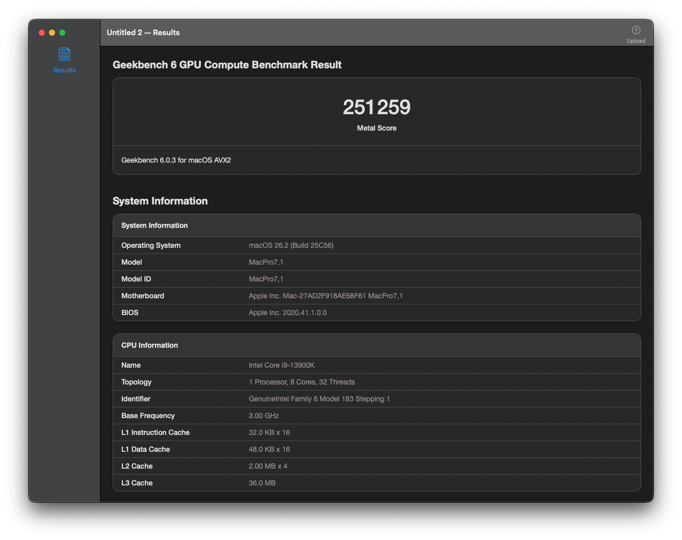

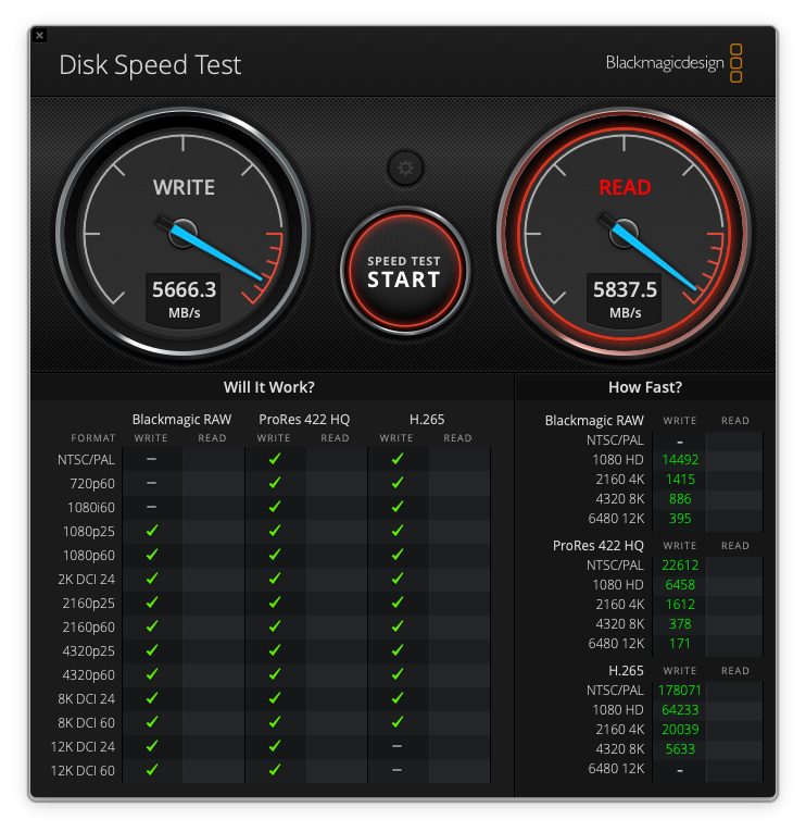

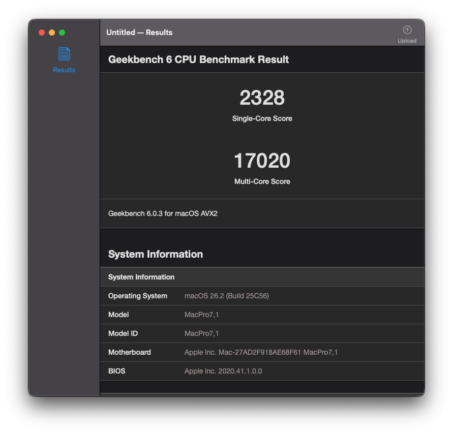

Max.1974 Posted January 14 Share Posted January 14 (edited) Raptor Lake i9-13900K Hello everyone, I am very impressed with the new Clover 5167 commit, still in the testing phase, and I can assure you that the speed and smoothness are so much better that, to fully enjoy all the advantages of the embedded and updated OpenCore—and with the code cleaned up and redesigned—I tried a clean installation and felt a huge difference. It is really flying, and I am not advertising. The NVMe even dropped in temperature, and I am noticing many improvements, especially a much more responsive Safari. But I did a new installation because the changes are truly modern and up to date. So here is the advice for the future: avoid putting new wine into old wineskins—do a fresh installation. Thanks to @Hnanoto @Slice @chris1111 and all developers. Edited January 14 by Max.1974 2 Link to comment https://www.insanelymac.com/forum/topic/362206-the-giant-awakes-%F0%9F%8D%80/#findComment-2846385 Share on other sites More sharing options...

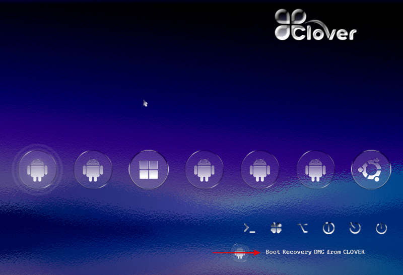

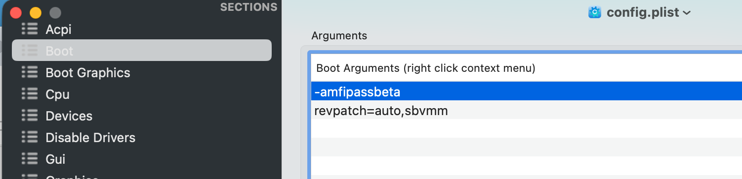

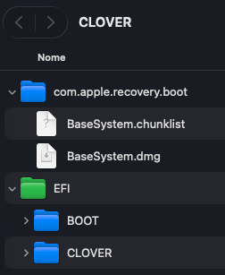

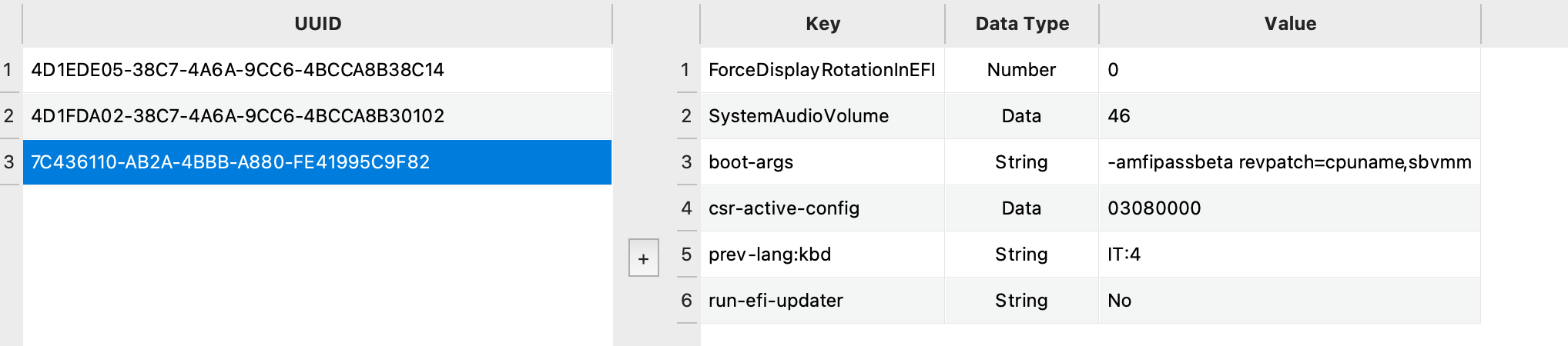

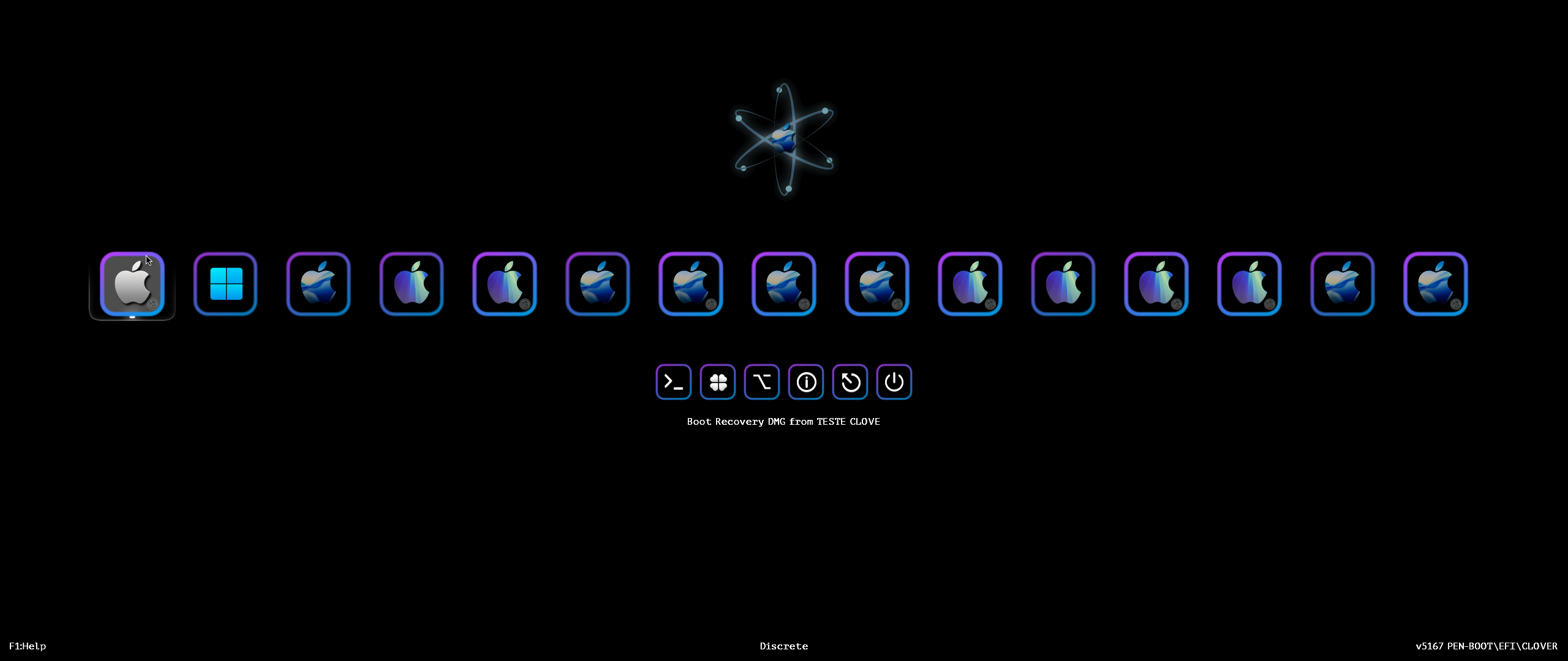

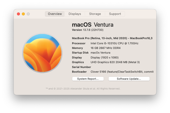

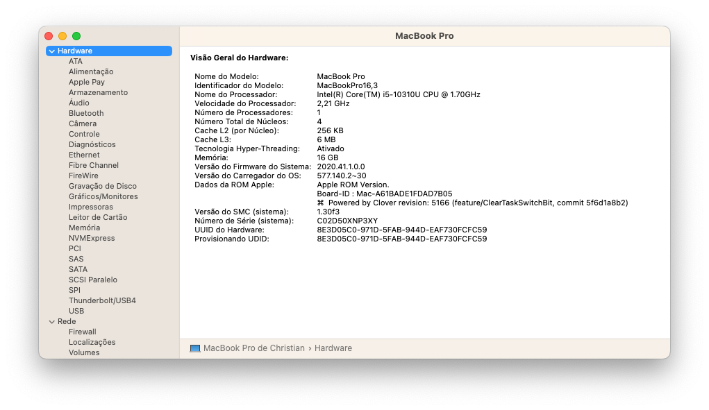

Anto65 Posted January 14 Share Posted January 14 Hi, What about the Recovery DMG ( com.apple.recovery.boot ) ? Can you or anyone else boot it? This doesn't work here despite being visible on boot . Try different builds, it doesn't boot . Tahoe, Sequoia, Sonoma... boot s fine without any problems. Waiting for your new Merge/Master... in progress. What name should the icon ( Recovery DMG ) in the theme have... os_recovery, os_dmg...? Thanks for your attention. Link to comment https://www.insanelymac.com/forum/topic/362206-the-giant-awakes-%F0%9F%8D%80/#findComment-2846417 Share on other sites More sharing options...
Hnanoto Posted January 14 Author Share Posted January 14 22 minutes ago, Anto65 said: Hi, What about the Recovery DMG ( com.apple.recovery.boot ) ? Can you or anyone else boot it? This doesn't work here despite being visible on boot . Try different builds, it doesn't boot . Tahoe, Sequoia, Sonoma... boot s fine without any problems. Waiting for your new Merge/Master... in progress. What name should the icon ( Recovery DMG ) in the theme have... os_recovery, os_dmg...? Thanks for your attention. The PR has already been accepted by Slice, so in recovery mode the method will appear as shown in the image! The name would be Boot Recovery DMG! To use the method, leave your kexts in the Other folder in kexts because Clover hasn't yet unpacked the DMG that will be installed directly from the Apple server, so Clover doesn't know the macOS version that's in the DMG, okay? 1 Link to comment https://www.insanelymac.com/forum/topic/362206-the-giant-awakes-%F0%9F%8D%80/#findComment-2846420 Share on other sites More sharing options...
Anto65 Posted January 14 Share Posted January 14 (edited) I've always used the "Other" folder for kexts. The Recovery DMG is visible fine ... but it crashes after a while after launching it. Tried with the Tahoe and Ventura BaseSystem, without success. It doesn't reach here... maybe I'm explaining myself badly Spoiler Edited January 14 by Anto65 1 Link to comment https://www.insanelymac.com/forum/topic/362206-the-giant-awakes-%F0%9F%8D%80/#findComment-2846425 Share on other sites More sharing options...
Hnanoto Posted January 14 Author Share Posted January 14 3 hours ago, Anto65 said: Sempre usei a pasta "Other" para kexts. O DMG de Recuperação é visível de forma adequada ... Mas ele trava depois de um tempo após o lançamento. Tentei com o Tahoe e Ventura BaseSystem, sem sucesso. Não chega aqui... talvez eu esteja me explicando mal Esconder conteúdo Do you have the logs? 1 Link to comment https://www.insanelymac.com/forum/topic/362206-the-giant-awakes-%F0%9F%8D%80/#findComment-2846438 Share on other sites More sharing options...
Hnanoto Posted January 14 Author Share Posted January 14 15 hours ago, fabiosun said: Hi Hnanoto Thanks for your job in clover Could you explain this part i quoted? I use 5165 release with a AMD CPU 9950x and X870E platform/chipset I have a perfect working system with this Clover Release Which improvments i can have if i update with your latest AMD Zen 5 support? thank you in advance "Hi there! glad to hear your system is stable. Even if your 9950x (Zen 5) is booting fine with r5165, here is why this update matters for you: Native CPU Recognition: The previous Clover versions didn't have the specific CPU definitions for the AMD 1Ah Family (Zen 5). This update adds full native support in the underlying code (OpenCorePkg backend). This means better power management detection and correct topology reporting to macOS, rather than relying on generic fallback codepaths. ClearTaskSwitchBit Quirk: This is the major fix. On many newer Ryzen platforms, virtualization (running VMs like Parallels/VMware) or certain heavy workloads could cause instability or crashes due to how the CR0 register states are handled during the boot handover. This quirk fixes that at a low level, ensuring rock-solid stability specifically for virtualization and newer instruction sets. Modernized Engine: We synced the internal OpenCore engine to the absolute latest commit. This brings in silent fixes for newer chipsets (like your X870E) regarding memory mapping and PCIe handling that might not be visible 'on the surface' but prevent edge-case panics in the future. In short: It makes your "perfect working system" more "natively correct" under the hood and safer for virtualization tasks." 3 Link to comment https://www.insanelymac.com/forum/topic/362206-the-giant-awakes-%F0%9F%8D%80/#findComment-2846440 Share on other sites More sharing options...
Anto65 Posted January 14 Share Posted January 14 1 hour ago, Hnanoto said: Do you have the logs? Write to me Maybe in bigger letters... I can't read 3 Link to comment https://www.insanelymac.com/forum/topic/362206-the-giant-awakes-%F0%9F%8D%80/#findComment-2846442 Share on other sites More sharing options...
