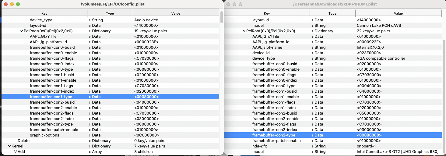

cass Posted December 30, 2025 Share Posted December 30, 2025 Hello everyone, I have an HP 800 G4 DM (i5-8500, UHD 630) running macOS Sequoia 15.7.3. This issue started occurring after I switched to a new monitor. My previous monitor also used a DP-to-DP connection and worked perfectly. I am using deeveedee latest oc1.0.6-efi-r01.zip. Currently, when connected via DP, the screen experiences random black screens and flickering. If I use HDMI, the monitor fails to wake after sleep. How should I patch my files to fix the DP connection? Quote Link to comment https://www.insanelymac.com/forum/topic/362158-hp-800-g4-dm-uhd-630-dp-connection-black-screen-and-flickering-issue/ Share on other sites More sharing options...
Asural Posted January 14 Share Posted January 14 (edited) On 12/31/2025 at 8:23 AM, cass said: Hello everyone, I have an HP 800 G4 DM (i5-8500, UHD 630) running macOS Sequoia 15.7.3. This issue started occurring after I switched to a new monitor. My previous monitor also used a DP-to-DP connection and worked perfectly. I am using deeveedee latest oc1.0.6-efi-r01.zip. Currently, when connected via DP, the screen experiences random black screens and flickering. If I use HDMI, the monitor fails to wake after sleep. How should I patch my files to fix the DP connection? First, use @deeveedee's settings as is, and then: 1. Add force-online = <01000000> 2. Add igfxfw = <02000000> For DP to DP, try setting framebuffer-con0-busid = <05000000> to check if it works. As for DP to DP, I think you're using a high-performance monitor, but replacing the DP cable with a DP2.0 cable should fix the problem. There should be a guide on the forums, but please refer to this guide. EDIT: I find it difficult to judge @deeveedee's recipe. Fortunately, she has provided an explanation herself, so please ask questions, including details about the monitor you are using. Edited January 15 by Asural Quote Link to comment https://www.insanelymac.com/forum/topic/362158-hp-800-g4-dm-uhd-630-dp-connection-black-screen-and-flickering-issue/#findComment-2846395 Share on other sites More sharing options...

deeveedee Posted January 14 Share Posted January 14 (edited) @cass If those suggestions don't fix your issues, please re-read the instructions. The DeviceProperties that I provide in oc1.0.6-efi-r01.zip are specifically for my hack which uses 3 DP->DVI-D adapters (my 3 displays are Dell displays with DVI-D inputs). If you are using DP->DP (no adapters) the instructions indicate that you may need to change your graphics DeviceProperties. The instructions have links to sample DeviceProperties that may work better for you. EDIT: @Asural oc1.0.6-efi-r01.zip specifies boot-args igfxfw=2 and igfxonln=1 instead of the DeviceProperties. EDIT2: @cass With regard to sleep/wake, see this. You may need to remove boot-arg darkwake=2. Edited January 14 by deeveedee 1 1 Quote Link to comment https://www.insanelymac.com/forum/topic/362158-hp-800-g4-dm-uhd-630-dp-connection-black-screen-and-flickering-issue/#findComment-2846405 Share on other sites More sharing options...
