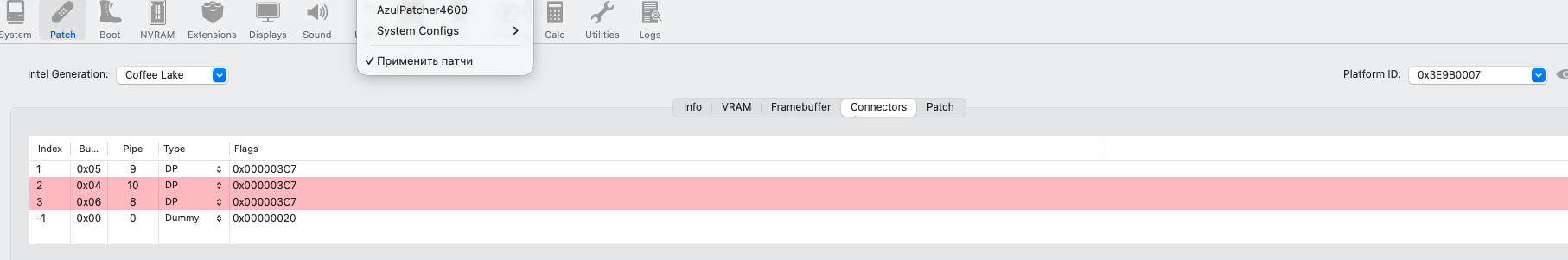

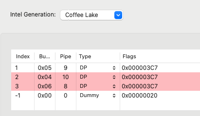

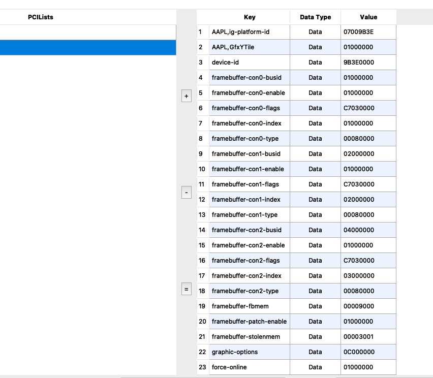

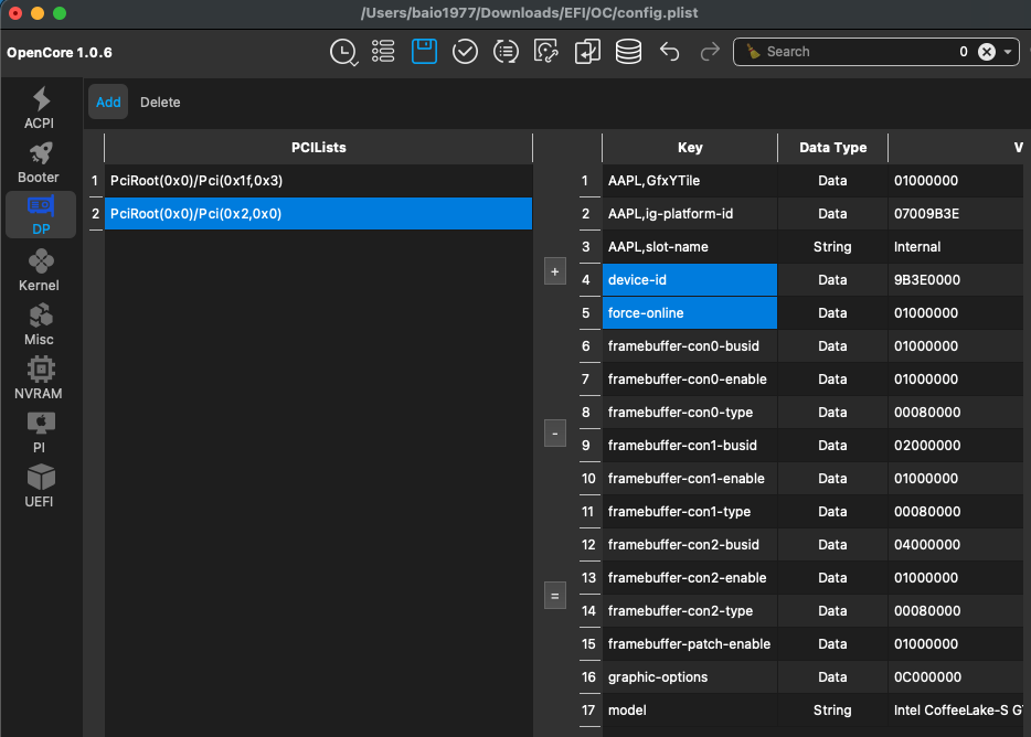

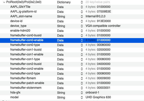

I analyzed the attached EFI, and I think it's more correct to use desktop id since the flags and index have the same values in the patch. I'm attaching a screenshot of the patch for you to test. If you try this patch, try logging in.
To use AAPL,ig-platform-id Desktop you need to add the spoof device-id.
As you can see below, this way you avoid adding unnecessary patches. Force Online might fix random black screens on startup.

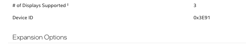

I3 9100 https://www.intel.com/content/www/us/en/products/sku/134870/intel-core-i39100-processor-6m-cache-up-to-4-20-ghz/specifications.html

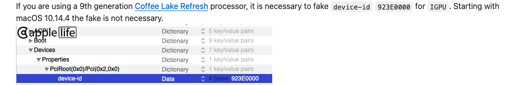

@Baio77 Your suggestion may work.  Acidanthera says here that CPUs with device-id 0x3e91 should be "spoofed" as device-id 0x3e92.  See my post here where I recommended that brumas2025 try device-id 0x3e92.  device-id 0x3e92 is a Desktop ID (same as i5-9600).
brumas2025 tested framebuffer platform-id 0x3e9b0007.   it worked for him after we modified the busIDs.  See here.  It appears that once the busIDs are properly patched, both mobile and desktop framebuffers can be used.  Note that he started this thread with framebuffer platform ID 0x3e9b0007 when only a single display was working.  That's why we tried other framebuffer Platform IDs.  Now that we have more test results, it appears that as long as the busIDs are patched, he can use mobile and desktop framebuffers.  See his test results here.

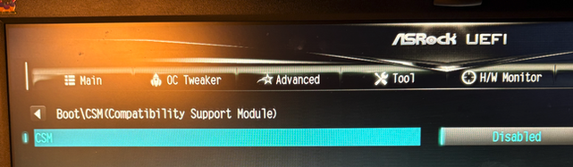

@brumas2025 In your BIOS, do you have an option for "Fast Boot" or something similar?  If so, please make sure that this setting is "Disabled" in BIOS.
I removed the arguments as you advised, but nothing has changed...

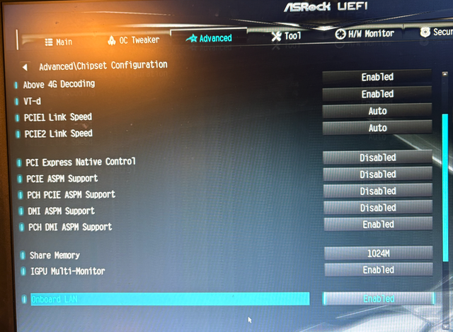

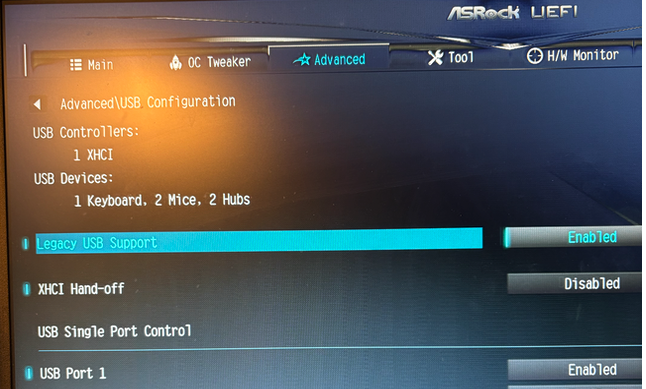

Regarding BIOS
LegasyUSBSaport = Disable
XHCI Hand-off = Enable
PCI Expless Nateve Controll = Enable
The following are power saving settings, so I think it's fine to disable them.
PCIE APSM Suport
PCH PCIE APSM Suport
DMI APSM Suport
 PCH DMI APSM Suport

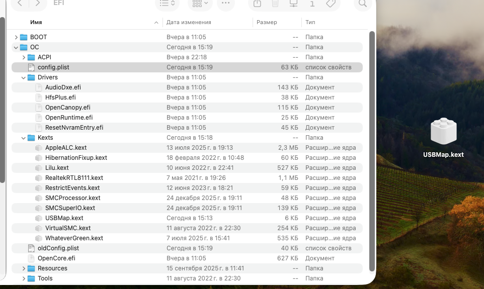

I think the kext requires USBMap.kext, so I'm writing down how to create it.
@brumas2025. (It won't @ convert...)
Download USBMap-tahoe-test.zip and create USBMap.kext for Tahoe.
Creating the Original USBMap.kext
1. Launch Terminal and drag and drop USBMap.command into the terminal to execute it.
2. Select D. Discover Ports to begin selecting the USB port to use.
3. Insert a USB device (a mouse or gamepad will do) into the USB port you want to use on the H310. The port will become enabled and change color.
4. When the screen refreshes, the next USB will become discoverable, so continue to detect all USB devices.
5. When all are complete, exit the detection screen with Q.
6. Return to the menu screen; select the Edit & Create USBMap.kext menu with P.
7. Select A. Select All, then select K. Build USBMap.kext. USBMap.kext will be created in the Results folder.
8. Exit all menus with Q to exit USBMap.command.
The created USBMap.kext is for Sequioa only, so it needs to be converted for Thaoe.
Creating USBMap.kext for Tahoe
1. Drag and drop USBMapInjectorEdit.command into Terminal to execute it.
2. When prompted, drag and drop USBMap.kext into Terminal to execute it.
3. The menu screen will change, so select S to execute it.
4. The menu screen will change, so select C to execute it.
5. Creation is complete at this point, so select Q for all commands to exit USBMapInjectorEdit.command.
Add the created USBMap.kext to EFI, enable it in config.plist and check USB operation.

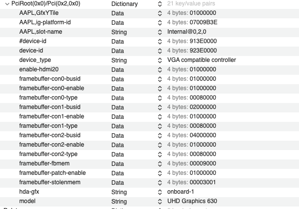

I think @Baio77 and @deeveedee would like to test with device-id = <923E0000> and <913E0000>.
Please modify the device-id in the attached PciRoot(0x0)/Pci(0x2,0x0) file and test it.

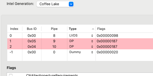

The HackinTool display seems suspicious because it doesn't reflect the settings...

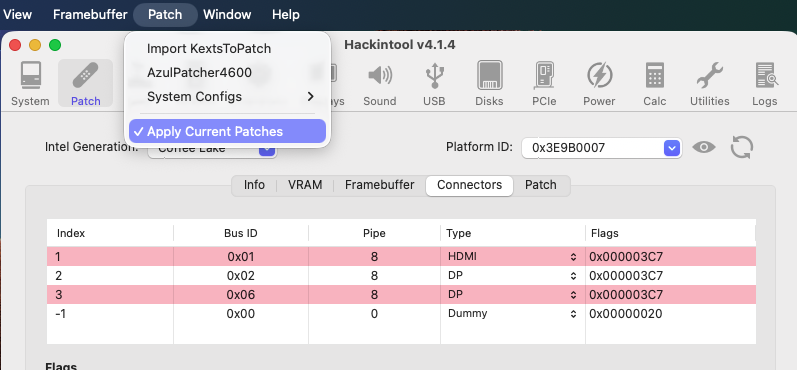

From the Patch menu bar, check Apply Current Patches, and click Goto Current in the Platform ID: drop-down menu before taking a screenshot.
ADD:
In my index3 display, BusID and pipe show 0x6 and 8 no matter what values I set.
I'll try to do this, but it doesn't apply to graphics...

4 hours ago, Asural said:
Regarding BIOS
I changed the settings in the BIOS, booted with the configuration you suggested, black bars, and after twitching the monitor's power supply, the image returned to normal.

@Baio77 and @deeveedee think that explicitly setting the device-id will "calibrate iGP using WEG."
In other words, this might work.

Please narrow the HackinTool window width to make the text larger.
7 minutes ago, Asural said:
I checked USBMap.kext and ioleg, and it seems that only USB 2.0 is enabled.
I'll try again later, but in its current state, I don't think it will be recognized even if connected via USB 3.0.

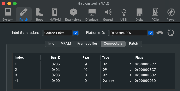

I tried with the configurations that hackintool created, but again the black bars that go away when I turn off the NDMI display.
Quote
2026-01-0416_20_02.png.2ad4c9b7a6f93e114314b8791cd92e6d.png2026-01-0416_20_29.png.ade605a9e0e5462914fcc8e5f9b50c7b.png
config006.plist 1.71 kB · 0 downloads iMac 040126-1.ioreg 4.83 MB · 0 downloads
In HackinTool's display, the BusID and Type are displayed differently for <923E0000> and <913E0000>.
Please attach the ioreg for <923E0000> and <913E0000>, clearly indicating which is which.
I think I'll get some feedback from @Baio77 and @deeveedee later, including my settings.
loaded from <913E0000> . the display has not changed...
And the previous pictures were when it was <923E0000>
Quote
2026-01-0416_39_37.png.a700c0ea1cd319bc56cfa63906fc8059.png2026-01-0416_52_26.png.a9a02300b08d1a7b1ca8e5b57f11b925.png
iMac 040126<913E0000> .ioreg
Edited by brumas2025
