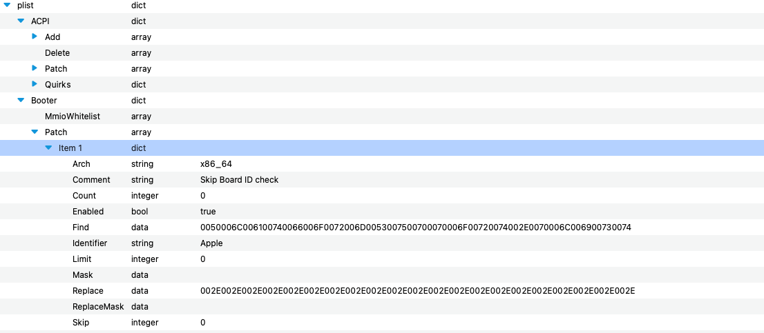

Max.1974 Posted January 13 Share Posted January 13 @brumas2025 you can add Booter Patch to disable filevault Check my tutorial: 1 Quote Link to comment https://www.insanelymac.com/forum/topic/362102-asrock-h310m-hdv-dual-monitor-problems/page/12/#findComment-2846365 Share on other sites More sharing options...

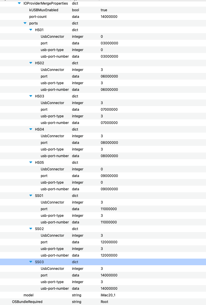

brumas2025 Posted January 13 Author Share Posted January 13 (edited) 1 hour ago, Max.1974 said: And @brumas2025 save this config.plist, then I will look at your EFI under seven locks (or seven hard drives) lol 😆 And does your USB mapping kext not contain any internal 255 device (Bluetooth or some other internal device)? Don’t you have any PCIe USB card connected to the motherboard? I had an Atheros WiFi card for a long time, which remained after being replaced with a mac-compatible Brodcom card in an Asus 756 laptop, I bought an adapter and use the card in Windows, but of course it doesn't work in hickintosh, probably it is determined. ( I'll replace it with Wi-Fi BCM94360CS2 + NGFF M soon.2 Key A/E WIFI BT 4.0 802.11Ac for 11 inch A1465 13 inch A1466). Quote Edited January 13 by brumas2025 1 Quote Link to comment https://www.insanelymac.com/forum/topic/362102-asrock-h310m-hdv-dual-monitor-problems/page/12/#findComment-2846368 Share on other sites More sharing options...
brumas2025 Posted January 13 Author Share Posted January 13 42 minutes ago, Max.1974 said: @brumas2025 you can add Booter Patch to disable filevault thank you! I added it! Very interesting 1 Quote Link to comment https://www.insanelymac.com/forum/topic/362102-asrock-h310m-hdv-dual-monitor-problems/page/12/#findComment-2846370 Share on other sites More sharing options...
