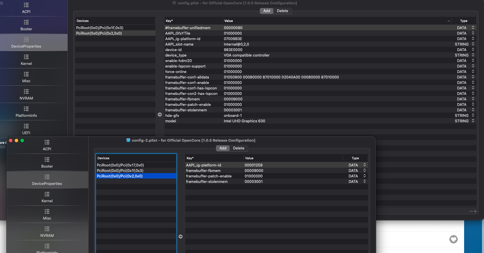

Leo Mauti Posted November 9, 2025 Share Posted November 9, 2025 Hi, unfortunately I stumbled upon the installation, and I'm stuck on a black screen, with mouse here is my config. config.plist Link to comment https://www.insanelymac.com/forum/topic/361936-black-screen-with-dell-3050-mouse/ Share on other sites More sharing options...
feartech Posted November 9, 2025 Share Posted November 9, 2025 13 minutes ago, Leo Mauti said: Hi, unfortunately I stumbled upon the installation, and I'm stuck on a black screen, with mouse here is my config. config.plist 60.94 kB · 0 downloads you have the renames in place but not the HPET.aml? also remove -igfxvesa if your graphics are setup correct in PciRoot(0x0)/Pci(0x2,0x0) Link to comment https://www.insanelymac.com/forum/topic/361936-black-screen-with-dell-3050-mouse/#findComment-2843443 Share on other sites More sharing options...
Leo Mauti Posted November 9, 2025 Author Share Posted November 9, 2025 Nothing to do, black screen and mouse Link to comment https://www.insanelymac.com/forum/topic/361936-black-screen-with-dell-3050-mouse/#findComment-2843451 Share on other sites More sharing options...
carlo_67 Posted November 9, 2025 Share Posted November 9, 2025 cambia le device proprieties e togli il bootarg igfxvesa 8 ore fa, Leo Mauti ha detto: Niente da fare, schermo nero e mouse Hai messo usbmap aggiornato per Tahoe? Link to comment https://www.insanelymac.com/forum/topic/361936-black-screen-with-dell-3050-mouse/#findComment-2843458 Share on other sites More sharing options...
Leo Mauti Posted November 10, 2025 Author Share Posted November 10, 2025 (edited) Everything seems ok, thanks I posted my efi Using Oclp-mod, for audio and more There are some extra kexts but I need them, whoever wants can delete the superfluous ones EFI Dell 3050 Tahoe 1.0.0.zip Update the map USB: https://drive.google.com/file/d/1fQh0G3MOHe1_6NHvLmqgLOu95ZSD8wr_/view Edited November 11, 2025 by Leo Mauti If everyone posted their EFIs for download the forum would be full Link to comment https://www.insanelymac.com/forum/topic/361936-black-screen-with-dell-3050-mouse/#findComment-2843462 Share on other sites More sharing options...
