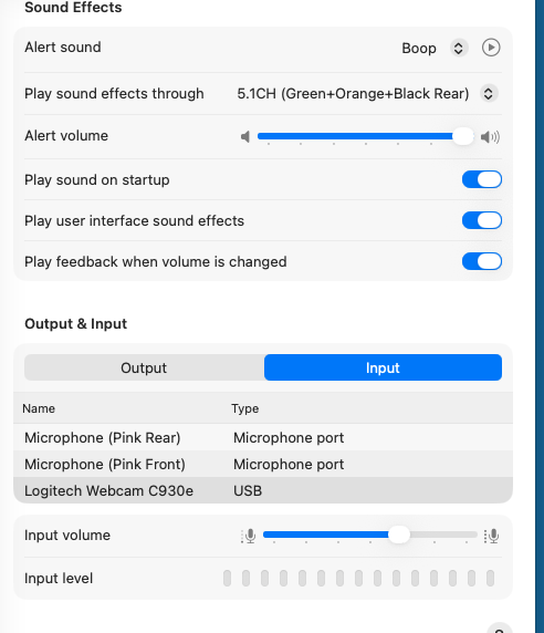

Ok looks like I just had an outdated appleALC
sound if now workign via woodoo
-Mac-Pro ~ % nvram -p | grep csr
csr-active-config	%ff%0f
Mac-Pro ~ % kextstat | grep -i voodoo
Executing: /usr/bin/kmutil showloaded
No variant specified, falling back to release
  145    0 0xffffff7f9672e000 0x22ffb    0x22ffb    org.voodoo.driver.VoodooHDA (3.0.2) D152AD58-8A44-3477-8171-D19BD6C5AB8E <141 19 9 7 6 3>
thanks for the help!
Edited by fgxr8
@fgxr8 Great! Better for macOS updates if you don't completely disable SIP. Your original csr-active-config was better.
You're welcome.
EDIT: @fgxr8 The old AppleALC.kext version is probably why patching AppleHDA didn't work for you. Also, now that you've installed VoodooHDA, you can tighten SIP by setting csr-active-config = <01000000>. You only need csr-active-config = <03080000> to install VoodooHDA.kext to /Library/Extensions, not after it is installed.
