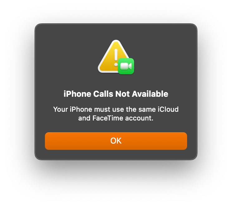

chris1111 Posted March 21 Share Posted March 21 @arsradu I have a message issue for 1 monts, trying all the trick without success, calling Apple even Apple can not fix the problem, only my iphonne can be use. then it fix by imself magically when I receive a pop up on my Iphone this mac can use message. 1 Link to comment https://www.insanelymac.com/forum/topic/361701-problem-with-imessage-and-face-time-in-tahoe/page/2/#findComment-2848295 Share on other sites More sharing options...
arsradu Posted March 21 Share Posted March 21 (edited) On 3/21/2026 at 4:54 PM, chris1111 said: @arsradu I have a message issue for 1 monts, trying all the trick without success, calling Apple even Apple can not fix the problem, only my iphonne can be use. then it fix by imself magically when I receive a pop up on my Iphone this mac can use message. This is so weird... :)) Were you logged into iCloud already when that happened? Were you on Tahoe or something older? If I'm trying to sign into Facetime and make a call (before exiting, which forces me to sign in again) it says this: Obviously BOTH the iPhone and the Mac are in fact already using the same account. So this is another error that makes no sense to me. Update: I went back to Ventura, tried to log in, same exact issue. At this point it doesn't look like a problem with the OS, but something on the account or something... Update 2: changing the password didn't make a difference to me. Neither for FaceTime, nor iMessage. Edited March 22 by arsradu 1 Link to comment https://www.insanelymac.com/forum/topic/361701-problem-with-imessage-and-face-time-in-tahoe/page/2/#findComment-2848297 Share on other sites More sharing options...
arsradu Posted March 25 Share Posted March 25 (edited) Looks like there are quite a lot more people with the same issue. And it’s not OS related. It’s device related. I found this thread on reddit: so…yeah, I think in preparation for intel removal, only legit Macs are allowed to log into imessage and Facetime. I even tried on another hack which was working fine a while ago, and got the exact same behaviour. Automatically closing, and asking to login again. Facetime actually stays on. But if you close it and open it again, it asks to login again. So clearly it’s not actually working. Well, if someone can find a fix so I can retire my hack fully working, that would be really nice. If not, well it’s been super cool and super fun and I’ve learned a lot of new and interesting things..while it lasted. I’m still grateful for everything. Edited March 25 by arsradu Link to comment https://www.insanelymac.com/forum/topic/361701-problem-with-imessage-and-face-time-in-tahoe/page/2/#findComment-2848453 Share on other sites More sharing options...

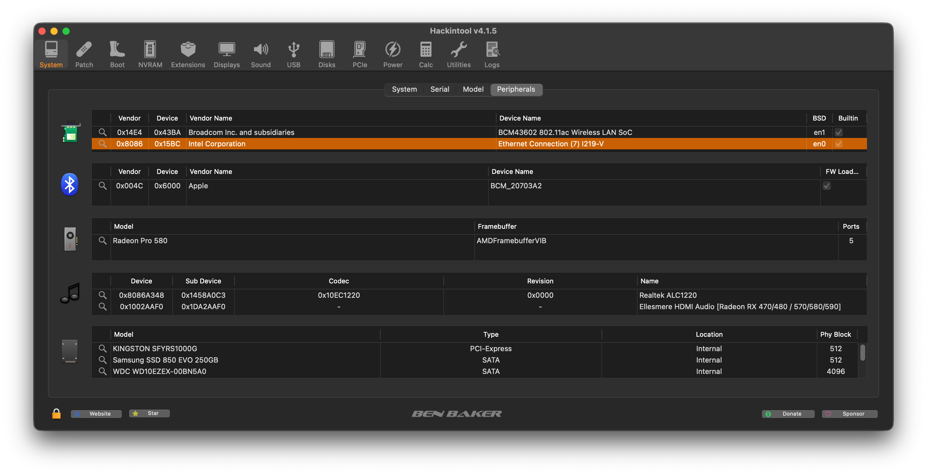

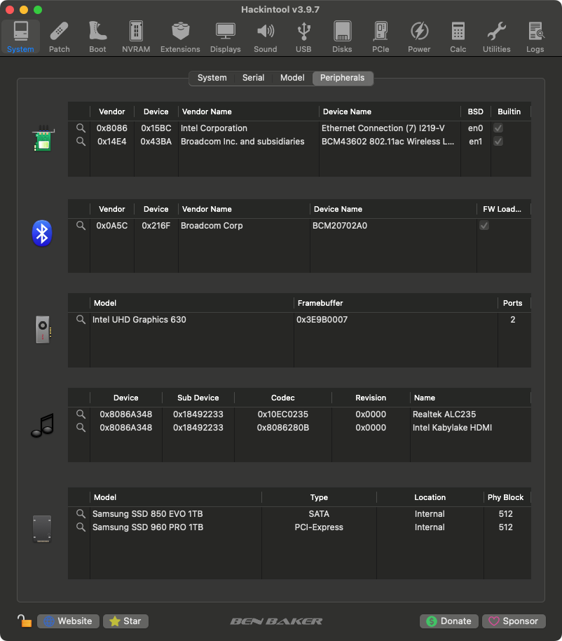

arsradu Posted March 26 Share Posted March 26 (edited) Hey guys, Just wondering, is the order of the network interfaces here important? Looks like it's sometimes en0 on top, en1 on the bottom, but mine seems to be en1 on top, en0 on the bottom. If that makes a difference, how do I set them to be the other way around? Edited March 26 by arsradu Link to comment https://www.insanelymac.com/forum/topic/361701-problem-with-imessage-and-face-time-in-tahoe/page/2/#findComment-2848479 Share on other sites More sharing options...
jlrycm Posted March 26 Share Posted March 26 (edited) If I recall well, the Dortania OpenCore specifically addresses this question clarifying that en0 should be the network present to have iMessage up and running. I read somewhere else that sometimes the en0 versus en1 assignment to each network can create issues too, and I recall fixing some of that in the past when I had issues with iMessage many years ago. en0 has to be also marked at built-in. Edited March 26 by jlrycm 1 Link to comment https://www.insanelymac.com/forum/topic/361701-problem-with-imessage-and-face-time-in-tahoe/page/2/#findComment-2848480 Share on other sites More sharing options...
jlrycm Posted March 26 Share Posted March 26 (edited) https://dortania.github.io/OpenCore-Post-Install/universal/iservices.html Edited March 26 by jlrycm 3 Link to comment https://www.insanelymac.com/forum/topic/361701-problem-with-imessage-and-face-time-in-tahoe/page/2/#findComment-2848481 Share on other sites More sharing options...
arsradu Posted March 27 Share Posted March 27 9 hours ago, jlrycm said: https://dortania.github.io/OpenCore-Post-Install/universal/iservices.html Hello! Thank you very much for this! I went though it, and… while the guide provides useful information, it does not say anything about the order of those interfaces in Hackintool. Moreover, as far as I can see, the guide itself lists en1 as first option. So…I’m guessing the order is probably not that important. But we need to have en0 and set as built-in. Which mine is anyway. Ok.. then it might be something else. 1 Link to comment https://www.insanelymac.com/forum/topic/361701-problem-with-imessage-and-face-time-in-tahoe/page/2/#findComment-2848491 Share on other sites More sharing options...

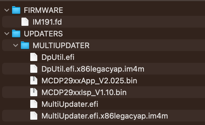

vrondena Posted April 6 Share Posted April 6 (edited) Hi, I had the same problems not being able to use the services. All the tests done with serials, new Apple IDs, restoration of old firmware that previously worked with iMessage and FaceTime, tutorials etc. etc. They didn't work. I thought Apple ID with original Mac works, in the previous hack configurations worked (high sierra, Monterrey, Ventura, Sonoma and also Sequoia...) with Tahoe never succeeded until I realised that in the EFI folder the Apple subfolder was missing and Nvram you could only see OC and Boot. I tried to put these folders from old EFIs where the services worked in the EFIs of Tahoe and ...... Magic .... iMessage and FaceTime work, I had already reported it in the forum at the top part. you just have to try Sorry but the translation doesn't work for me, you do it Edited April 6 by vrondena non è stato tradotto ha tenuto il testo con lingua originale 3 Link to comment https://www.insanelymac.com/forum/topic/361701-problem-with-imessage-and-face-time-in-tahoe/page/2/#findComment-2848785 Share on other sites More sharing options...
arsradu Posted April 6 Share Posted April 6 (edited) 3 hours ago, vrondena said: Hi, I had the same problems not being able to use the services. All the tests done with serials, new Apple IDs, restoration of old firmware that previously worked with iMessage and FaceTime, tutorials etc. etc. They didn't work. I thought Apple ID with original Mac works, in the previous hack configurations worked (high sierra, Monterrey, Ventura, Sonoma and also Sequoia...) with Tahoe never succeeded until I realised that in the EFI folder the Apple subfolder was missing and Nvram you could only see OC and Boot. I tried to put these folders from old EFIs where the services worked in the EFIs of Tahoe and ...... Magic .... iMessage and FaceTime work, I had already reported it in the forum at the top part. you just have to try Sorry but the translation doesn't work for me, you do it I have such folder. It contains 2 subfolders. A FIRMWARE one and an UPDATERS one. Something like this. Is it the same for you? I thought that folder is meaningless for hacks and only useful for real Macs. Now I'm confused... Also, I'm wondering if your ROM is comprised of your actual MAC address (Ethernet maybe?) or something else? And if it gets malformed when it gets to nvram. For example, if you check it with"nvram 4D1EDE05-38C7-4A6A-9CC6-4BCCA8B38C14:ROM" do you get back something that looks like what you entered as your ROM? Cause it looks weird in my case. Aside from the % separator I get something like this: %8c-%aaA%e9%b5. Which doesn't look right to me... So if all of my ROM attempts are getting malformed like this, no wonder it doesn't work. I don't even know where would this come from. It slightly resembles what I added but I don't think it is supposed to be like this. Is there another way to check that what I entered is actually interpreted ok in NVRAM? Also, I'm using SSDT-PMC.aml for my Z390 Aorus Pro motherboard. Is it still needed....? Can it affect this functionality in some way? Edited April 6 by arsradu Link to comment https://www.insanelymac.com/forum/topic/361701-problem-with-imessage-and-face-time-in-tahoe/page/2/#findComment-2848788 Share on other sites More sharing options...
miliuco Posted April 6 Share Posted April 6 @arsradu I always supposed that the APPLE folder in EFI does nothing in a Hackintosh. This APPLE folder is created every time you install or update macOS. It does nothing if the hardware is not a real Mac. In fact, I delete them from time to time (when I look at the EFI). 1 Link to comment https://www.insanelymac.com/forum/topic/361701-problem-with-imessage-and-face-time-in-tahoe/page/2/#findComment-2848789 Share on other sites More sharing options...
arsradu Posted April 6 Share Posted April 6 8 minutes ago, miliuco said: @arsradu I always supposed that the APPLE folder in EFI does nothing in a Hackintosh. This APPLE folder is created every time you install or update macOS. It does nothing if the hardware is not a real Mac. In fact, I delete them from time to time (when I look at the EFI). Me too. Now I’m confused… :)) What about rom? What do you use? And does it look ok in nvram? Link to comment https://www.insanelymac.com/forum/topic/361701-problem-with-imessage-and-face-time-in-tahoe/page/2/#findComment-2848790 Share on other sites More sharing options...
